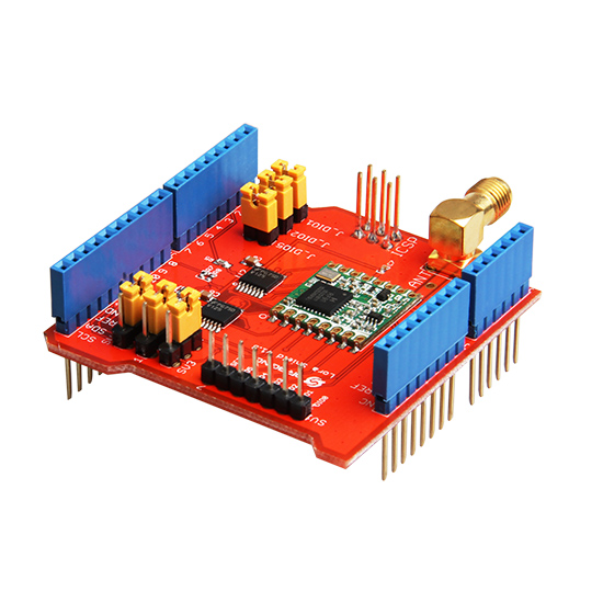

What is the Dragino Lora Shield
The Dragino Lora Shield is a long range transceiver on a Arduino shield form factor and based on Open source library.The Lora Shield allows the user to send data and reach extremely long ranges at low data-rates.It provides ultra-long range spread spectrum communication and high interference immunity whilst minimising current consumption.

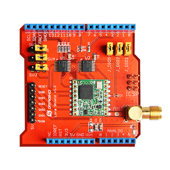

Hardware version info
Lora Shield v1.0: The first hardware release for the Lora Shield. Lora Shield v1.2: Connect the DIOs to Arduino IO. Change i-pex connector to SMA connector. Lora Shield v1.3: Remove 5v to 3.3v LDO, use 3.3 directly from Arduino +3.3v pin.

Lora Shield Schematic Frequent Ask Questions (FAQs)
I have order Lora Shield v95-868, while the chip on lora shield shows RF96? The Lora Shield v95-868 is equied with HopeRF RFM95W-868-S2. This module has a mark RF96 on it. it doesn't mean the chip is RFM96w, but it means the chip is using the SX1276 chip. Mean While, The Lora Shield v95-915 S2 with mark RF96 on the IC. The Lora Shield v98-433 S2 with mark RF98 on the IC and use the sx1278 chip.
