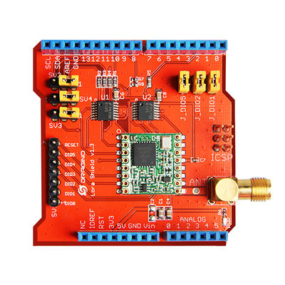

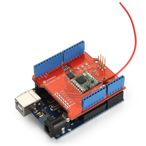

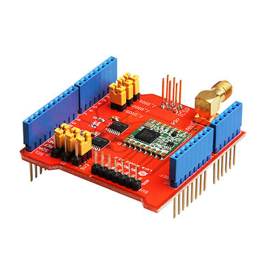

What is the Dragino Lora Shield
The Dragino Lora Shield is a long range transceiver on a Arduino shield form factor and based on Open source library.The Lora Shield allows the user to send data and reach extremely long ranges at low data-rates.It provides ultra-long range spread spectrum communication and high interference immunity whilst minimising current consumption.
The Lora Shield based on RFM95W/RFM98W targets professional wireless sensor network applications such as irrigation systems, smart metering, smart cities, smartphone detection, building automation, and so on.
Using Hope RF’s patented LoRaTM modulation technique the Lora Shield can achieve a sensitivity of over -148dBm using a low cost crystal and bill of materials. The high sensitivity combined with the integrated +20 dBm power amplifier yields industry leading link budget making it optimal for any application requiring range or robustness. LoRaTM also provides significant advantages in both blocking and selectivity over conventional modulation techniques, solving the traditional design compromise between range, interference immunity and energy consumption.
These devices also support high performance (G)FSK modes for systems including WMBus, IEEE802.15.4g. The Lora Shield deliver exceptional phase noise, selectivity, receiver linearity and IIP3 for significantly lower current consumption than competing devices.
Hardware version info
  • Lora Shield v1.0: The first hardware release for the Lora Shield.
  • Lora Shield v1.2: Connect the DIOs to Arduino IO. Change i-pex connector to SMA connector.
  • Lora Shield v1.3: Remove 5v to 3.3v LDO, use 3.3 directly from Arduino +3.3v pin.

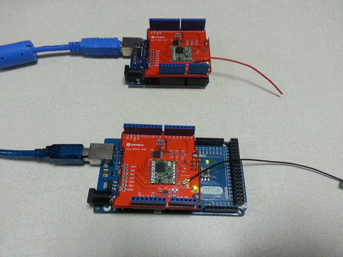

In this example,we use two Lora Shields to transmit and receive signal,there are some project in the RadioHead Library,the operation is as follows:

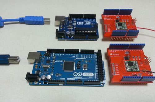

  • Connect two Lora Shields with Arduino board and connect them to computer via the USB cable;
We used the Lora Shield+Arduino UNO as the server to transmit signal and the Lora Shield+Aduino MEGA2560 as the client to receive signal here.
Connect the Lora Shield and Arduino,and connect them to computer.

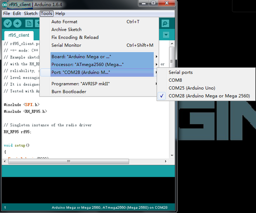

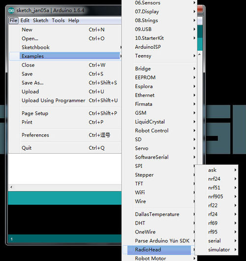

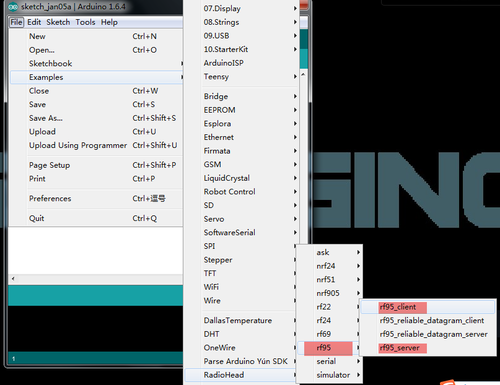

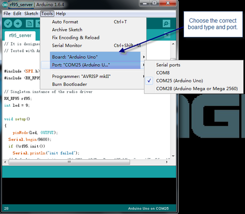

  • Open the IDE and choose the right example;
  • Configure the IDE settings and upload the two skteches to Aduino.

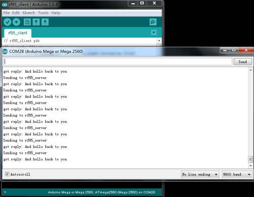

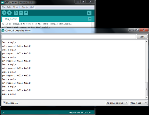

After configure the IDE settings,upload the skteche to Aduino.Check the Serial Moniter and we can view the running result of the two boards.
Running result of MEGA
Running result of UNO

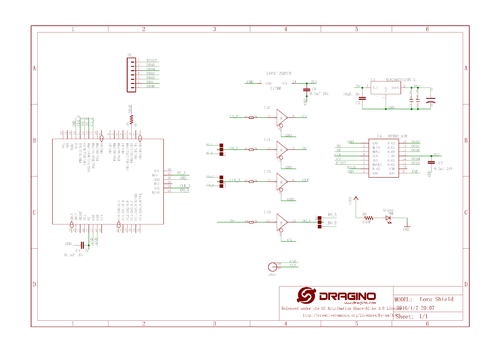

Schematic
Lora Shield Schematic
