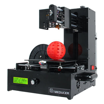

Me Ducer is the sixth gerneration of desktop 3D printer made by Geeetech, it is a portable cantilever type 3D printer with two handles, suitable for any place like home, office, lab, or classroom. To increase the stablity of cantilever type design, Me Ducer adopts 12mm-diameter superior hardness, wear resistance, oxidation resistance and carbon steel bearings for Y and Z axis, effectively avoiding vibrations during printing and making it more accurat for the positioning of Y and Z axis. In addition, we add a manually adjusting knob on the top of the machine which is used for the fine-tuning of Z axis.
As the companion piece of the Me Creator , Me Ducer continues with its overall look of solemnity and high-quality, but the high gloss piano black finished acrylic chasis adds even more panache and elegance to Me Ducer. Besides the consideration of art and aesthetics, 8mm industrial-strength acrylic chasis ensures incredible strength and durability.
Compared to its predecessors, the extruder of Me Ducer is no longer exposed barely, instead, we add a hood to cover the extruder which is crafted out of high-quality steel. So is the main control system, which is built in the base case. On one hand, it looks good and on the other hand, it offers a large degree of protection to the kids or pets from the high temprature of the extruder, creating a safer and more comfortable printing experience.

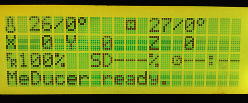

How to control on LCD
- 1)If you do not set the temperature of extruder and hot bed in g-code, you should manually heat up extruder and hotbed to proper temperature before printing.
- 2)If you do not set letting all the axes auto home in g-code, you should manually let all the axes auto home first.
- Press the button>"Print from SD">Choose the file you want to print and press button.
2.How to let all the axes auto home
- Press button on LCD> “Prepare”>“Auto home”

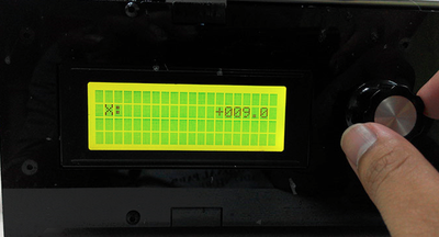

3.How to move the axis and extruder motor separately
- Press the button>”Prepare”>”Move axis”>”Move 10mm/1mm/0.1mm”>”Move X/Y/Z/extruder”
Note: The extruder motor can not move unless the temperature is more than 180 degrees.
4.What if you can not move the axis with you hand
Press the button>“Prepare”>”Disable steppers”
5.How to set the temperature of extruder
Press the button>“Control”>”Temperature”>”Nozzle”>Rotate the button>Press the button
6.How to set the temperature of hot bed
“Control”>”Temperature”>”Bed”>Rotate the button
