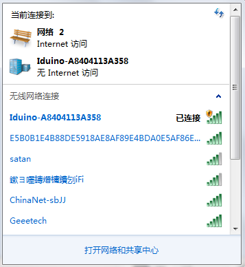

Power on Iduino Yun, after the system runs, it will generate a WiFi network with SSID : I duino-A84041XXXXXX.
Iduino Yun Generate an unsecure WiFi network
Use your PC to connect to this unsecure WiFi netowrk. Your PC will get DHCP from Yun. Your PC will get an IP 192.168.240.x and the Iduino Yun will have the IP 192.168.240.1

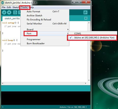

Open Arduino IDE and configure right Profile
Open Arduino IDE and choose the profile Tools --> Boards --> Arduino Yun. Choose the ports to "Iduino at 192.168.240.1"
Choose Yun profile

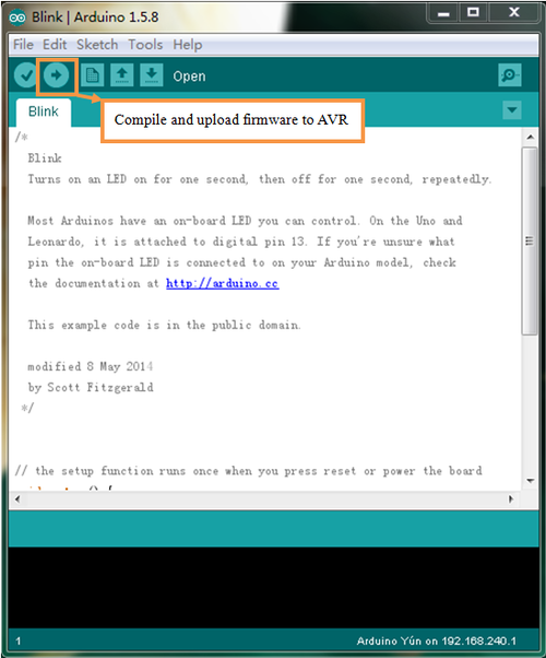

In Arduino IDE, Select example File-->Examples-->Bridge-->Bridge . Click Upload , Arduino IDE will compile this example and upload to Yun. During the upload, Arduino IDE will pop up a window for asking the password. type password iduino here. and continue upload.
upload sketch to Yun

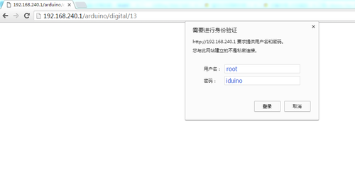

After upload, user can open the web broswer and use it to Read/Write the I/Os of Yun.
type password for Bridge sketch
Notice: Yun will ask for password at the first connect via Web. The user name is root and password is iduino.
