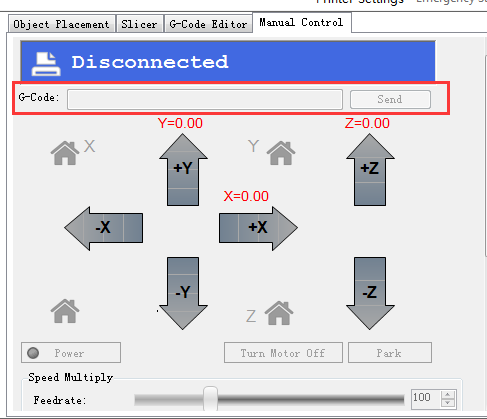

3) Open Repetier Host and Connect to your Rostock mini G2 and G2s!
Click on the Manual Controls Tab and click in a direction X or Y to test your connection. If you are having difficulty connecting, please review the following supportive documentation: Installing Drivers and How to connect.

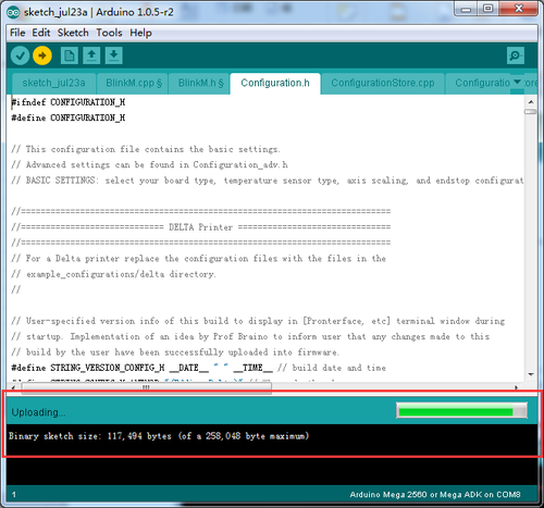

How to modify and upload firmware
In the following set-up process, you will need to modify and upload the firmware by yourself, so, first of all, let’s start with the firmware comliling and uploading.
1. Download the firmware here:
Firmware for Delta Rostock mini G2
Firmware for Delta Rostock mini G2S

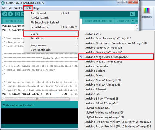

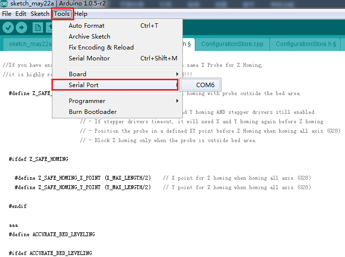

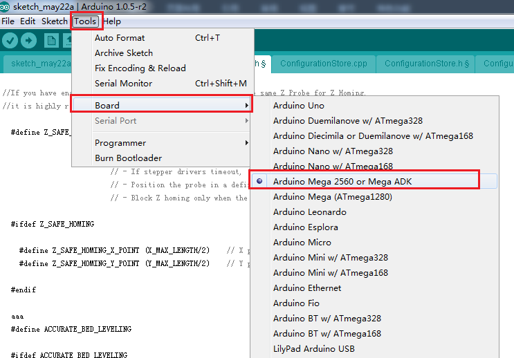

2. Connect GT2560 to your PC with a USB cable,install FTDI drive. Usually it will install automaticlly. If not you need to install maually.
download lthe FTDI driver here.

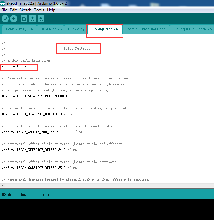

3. If there is nothing wrong with the hardware of board, you can find COM port in device manager. But every computer has different COM watchword, you need check by yourself.

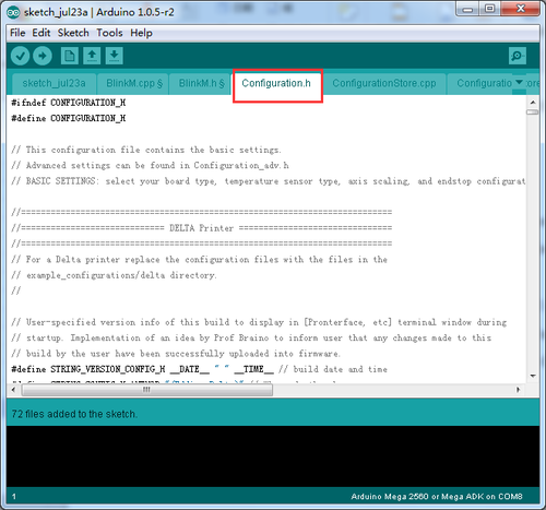

4. Unzip the firmware, drag all the files into Arduino IDE. I use Arduino1.0.5,choose Board\Arduino Mega or Mega2560,and selects ATmega2560(Mega2560) as default Processor. The order cannot be wrong. Selects the COM port you find in the device manager.
5 Most of the code you need to modify is in Configuration.h .
Find the value you need to comlile according to your printer. Upon compiling, you can upload the firmeare to your control board. Simply click veryfy and upload.

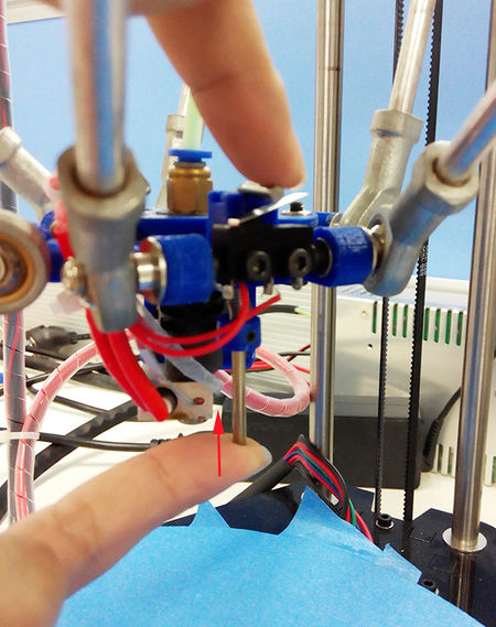

1. Adjust the printing bed Put a level meter on the bed when adjusting the 3 screws of the bed to check if it is level.
2. To protect the bed and the nozzle from crashing, please attach a piece of tape on the bed.

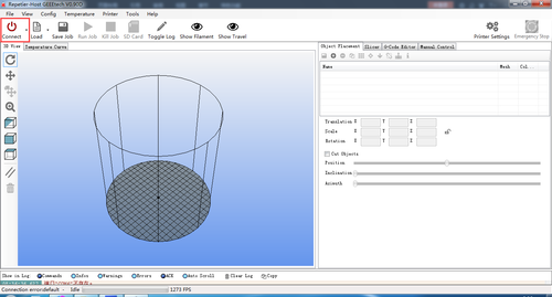

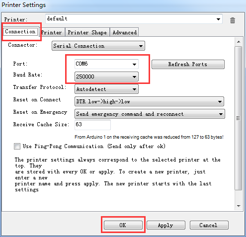

Step1. Connect the USB to your Rostock mini G2 or G2s and power it up. You can see the LED lights and fan come to life, you may be able to hear the motors idling.
Step 2. Open Repetier Host and ensure that you have a valid port selected for communications. To do this simply, click “Printer Settings” in the upper right-hand corner to bring up the printer settings menu.
Step 3. Choose the Connection menu to select the COM6 port and the Baud rate 250000. Click OK to continue.
If you can not fond the COM port, click “refresh ports” and see if it appears. (It is usually the last one; you can check the device manager to see which port it is). PS: if you still cannot find the port, please re -install your USB driver.

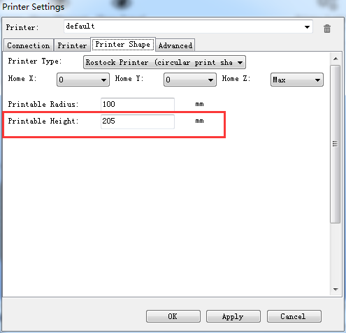

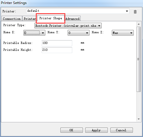

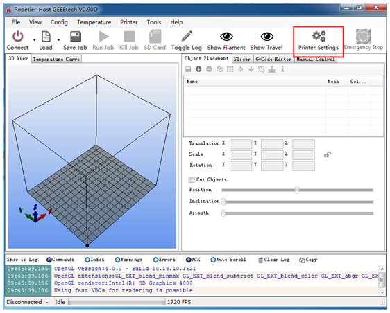

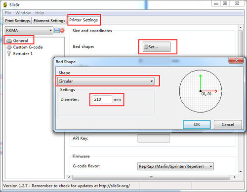

Step4 Choose printer shape. This is very important. Choose printer type as Rostock Printer(circular shape)
Home X: 0,
Home Y: 0
Home Z: Max
Printer Radius: 100mm
Printable height: 200mm
Step5. Hit "connect" in the upper left-hand corner. You should see the details of the connection in the console window in the bottom section of the screen.

Homing is the first and foremostt hing you need to test. To home the printer, you can check if the three axis of the printer move in the same direction,if not, there will be crack for the spider and the carriage.
Before homing, you need to follow the next steps.

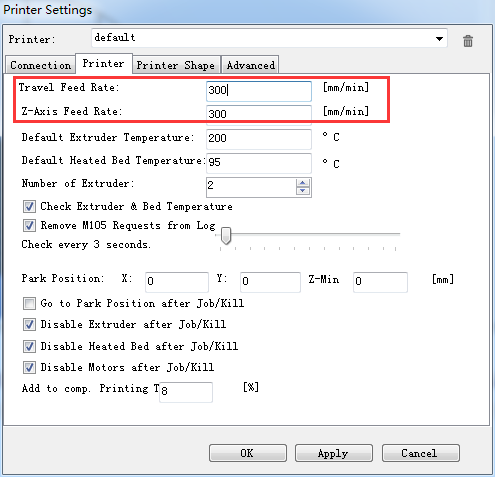

1.Go to printer setting> printer. Set the travel feed rate and the Z axis feed rate as 300 mm/min.
(Even though we have set the speed as slow as possible for you, you still need to adjust the feed rate. )

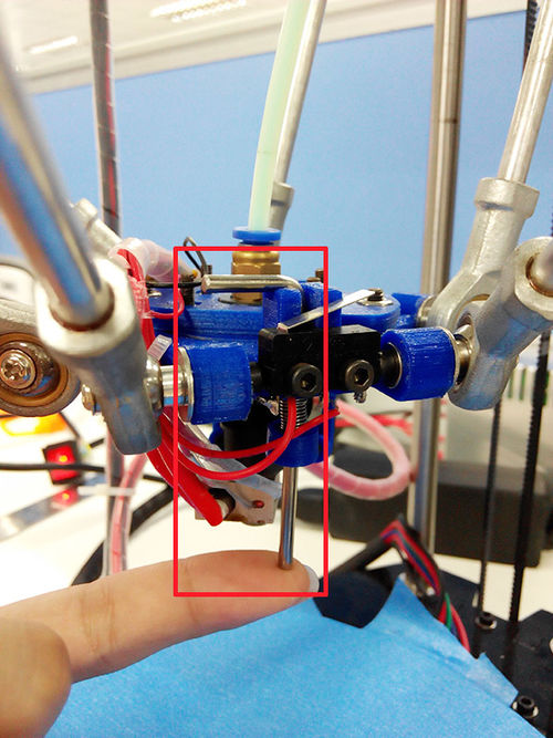

2.Hook up the probe with your hand, we are not testing the auto-leveling fuction right now.

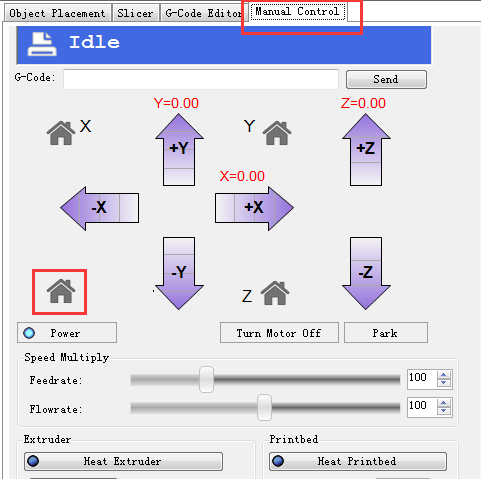

3. Move the extruder head to the middle and be ready for emergency stop. You can click the emergency stop icon on the repetier host or shut the power supply directly.
4. Go to the Manual Control and click the home icon.
If the three axis move in the different directions, please check the conenction of the stepper motor wires.

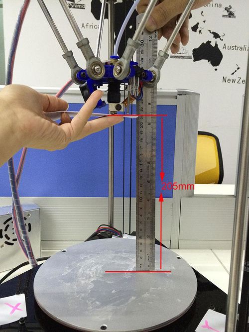

Define the initial Z axis height

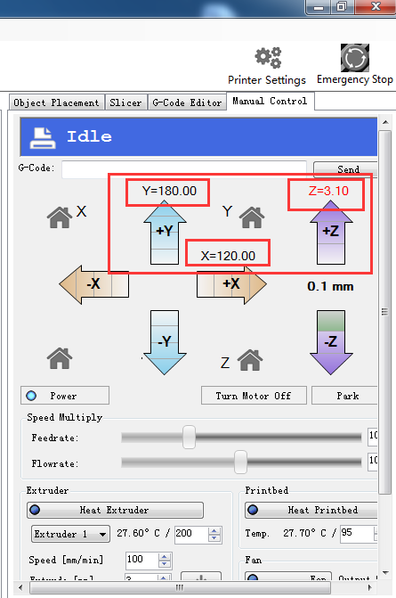

If the printer can home normally, the three axis move in the same directions, we can set the height of the Z axis now, but this value may not be the final height.
1. You can use a rule or digital graphics to measure. The height of the Z axis means the distance between the nozzle and the building platform after homing. So you need to measure after homing.
2. Or you can use maual control to move the Z axis down to the building platform till the nozzle just touches the bed. When moving the Z axis, please slow it down.
Move 0.1mm per click
3.Read the coordinates of the Z axis when the nozzle just touches the bed. E.g. if it is (0,0,1), then the Z axis height is 200-1=199。If it is (0,0,2) the height is 200-2=198.
(*200 is pre-set height in the firmware. 1 is the Z coordinate)

Upon uploading the firmware, you need to change the printing setting in the Repetier host.
Home X: 0
Home Y: 0
Home Z: Max
Printable height: 205mm (* the height you put in the firmware)

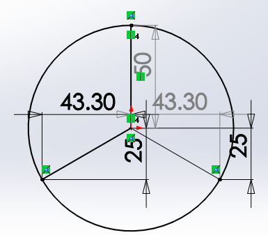

Step3. Set 3 probing points (0,50)、(43.3,-25)、(-43.3,-25), using G-code command to adjust the print head to the 3 points and record the distance between the nozzle and the print surface separately.
1)send command: G0 X0 Y50 Z2, record the distance;e.g. it is 3mm in my case.
2)send command: G0 X43.3 Y-25 Z2, record the distance;e.g. it is 2.7mm in my case.
3)send G 0 X-43.3 Y-25 Z2, record the distance;e.g. it is 2.2mm in my case.
You may need to adjust again and again till the three distance are the same or at least very close.
If the 3 numbers differ too much, you can manually move down the print head until the nozzle just hit the print bed, and screw the endstop screw trigger tightly. At this step, we are trying to adjust the distance between the nozzle and the print surface to keep the center point and its around point in one plain, that is to say, we need to make sure that when the nozzle touches the bed, whichever point it is, the Z Coordinate value should be the same, or almost the same.
You are required to operate again and again till you get a satisfied result.

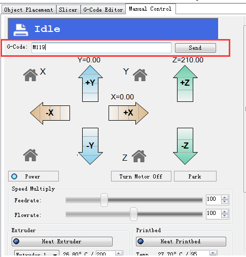

check the status of endstop
1. verify the endstop Before you risk any damage, you should test if you have configured the z-probe correctly. Send the command M119 to verify the endstop first.
You can see the following message
* x_max,y_max,z_max is for the endstop:
if the endstop is triggered, the feedback is Triggered;
If the endstop is not triggered, the feedback is Open.
z_min is for the probe:
When probe is put down, the feedback is Open;
When probe is hooked up, the feedback is Triggered;
2. Verify Homing Send G28 or click the home icon to homing the printer.
You will see the X/Y/Z raise up till they hit the endstops. Then they will move down a bit and hit the endstops again before they stop (that is to increase the printing precision).

You can calculate the Z_PROBE_OFFSET values with this procedure: Put down the prob. Manual y move the print head down slowly, place the probe at the center of the print bed. When you hear the trigger of the endstop, you can get the coordinate on the Repetier host. In my case, it is 【-20.35,11.75,0.3】, you can add it to the following settings.
#define X_PROBE_OFFSET_FROM_EXTRUDER 20.35
#define Y_PROBE_OFFSET_FROM_EXTRUDER -11.75
#define Z_PROBE_OFFSET_FROM_EXTRUDER -0.3
//these are the offsets to the probe relative to the extruder tip (Hotend - Probe), these values are very important, especially the Z_PROBE_OFFSET.
Then modify the Z_PROBE_OFFSET in the firmware and upload again.
slic3r configuration
printer setting
1. set bed shape.
in the latest version of Slic3r,V1.2.7, you can set the bed shape, this is very important when printing with your delta rostock mini. go to general manual, click set button, choose circular and fill in the diameter of the printer bed.
  • if your slic3r is not the latest version, you can update or download it here, unzip the file and drag them into the directory of your previour slic3r directory. do please delete the old version. Restart your Repetier and continue.

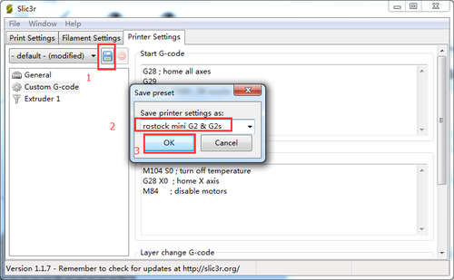

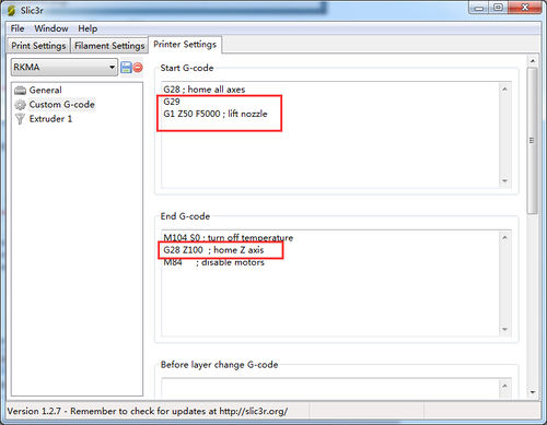

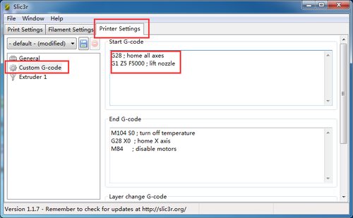

2.Start G29 Command
Thoughg we have added an auto-leveling probe for the Rostock mini, but generally there is no G-gode in the sli3er, so we need to add the G29 command to the sli3er.

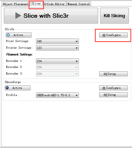

Step1. Start G29 command in Slic3r.
Click Slicer and configure, waiting for a minute till the slicer window prompt up.
Step2. Choose printer setting-- Custom G-code.
You can see from the start G-code, there is no G29.
So you need to add the G29 after G28 to start it. And change Z5 into Z50.
Save the current printing setting, click “OK” to continue.

Auto-leveling probe is controlled by G29 command. As this is a DIY 3d printer, you may need to help it complete the leveling:
1.You need to put down the auto-leveling probe manualy.
2.Send G29 command.
3.auto-leveling probe will probe the 3 pre-setted probing points. After probing, the print head will raise up a bit and stop.
4.Hook up the probe manualy.
as this calibration needs to be done several time before you can start printing, you can refer to this guide.
1.Manualy put down the probe, then send M119 command to check if the Z-min is open.
2.Send G28 command to auto home the printer.
3.Send G29 command to start the auto-leveling. *there might be collisions, please always be ready to cut off the power supply.
4.After sending G29, the printing head will move down, and hit the probe point setted, after the probing, the printing head will go up.
5.After the leveling, the printing head will raise up and stop, meaning the leveling is finished. You should have the probe back (as the spring on the probe is a bit tight, to make it easier, you can use your finger to push up the probe).
6.Send G1X0 Y0 command to move the printing head to(0,0).
7.Click -Z icon on manual control to move the print head down until it touches the print bed just enough. Send M114 command to get the present coordinates. If the coordinate is (0,0,0), the auto-leveling is successful. If not, you need to modify the Z_PROBE_OFFSET_FROM_EXTRUDER , e.g. Reduce -0.3 to -0.5, and then re-upload the firmware and test again.
8.You may have to test it for more than once, but for the sake of better printing object,please be patient.
9.Once auto-leveling is set up, Hook up the probe manualy. Then you can print your first prints.

Step2. Set 3 probing points (0,50)、(43.3,-25)、(-43.3,-25), using G-code command to adjust the print head to the 3 points and record the distance between the nozzle and the print surface separately.
If the 3 numbers differ too much, you can manually move down the print head until the nozzle just hit the print bed, and screw the endstop screw tightly, if the screw has no room to adjust, you need to change the following setting later, record it. E.g. Change 213.5 into 214
 455 #define MANUAL_Z_HOME_POS 214

Modify the firmware of Delta
We have pre-loaded the firmware to GT2560 before shipping, but as this is a DIY printer, there may be some subtle difference between each printer, so you need to modify the firmware to fit your exact printer for better printing effect.
1. Download the firmware here. And unzip the zip/rar file.
2. Open Arduino IDE. ( If you do not have Arduino IDE, you can download here.)
3. Drag all the files into Arduino IDE.
4. Click Configuration.h and find out Delta Settings
 #define DELTA and modify the values as below.
Please pay close attention to the red numbers.
 // Make delta curves from many straight lines (linear interpolation).
 // This is a trade-off between visible corners (not enough segments)
 // and processor overload (too many expensive sqrt calls).
 107 #define DELTA_SEGMENTS_PER_SECOND 160
 110 #define DELTA_DIAGONAL_ROD  186【1】
 113 #define DELTA_SMOOTH_ROD_OFFSET 160.0 【2】
 116 #define DELTA_EFFECTOR_OFFSET 34.0【3】
 119 #define DELTA_CARRIAGE_OFFSET 25.0【4】
* To help you better understand the 4 values, you can refer to the scheme.
 // Horizontal distance bridged by diagonal push rods when effector is centered.
 122 #define DELTA_RADIU (DELTA_SMOOTH_ROD_OFFSET-DELTA_EFFECTOR_OFFSET-DELTA_CARRIAGE_OFFSET+ 2.0)
 =160-34-25+2

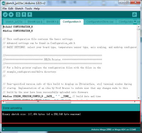

Till now, you have finished the edit of the firmware, then, you need to upload the modified firmware into your control board. For those not mentioned just leave them as default.

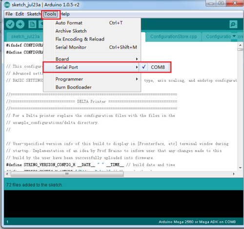

5.Uploard firmware Choose board type.
6.Choose serial port (if you cannot find the serial port, please check the connection of your printer to your computer.)
7.Load in the file you need to burn, Click the “” button to check if it is right and then click the “” button to upload.
8.Upon uploading, the LED indicator corresponding to the TX, RX and L on the GT2560 will blink, if they stop blinking, it means the file has been uploaded successfully.
9.After uploading, you can go on to the next step. If you cannot upload, check the dialog box below to identify the problem and solve it. The common mistakes are the wrong select of type of board or serial port etc.

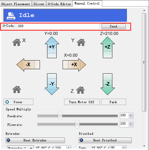

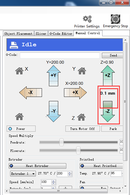

Trouble shooting:
The axis did not stop after hitting the endstops.
Please check if the wire connection of the endstops of X/Y/Z axis matches.
Note: unlike other machines, the origin here is not (0,0,0) but (0,0,MANUAL_Z_HOME_POS)
3.  Get the present coordinates
Send M114 command to get the present coordinates after homing, you can get
 fw(0,0,MANUAL_Z_HOME_POS)
 MANUAL_Z_HOME_POS
This is the distance between nozzle and print surface after homing.
