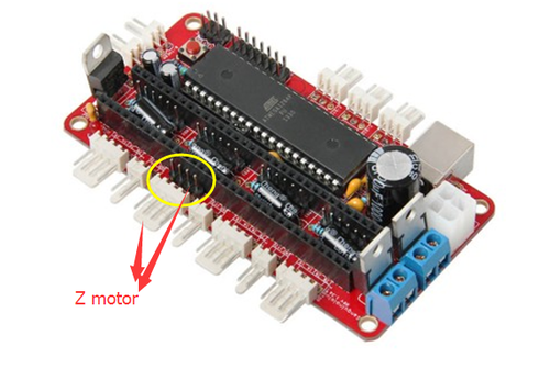

Mount the board on the left side panel of the printer
| Required parts | Required number | Part ID |
Mount control board onto the back of X-Z frame, and screw up it with M3x20screws, M3washers and M3 nuts.
- Attention:
The four A4988 stepper motor driver board is plugged on the board before shipping. The four spacers should between X-Z frame and control board.

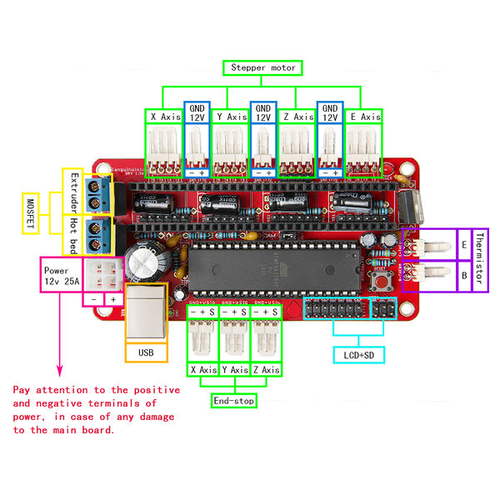

Wiring
Please refer to the picture
Note: there are two stepper motors for Z axis, the connecter is as shown in the following picture:
For detailed wiring instruction, please refer to the video
Arrange the wires and tidy them up with the coil
