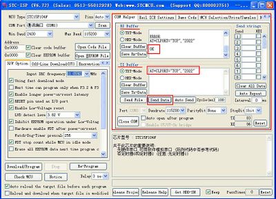

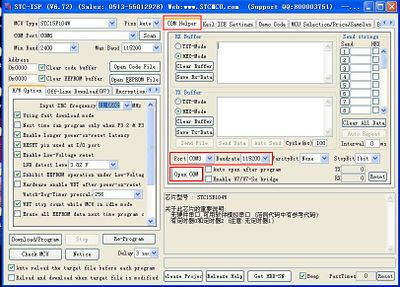

Steps
1, Start the “Net Assist”, choose ‘TCP server’ in the dropdown menus of “protocol” (UDP Server is not recommended), change the “Local Host IP” into the Fixed IP. Input the “Local host port” set before and then click “Connect “. As shown in following the picture. File:Gprs
2, Open STC-ISP and click ‘COM Helper’ Click ‘COM Port’ and click 115200 in ‘Baud rate’ ( if the code is unreadable in RX Buffer, then re-click Baud rate) , click “Open COM”
Input the following code in the text box of “TX Buffer” and then press “Enter”.
 AT+CLPORT=”TCP”,”2022”
Click “Send Data”. If t he “RX Buffer” shows” ok”, it is successful.
 OK
Input in “TX Buffer” as follows,
 AT+CIPSTART="TCP","183.37.246.171","10000"
(NB.IP “183.37.246.171” is a Public IP from Google; “10000” is the “Local Host Port”). And then click “Send Data”. The “RX Buffer” will appear
 OK
 CONNECT OK
as follows, which means the data has been sent successfully. Now it can realize the TCP communication.
