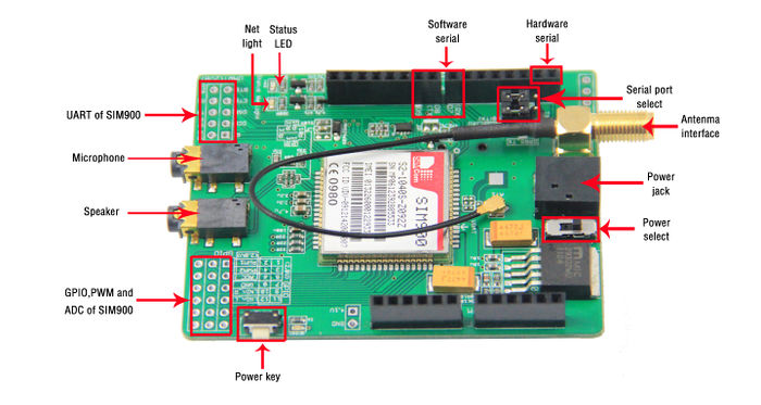

Hardware Diagram
  • Power select - select the power supply for GPRS shield(external power or 5v of arduino)
  • Power jack - connected to external 4.8~5VDC power supply
  • Antenna interface - connected to external antenna
  • Serial port select - select either software serial port or hareware serial port to be connected to GPRS Shield
  • Hardware Serial - D0/D1 of Arduino
  • Software serial - D7/D8 of Arduino

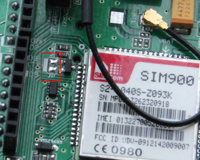

  • Status LED - tell whether the power of SIM900 is on
  • Net light - tell the status about SIM900 linking to the net
  • UART of SIM900 - UART pins breakout of SIM900
  • Microphone - to answer the phone call
  • Speaker - to answer the phone call
  • GPIO,PWM and ADC of SIM900 - GPIO,PWM and ADC pins breakout of SIM900
  • Power key - power up and down for SIM900

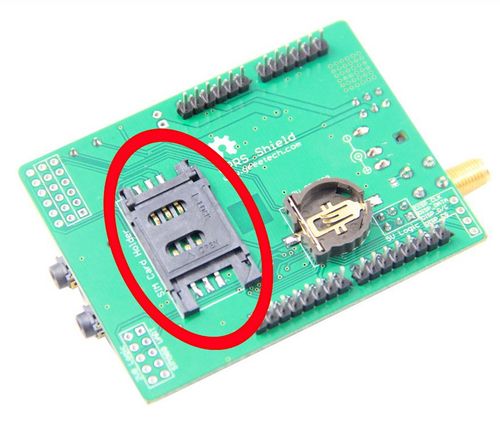

  • Insert a unlock SIM card

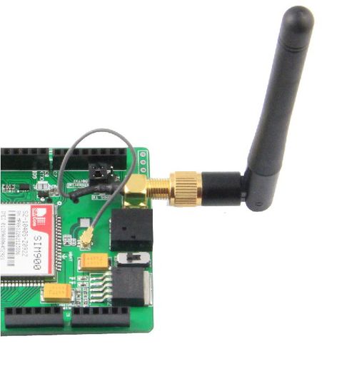

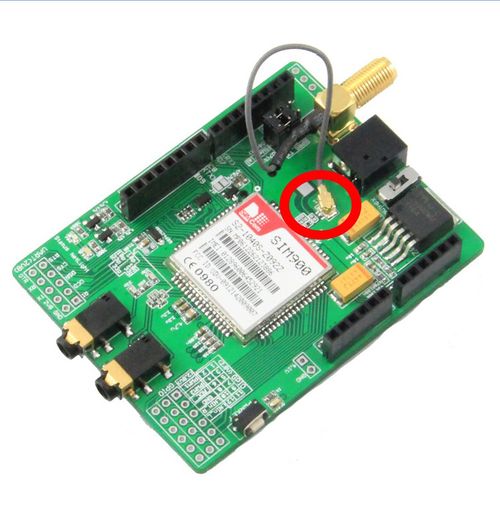

  • Make sure the antenna pad buckled properly
  • Assemble the GSM antenna

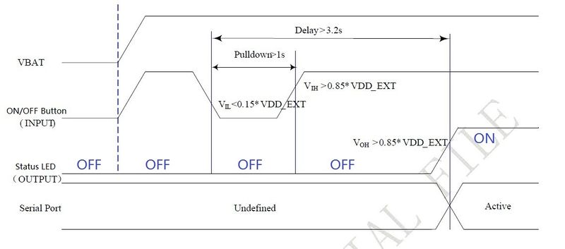

The GPRS Shield can be turned on by two ways:
  • 1, Hardware Triger; Press the ON/OFF Button about two seconds.The power up scenarios illustrates as following figure:
  • 2, Software Triger; If use this way to power up the GPRS Shield, JP need to be soldered, then Digital Pin 9 of the Arduino will act as Software Triger port and Digital Pin 9 can not be use as other purpose. Then give Digital Pin 9 a Turn on Impulse can power up the GPRS Shield. The power up scenarios illustrates as following figure:

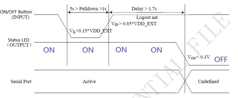

  • 1, Normal power down procedure: Turn off the GPRS shield by using Hardware Triger; Press the ON/OFF Button about two seconds.
The power down scenarios illustrates as following figure:

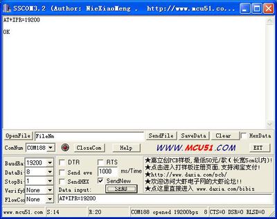

  • Users can use “AT+IPR=?” command to see supported baudrate, it will response a list of supported baudrate.
  • Users can use “AT+IPR=x”(x is value of supported baudrate) to set a fixed baud rate and save the configuration to non-volatile flash memory.

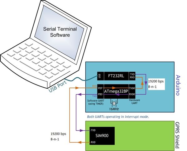

Step 1: Creating a test setup for the GPRS Shield
AT Commands are simple textual commands sent to the GPRS modem over its serial interface (UART), so you can use any serial terminal software to communicate with it.
Note: Almost all the AT commands should be sent followed by carriage return and you need to select the "+CR"option in the serial port terminal.To experiment with AT commands, you would require a way to power up and communicate with your GPRS Shield. The best way to do this using an Arduino Duemilanove board.
  1. Follow the previously described hardware installation steps to set up the hardware system;
  2. Make sure the GPRS_TX & GPRS_RX jumpers on the GPRS Shield are mounted in SWSerial position - that is we want GPRS_TX to be connected to D7(RX) and GPRS_RX to D8(TX).
  3. Connect the Arduino Duemilanove to your computer using a USB cable.
  4. The ATmega328P microcontroller on Duemilanove board has only one UART which is used for communicating with the PC. What we need is an Arduino Sketch running inside the ATmega328P that would emulate a second serial port (UART) using software on the digital pins D8 and D7 and patch through all the communication between this second software serial port and the actual hardware serial port. By doing this, all the data coming from the computer (connected to the actual hardware UART) would be routed to the GPRS Shield (connected to software UART) then, we would be able to issue AT commands to control the GPRS Shield. The block diagram outlining this scheme is shown below.
For developing such a program, we require to use the SoftwareSerial library included in the libraries of Arduino 1.0 already and the demo code below.

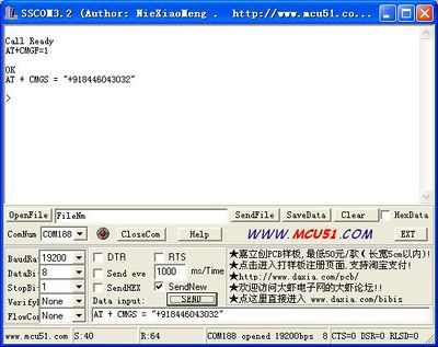

  2. .Through your serial terminal software, send AT+CMGF=1 and press the Enter key. The GPRS Shield can send SMSes in two modes: Text mode and PDU (or binary) mode. Since we want to send out a human readable message, we will select the text mode. The GPRS Shield will respond with an OK.
  3. .Click "send new" option and send AT+CMGS="+918446043032". This will instruct the GPRS Shield to start accepting text for a new message meant for the phone number specified (replace the number with the phone number of the target phone). The GPRS Shield will send a > to remind you typing the message.

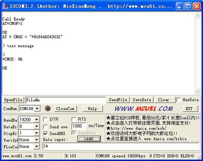

  1. .Start typing your message and when you are done, and click "send hex" option and then send a hex: 1A. The modem will accept the message and respond with an OK. A few moments later, the message should be received on the handset whose number you had specified.You can refer to the picture below.
NOTE: If, in spite of following the steps as specified above, you aren't able to receive the message on the target handset, then it might be that you need to set the SMS Message Center number. Send the command AT+CSCA="+919032055002" and press the Enter Key. Send this command in between the AT+CMGF and AT+CMGS commands. Replace the phone number specified in the command above with the SMS Center number of your GSM Service Provider. The message center number is specific to each service provider (for example +919032055002 is the message center number for Tata DoCoMo, Pune, India). You can get the message center number by calling up the customer care center of the GSM Service Provider and asking them for it.

  4. .Connect the antenna to the GPRS Shield and insert the SIM Card.

 The microcontrollers Digital Pin 7 and hence allow unhindered
 communication with GPRS Shield using SoftSerial Library.

1, Start the "Net Assist", choose "TCP server" in the dropdown menus of "protocol" (UDP Server is not recommended), change the "Local Host IP" into the Fixed IP. Input the "Local host port" set before and then click “Connect “. As shown in following the picture.
2, Open STC-ISP and click "COM Helper" Click "COM Port" and click 115200 in "Baud rate" ( if the code is unreadable in RX Buffer, then re-click Baud rate) , click "Open COM"
Input the following code in the text box of "TX Buffer" and then press "Enter".
 AT+CLPORT="TCP","2022"
Click "Send Data". If the "RX Buffer" shows "ok", it is successful.
 OK
Input in "TX Buffer" as follows,
 AT+CIPSTART="TCP","183.37.246.171","10000"
(NB.IP “183.37.246.171” is a Public IP from Google; “10000” is the “Local Host Port”). And then click "Send Data". The "RX Buffer" will appear
 OK
 CONNECT OK
as follows, which means the data has been sent successfully. Now it can realize the TCP communication.
3, Verify the success of communication Input
 AT+CIPSEND
in "TX Buffer", then press "Enter". Click "Send Data" and the "RX Buffer" appears
as follows.
Input
 HELLO WORLD
in "TX Buffer" and click "Send Data", check "HEX-Mode".
Meanwhile, input
 1A
to end instruction and click "Send Data". It is successful when you see
 SEND OK
Now,"Helloword" will appear in "NetAssist".
Select the corresponding IP address and click "Send". "RX Buffer" dialog in STC-ISP will accept the information returned as below.
