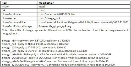

install Linux(yaffs2 format)
Step1: open the config file FriendlyARM.ini in images folder of SD card, modify the related definition item of Linux installation.
Step2:Set the switch S2 to “SDBOOT” side and insert the SD card and power on the development board.
Step3: After the installation is completed, set the switch S2 to “Nand” side and reboot.
