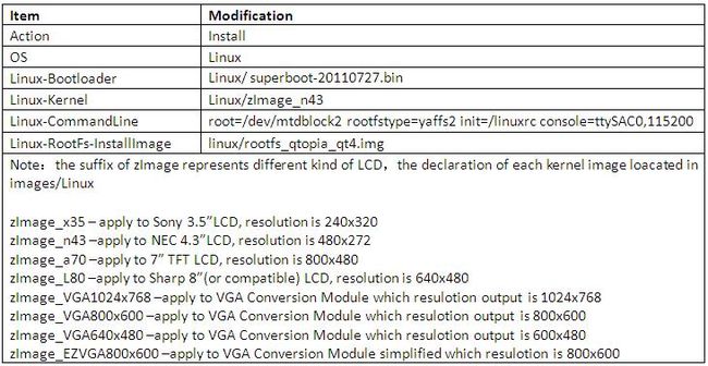

Install Linux(yaffs2 format)
Step1: open the config file FriendlyARM.ini in images folder of SD card, modify the related definition item of Linux installation.

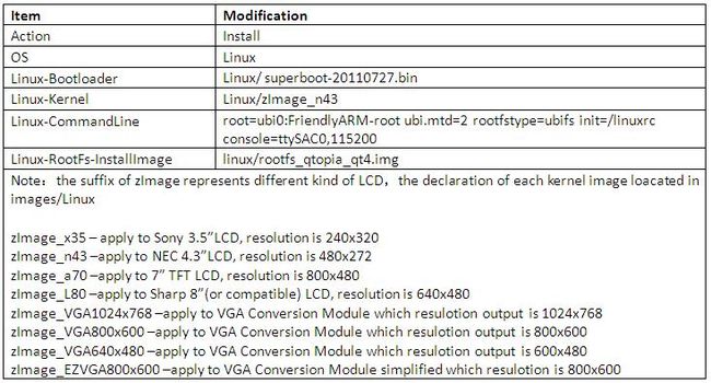

Install Linux(UBIFS format)

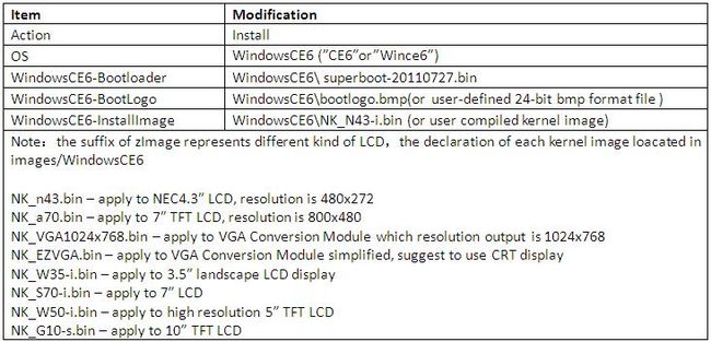

Install WindowsCE6
Step1: open the config file FriendlyARM.ini in images folder of SD card, modify the related definition item of WindowsCE6 installation.

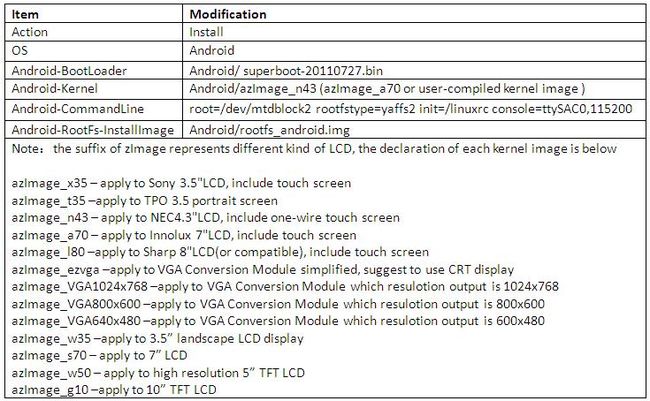

Install Android(yaffs format)
Step1: open the config file FriendlyARM.ini in images folder of SD card, modify the related definition item of Android installation.

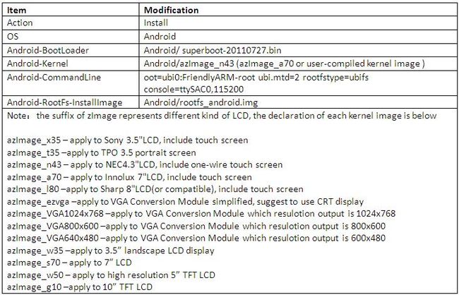

Install Android (UBIFS format)

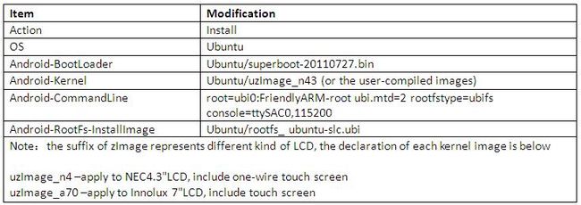

Install Ubuntu(UBIFS format)
Step1: open the config file FriendlyARM.ini in images folder of SD card, modify the related definition item of Ubuntu installation.
