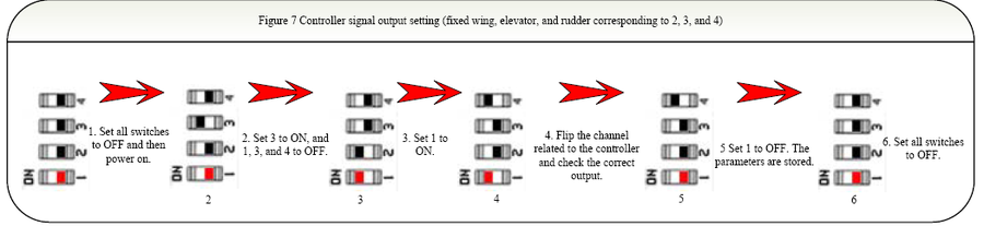

- Controller signal output
In entire OFF mode, set 3 and 1 to ON and perform the following settings
For the rudder output, set 4 to ON or OFF.
For the elevator output, set 3 to ON or OFF.
For the fixed wing output, set 2 to ON or OFF.
- When the switch is set to OFF, the parameters are written into the flight controller storage system.

- Controller signal output setting (fixed wing, elevator, and rudder corresponding to 2, 3, and 4)
- Set all switches to OFF and then power on.
- Set 3 to ON, and 1, 3, and 4 to OFF.
- Set 1 to ON.
- Flip the channel related to the controller and check the correct output.
- Set 1 to OFF. The parameters are stored.
- Set all switches to OFF.
