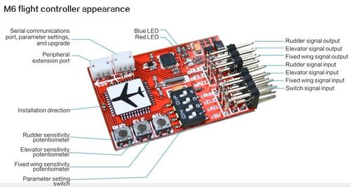

  1. Dimension: 30 x 42 mm
  2. Weight: 6 g
  3. Voltage: 4-9 V DC
  4. Current: 40 MA(max)
  5. Sample Rate of Gyro: 2 KHz
  6. PWM Input: 5 0Hz PMW
  7. PMW Output: 50 Hz PMW

3. 4-digit DIP switcher makes the functional settings for M6 board become easy and convenient.
4. Controlling switcher of flight manual is used through the channel of on-and-off on the remote control to control the start function. When at high altitudes, flight manual control is able to be achieved by this switch so that you can feel the flight functions of plane whether it is controlled or not, practice flight control in none-flight manual mode, and improve your skills easily.
5. Red and blue LED lights make it easier to tell the work mode and the status.

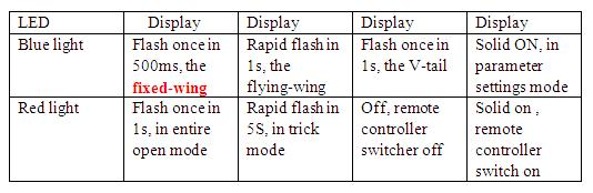

Flight Manual LED Introduction
1. Procedures for Power-on: Red and blue lights->on for 1s->off for 1s->on for 5s->blue light flickers for about 3s (The gyro is locked now and please assure that the plane stays in rest)->Red and blue lights make different indications according to the intrinsic parameters.
2. Remote control switcher indicator: The red light on means that the remote control switcher on (If it's in the flight control mode, at this time, spin the plane and in theory, the correction rudder output of the gyroscope about aileron, elevator and rudder will appear.), off or twinkle means off.
3. Supportive aircraft type directives in flight control mode: Blue light, with 500ms a flicker, indicates the aircraft in the fixed-wing mode; with 1s a faster flicker, in flying-wing mode; with 1s a flicker, in V-tail mode. Red light, with a 1s flash in 5s, indicates that the aircraft is in trick mode; with just a flicker per second, in entire open mode.
4. Flight manual parameter settings: After switching on the DIP settings (starting after switching off all), blue light off and red light on indicates waiting; blue light on and red light off indicates in progress; red light quickly flickers within a long time indicates that the DIP switchers should be all turned off.
5. Observe the LED lights after starting for comprehending the flight control working modes:
(Caution: Blue and red LED light independently indicates each mode; if it is used for the first time, please repeatedly set different working modes of flight manual via DIP switcher in order to grasp and be familiar with the indications of LED lights.)

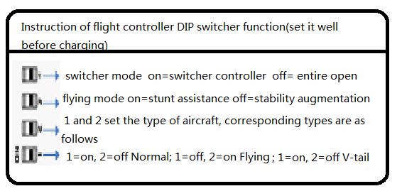

Flight manual DIP switcher settings
Before starting, please set the corresponding switching function with the direction of the picture below. Also, the modes can be freely altered after starting. The flight controller will read the status of the DIP switcher real-time and output them with different flash types combined by red light and blue light. After matching the corresponding types and function and checking all the channels unmistakably, the aircraft can fly.

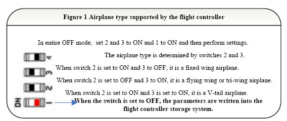

Airplane type supported by the flight controller
In entire OFF mode, set 2 and 3 to ON and 1 to ON and then perform settings.
The airplane type is determined by switches 2 and 3.
When switch 2 is set to ON and 3 to OFF, it is a fixed wing airplane.
When switch 2 is set to OFF and 3 to ON, it is a flying wing or tri-wing airplane.
When switch 2 is set to ON and 3 is set to ON, it is a V-tail airplane.
When the switch is set to OFF, the parameters are written into the flight controller storage system.

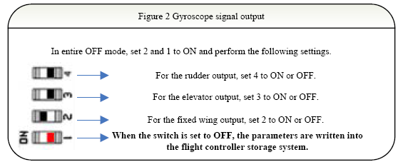

Gyroscope signal output
In entire OFF mode, set 2 and 1 to ON and perform the following settings.
For the rudder output, set 4 to ON or OFF.
For the elevator output, set 3 to ON or OFF.
For the fixed wing output, set 2 to ON or OFF.

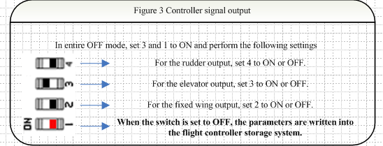

Controller signal output
In entire OFF mode, set 3 and 1 to ON and perform the following settings

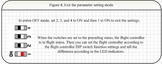

Exit the parameter setting mode
In entire OFF mode, set 2, 3, and 4 to ON and then 1 to ON to exit the settings.
When the switches are set to the preceding status, the flight controller is in flight status. Then you can set the flight controller according to the flight controller DIP switch function settings and tell the difference according to the LED indicators.

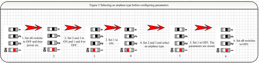

Selecting an airplane type before configuring parameters
  1. Set all switches to OFF and then power on.
  2. Set 2 and 3 to ON and 1 and 4 to OFF.
  3. Set 1 to ON.
  4. Set 2 and 3 and select an airplane type.
  5. Set 1 to OFF. The parameters are stored.
  6. Set all switches to OFF.

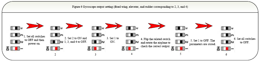

Gyroscope output setting (fixed wing, elevator, and rudder corresponding to 2, 3, and 4)
  2. Set 2 to ON and 1, 3, and 4 to OFF.
  3. Set 1 to ON.
  4. Flip the related switch and rotate the airplane to check the correct output.

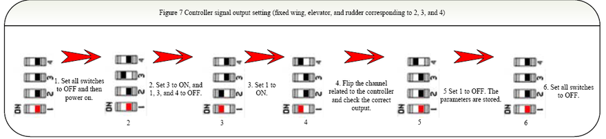

Controller signal output setting (fixed wing, elevator, and rudder corresponding to 2, 3, and 4)
  2. Set 3 to ON, and 1, 3, and 4 to OFF.
  3. Set 1 to ON.
  4. Flip the channel related to the controller and check the correct output.

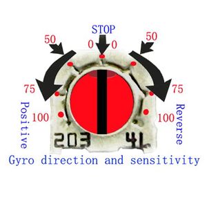

Gyroscope calibration

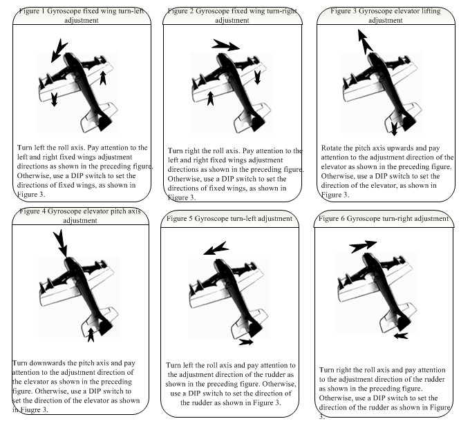

The direction and the sensitivity settings of gyroscope is below, spin the sensitivity pot clockwise or anticlockwise from stop position, the sensitivity is in proportion to the pot spinning. Positive spinning output positive signal, reverse spinning output positive signal. Please note the reference position of the sensitivity.

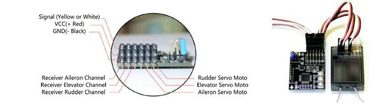

Installation and Wiring

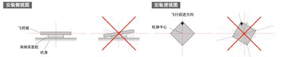

  1. The M6 board can be mounted on both sides (top or bottom) of plane. The label of plane on the M6 board should be in perfect paralleled and matched with the plane; it'll be better to be in the center of the fuselage. Please stably stick it on the plane with double sided tape to insure it is flat, steady, and secure. It will be in big trouble, if inappropriate or loosened.
  1. iSW-iAIL-iELE-iRUD should be respectively matched to the channel of switcher, aileron, elevator, and rudder of remote receiver; oAIL-oELE-oRUD should be respectively matched to the servo of aileron, elevator, and rudder.

4. Check the LED indication. Please check the red and blue LED lights based on the Flight Manual LED Introduction, understand the working mode that the flight manual is now in and if the current mode is what you want; if not, please reset the parameters into the mode you want according to the Flight manual DIP switcher settings.
5. Check the signal output of remote control. First, check if the aileron, elevator, and rudder are correct by remote control. There are two methods to moderate if incorrect: 1. Set the output direction of intrinsic channel of remote control; 2. Set the mode according to Picture 3 & 7 of Flight Manual Parameters settings until each control of the responding channel is perfectly correct.
6. Check the signal output of gyro amendment. Please carefully check out if the output of each channel is perfectly correct based on the introduction of Gyro Gain Adjustment. If it is incorrect, please correct it according to Picture 2 & 6 of Flight Manual Parameters settings until it is perfectly correct.

9. Sensitivity adjustment. The sensitivity is to adjust the control strength of the gyroscope on the airplane. The higher degree the gyroscope turns clock wisely, the greater the sensitivity. Usually, you are advised to adjust the sensitivity to 1/2 or 1/3 and then adjust it slightly as required. If you feel the airplane jitters greatly, adjust the sensitivity potentiometer counterclockwise slightly. Or adjust the sensitivity potentiometer clock wisely greatly to obtain optimal performance.
