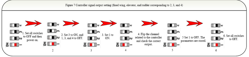

Controller signal output setting (fixed wing, elevator, and rudder corresponding to 2, 3, and 4)
  1. Set all switches to OFF and then power on.
  2. Set 3 to ON, and 1, 3, and 4 to OFF.
  3. Set 1 to ON.
  4. Flip the channel related to the controller and check the correct output.
  5. Set 1 to OFF. The parameters are stored.
  6. Set all switches to OFF.
