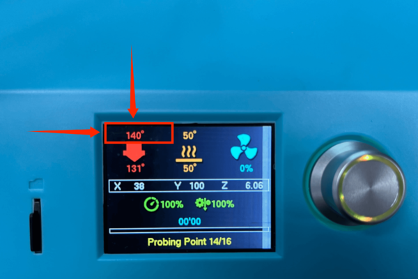

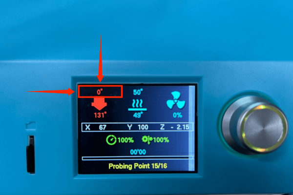

Abnormal temperature during automatic leveling
During automatic leveling, the preset temperature will switch back and forth between 140 degrees and 0 degrees, which is normal.
