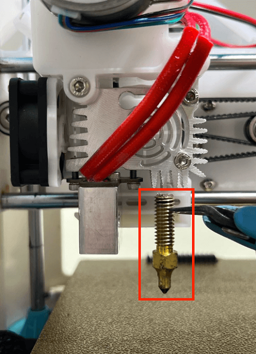

How to clean the hotend

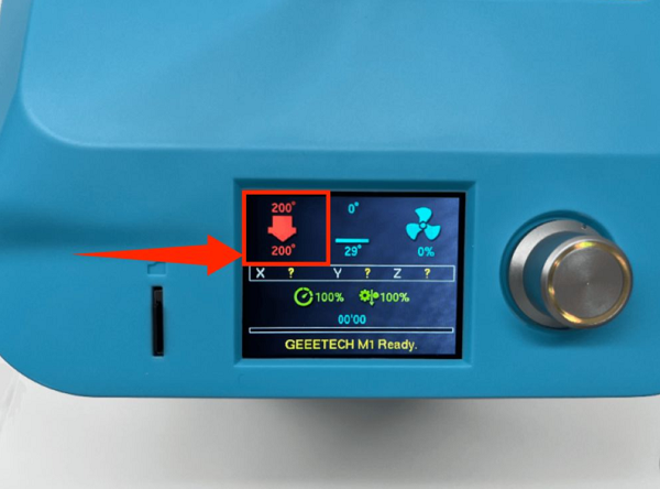

1. In the menu preheating function, set the nozzle temperature to 200 degrees

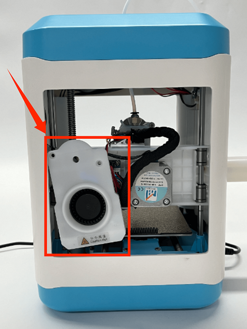

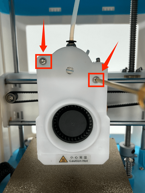

2. Use an M2 screwdriver to remove the two screws of the print head cover and place it behind (be careful not to tear off the blower fan connection line)
3. First remove the Teflon tube, then insert the cleaning needle from the pneumatic interface (quick plug) until it reaches the bottom, and squeeze the cleaning needle up and down to squeeze out the consumables

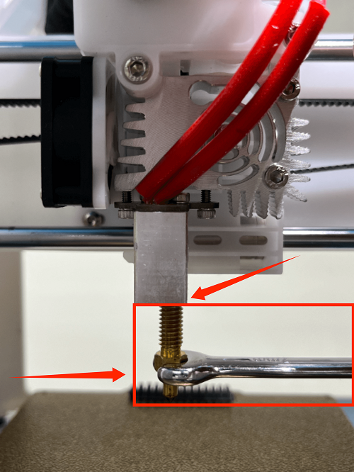

How to Replace the hotend

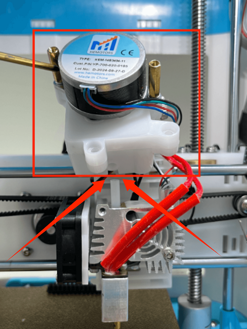

1. Use an M2 screwdriver to remove the two screws of the print head cover and place it at the back (be careful not to tear off the blower fan cable)
2. Use an M3 screwdriver to remove the two fixing screws of the extruder assembly and place the extruder assembly at the back
3. Use an M3 screwdriver to remove the three fixing screws of the throat and remove it

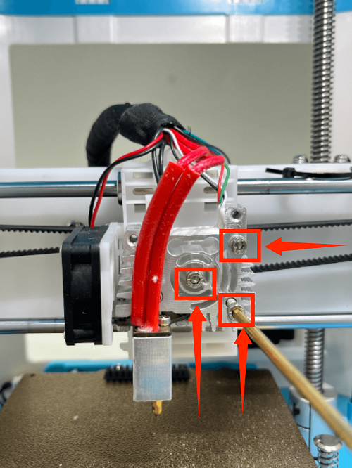

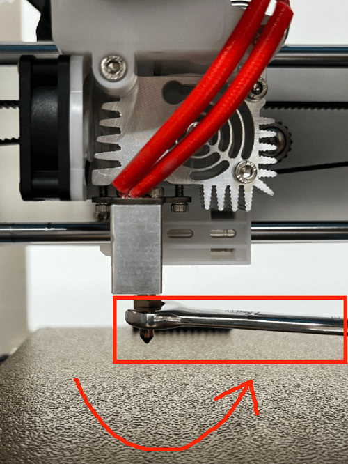

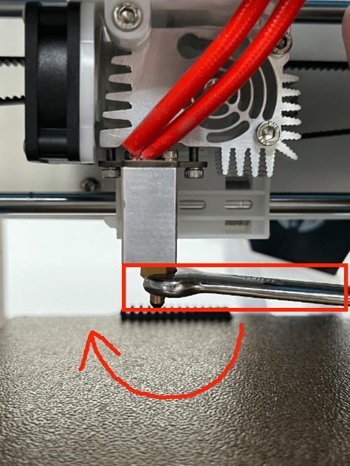

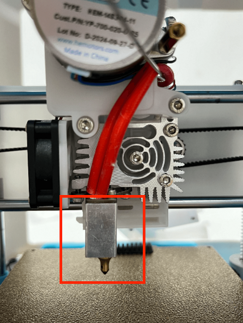

How to replace the nozzle
3. Use the built-in nozzle wrench to remove the nozzle by turning it clockwise
(Please note: the nozzle temperature is very high, do not touch it directly with your hands to avoid burns)
4. Dock the new nozzle in the appropriate position and tighten the nozzle by turning it counterclockwise until it is tightened and not loose

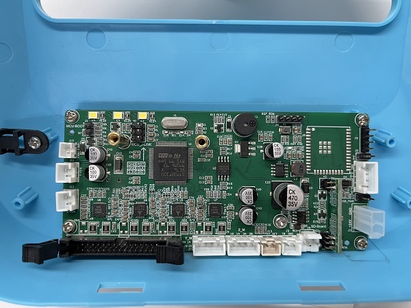

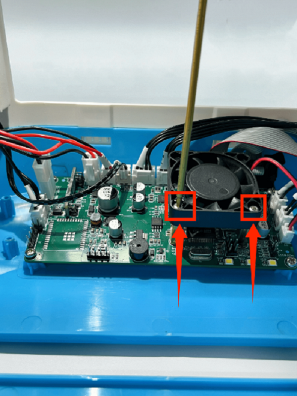

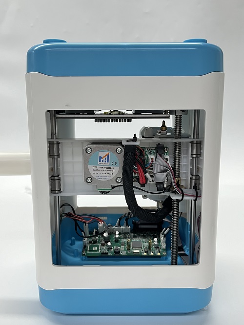

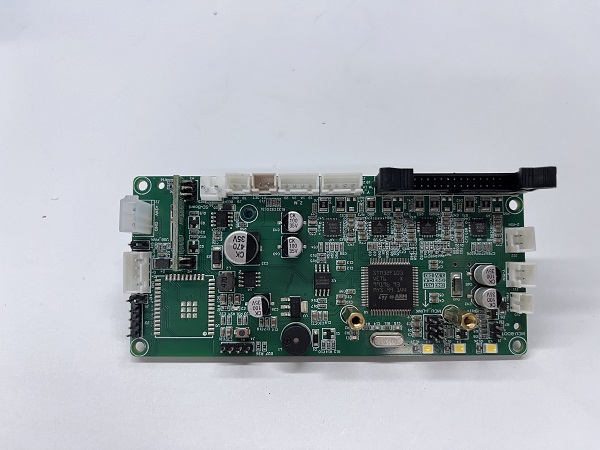

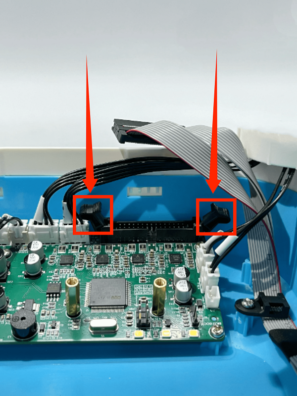

How to Replace the Control Board
1. Place the printer upside down
2. Remove the fan screws on the motherboard and remove the fan
3. First remove the connection wire between the motherboard and the print head adapter board, then remove all the connection wires on the motherboard
4. Use a screwdriver to remove the 5 fixing screws on the motherboard, unplug the screen button, and remove the old motherboard
5. Place the new motherboard in the right position and fix it with 5 screws
6. Install the screen connection cable and connect all the cables according to the motherboard wiring diagram
(Please note: do not connect the cables incorrectly)
7. After installing the motherboard fan, place the printer upright

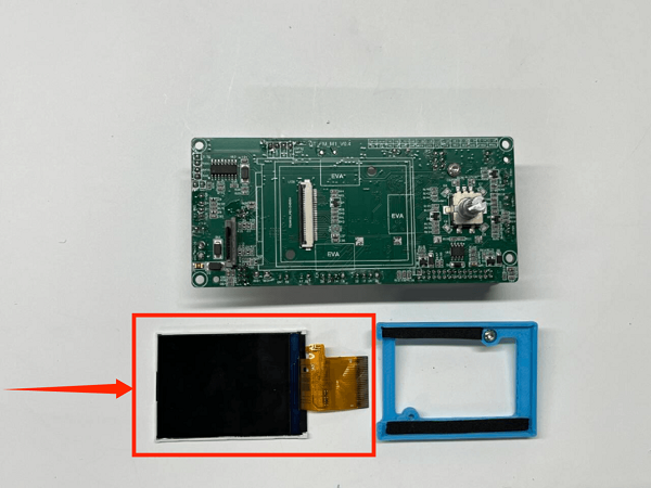

How to Replace the Screen
2. Remove the fan screws on the mainboard and remove the fan
3. First remove the connection wire between the mainboard and the print head adapter board, then remove all the connection wires on the mainboard
4. Use a screwdriver to remove the 5 fixing screws on the mainboard, unplug the screen button, and remove the mainboard
5. Unplug the screen connection wire to the left and remove the old display screen
6.Place the new display screen in the right place, install the screen connection cable, and fix it.
7. Place the new motherboard in the right place and fix it with 5 screws.
8. Install the screen connection cable and connect all the connection cables according to the motherboard wiring diagram.
(Please note: do not connect the connection cables incorrectly)
9. After installing the motherboard fan, place the printer upright.

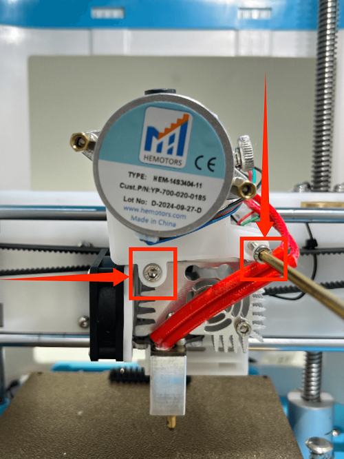

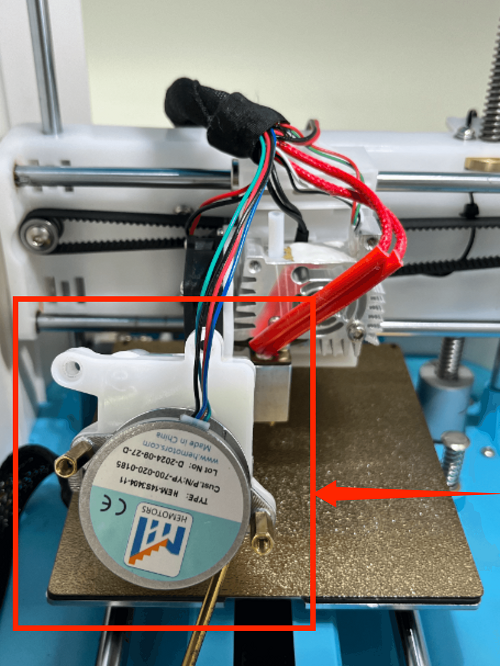

How to Replace the Extruder
1. Use an M2 screwdriver to remove the two screws of the print head cover and place it behind (be careful not to tear off the blower fan cable)
2. Use an M3 screwdriver to remove the two fixing screws of the extruder assembly and move the extruder assembly upwards

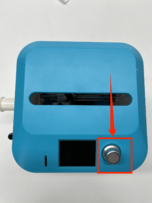

How to Manually Level
1. In the menu interface, click Prepare first, then click Manual Leveling
2. After a few seconds, click the button to confirm.
3. The picture below shows the location of the first leveling point.
However,it can be clearly seen from the picture that the nozzle is too far away from the hot bed,
so we need to adjust the distance between the nozzle and the hot bed by rotating the button.
4. The best distance between the nozzle and the hot bed is the thickness of an A4 paper
Turn the button counterclockwise to the left to lower the nozzle height and shorten the distance between the nozzle and the hot bed
Turn the button clockwise to the right to raise the nozzle height and increase the distance between the nozzle and the hot bed
5. There will be a slight friction when pulling A4 paper back and forth. This is the optimal thickness of A4 paper.
6. Then click the button to enter the next manual leveling point
7. For other manual leveling points, the same as the first leveling process,
repeat the operation until all manual leveling points are completed, and the manual leveling operation is completed.

Mainboard wiring diagram

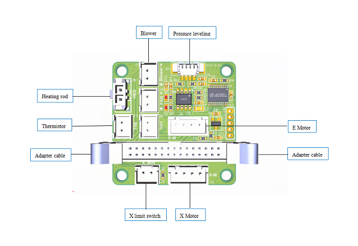

Print head adapter board wiring diagram

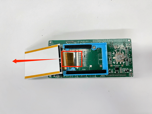

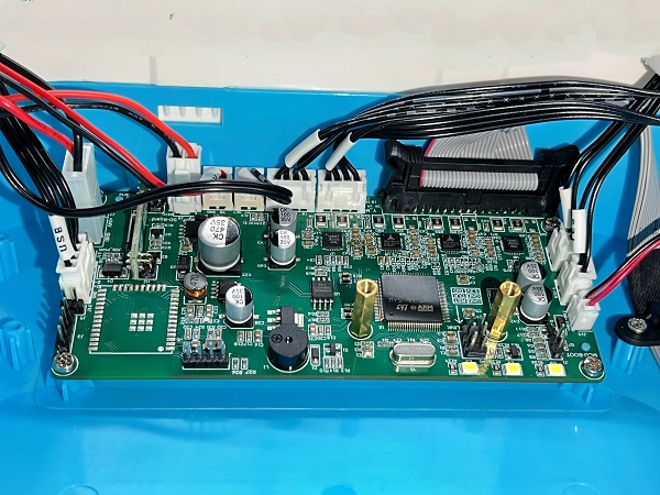

Black Screen
The LCD display is black, which is related to the power supply, motherboard, and display. This needs to be checked: After powering on and turning on the power, use a multimeter to measure the voltage of the Power Supply and Hotend in the motherboard in the figure below
1. Measure the Power Supply voltage to be 24V, which proves that there is no problem with the power supply. If it is 0V, you need to replace the power supply
2. Measure the Hotend voltage again to see if it is 24V. If it is 24V, it proves that there is no problem with the motherboard. If it is 0V, you need to replace the motherboard or power supply
3. If the voltage of the Power Supply and Hotend are both 24V and the screen is not bright, just replace the LED display

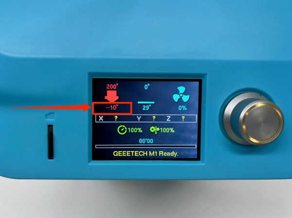

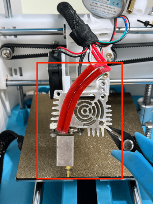

Minimum Temperature Error
As shown in the figure below, a negative temperature fault occurs, which is usually caused by a thermistor. It is recommended that you replug the thermistor connection line and try again. If it still cannot be solved, you need to replace a new thermistor

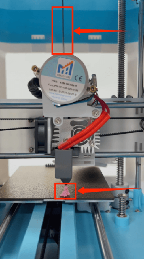

Model does not stick to the platform
1、 The nozzle is too far from the platform
Solution:Adjust the Z-axis compensation value through automatic leveling or automatic leveling. The distance from the nozzle to the platform is about the thickness of an A4 paper
2、 The first layer is printed too fast
Solution:The printing speed can be reduced to ensure that the first layer is well bonded to the platform. You can reduce the printing speed by adjusting the knob on the screen, or set the first layer printing speed in the slicing software, preferably in units of 10%
3、 Add Birm in the slicing parameters
Solution:Adding inner and outer Brim can increase the contact area of ​​the model, ensure that the model is better attached to the hot bed, and also ensure that the model is not easy to fall off during printing

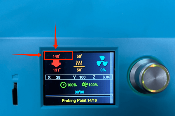

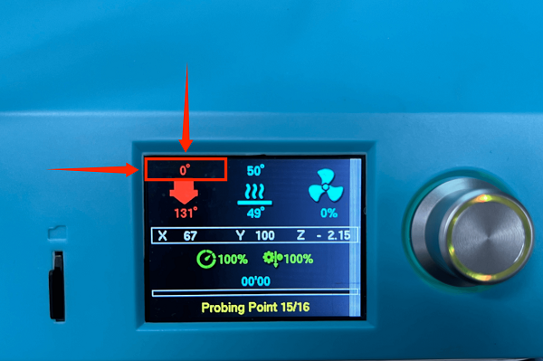

Abnormal temperature during automatic leveling
During automatic leveling, the preset temperature will switch back and forth between 140 degrees and 0 degrees, which is normal.

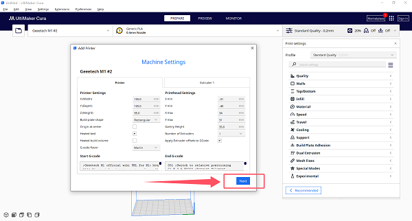

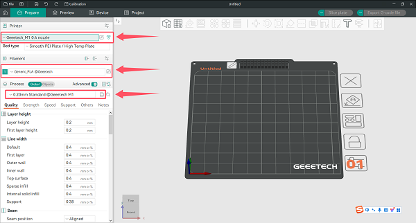

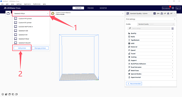

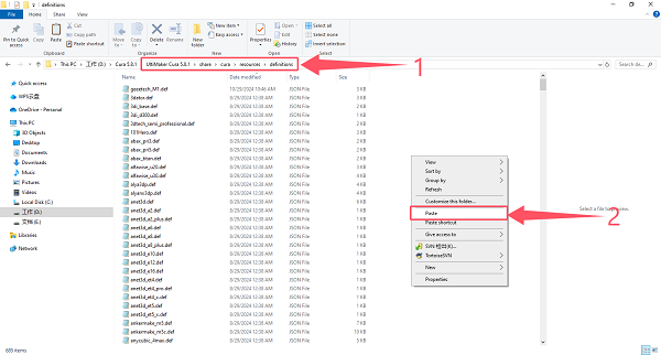

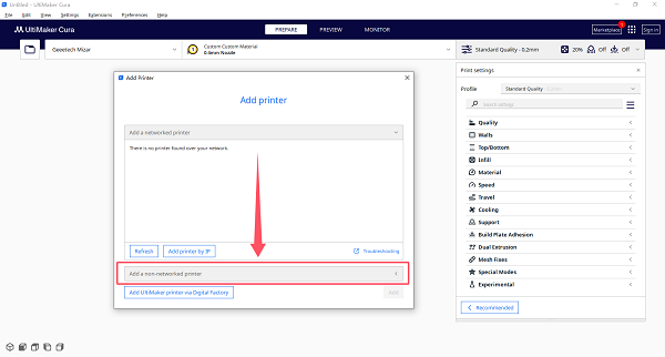

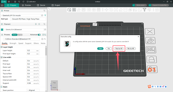

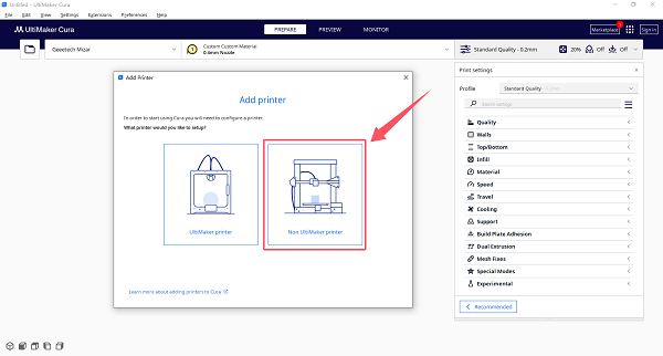

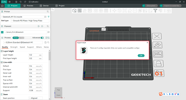

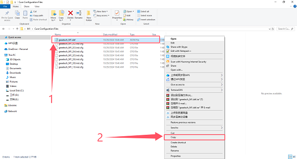

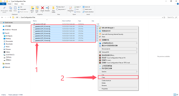

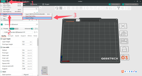

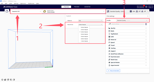

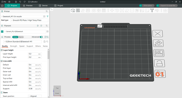

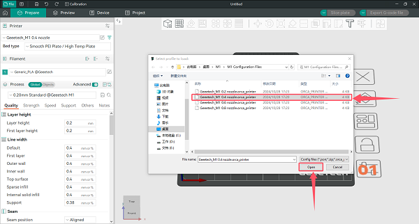

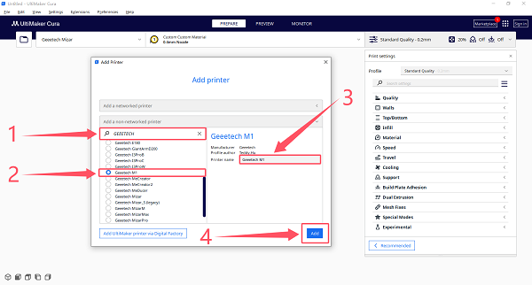

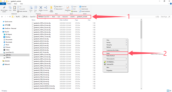

How to Import Profiles into Cura
First you need to download the Mozi configuration file, then follow the steps below to import the configured Mozi configuration file
M1 Cura Configuration Files
1、 Copy the geeetech M1.def file. Note that you are copying the .Json file. Please do not copy the wrong file.
2、 Open the location of the Cura slicing software and copy the geeetech_M1.def.json file to the target path:
\UltiMaker Cura 5.x.x\share\cura\resources\definitions
3、Copy all the configuration files in the picture
4、 Open the location of the Cura slicing software and copy all geeetech_M1.inst.cfg files to the target path:
\UltiMaker Cura 5.xx\share\cura\resources\variants\geeetech_variants
5、 Open the Cura slicing software and follow the steps below
6、 After the import is successful, select the M1 printer in the printer options and carefully check whether the parameters have been imported successfully.
How to import configuration files into Orcaslicer
Special statement:If you update Orcaslicer to V2.2.0, there is a pre-configured M1 printer, which can be directly selected without importing printing parameters.
As shown in the figure below, click Add Printer and search for GEEETECH to find it.
If your Orcaslicer does not have an M1 printer, you need to manually import the slicing parameters. The steps are as follows:
First, you need to download the Mozi configuration file, and then follow the steps below to import the configured Mozi configuration file
M1 Orcaslicer Configuration Files
1、 Open the Orcaslicer slicing software
2、 (1) Click File in the upper left corner
(2) Click Import
(3) Click Import Configs...
3、 Select the downloaded Mozi configuration file and click Open
4、 Click Yes for all
5、 A pop-up window will show that the Mozi slicing parameters have been successfully imported
6、 In the printer, select the M1 printer to see if the import is successful
7. Note: Orcaslicer can only import one configuration file at a time. If you need to import other nozzle configuration files, just follow the above steps and import them one by one.

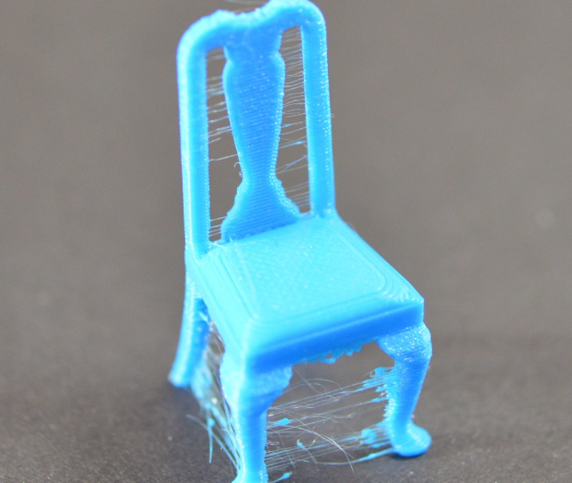

The print is brushed or leaked
The drawing is the residual linear object left when the extruder crosses the open space. The common measure to solve this problem is to control the "withdrawal" function in the slice software. If the tap is opened in the slice, the consumables will be pulled back in the opposite direction for a distance before the sprinkler head is moved to the next point. When the product moves to the next point, the consumables will be squeezed out again. Although theoretically, it can be avoided, there are several problems in practice:
1. Insufficient withdrawal distance The most important setting in the return is the return distance, which determines how much plastic is drawn from the nozzle during the return. Usually, the more plastic the draw from the nozzle, the less obvious the drawing is.
2. The withdrawal speed is too slow Another important setting in the withdrawal is the speed of the withdrawal, which determines how fast the consumables are withdrawn. If the pump rate is too slow, the melted supplies will still flow out of the nozzle. If the withdrawal is too fast, the separation of the unmelted part and the melted part of the consumables may occur, or the extrusion wheel may bite off a piece of the consumables.
3. The temperature is too high If the temperature of the extrusion head is too high, the consumables in the nozzle will become very sticky, and it is easy to flow out of the nozzle, but if the temperature is too low, the consumables are more difficult to squeeze out. In the determination of the drawing distance and drawing speed are more appropriate, there is still a drawing situation, you can try to reduce the temperature of the extrusion head by 5-10 degrees Celsius.
4, the suspended movement distance is too long The suspended distance will also have a great impact on the drawing. The short distance movement, the melted consumables do not have enough time to flow out of the nozzle, but the long distance movement is very easy to produce the phenomenon of drawing. Some slicing software has relevant Settings, which can avoid the long distance movement.

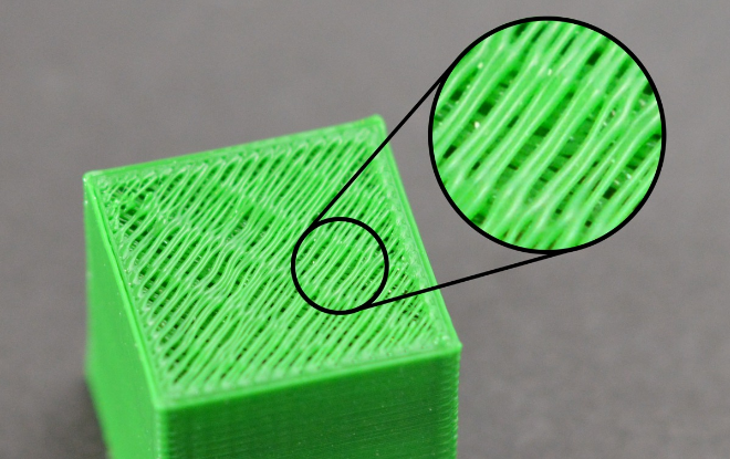

The top-level seal is insufficient
In order to save printing materials, most 3D printers will use different filling methods for the internal space, the commonly used ratio is 20% -30%, that is to say, in the closed product interior, only 20% -30% of the material, in this case, the work can still maintain a certain strength. However, in some of the works, users will find that some of the works are not perfect, and even have holes or gaps. If you encounter this problem, here are a few simple Settings, you can adjust and fix it.
1. Top layers When the number of capped layers is insufficient, it is easy to lead to the phenomenon of material falling, and the number of layers can be increased accordingly;
2. The filling rate is too low Too much reduction of the filling material, will make the internal space is too large, resulting in the number of upper layers can not be effectively supported, it is suggested to increase the internal filling ratio;
3. Insufficient extruding materials of the extruder Due to the lack of extrusion material, the nozzle can not meet the expected requirements, which can be adjusted by adjusting the extrusion amount.

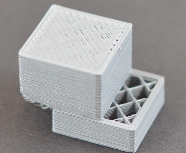

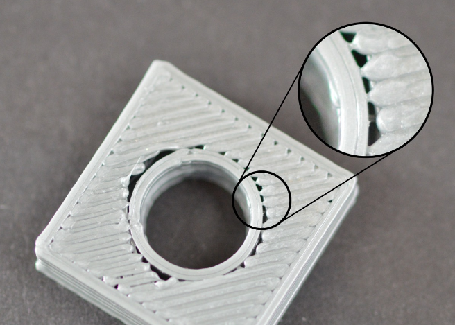

There are gaps between the edge and the filling
1. Insufficient edge overlap (overlap) Edge overlap refers to how much the fill overlaps with the internal edge. If you have 20%, try to 30% or more
2. Printing speed is too fast Usually, the fill is much faster than the edges. Too fast filling speed, will let the filling and edge are not enough time to combine. If you change the overlap and the problem isn't solved, try to reduce the printing speed to 50%. If the problem is solved, you can slowly increase the speed until you find the most suitable printing speed for your printer.

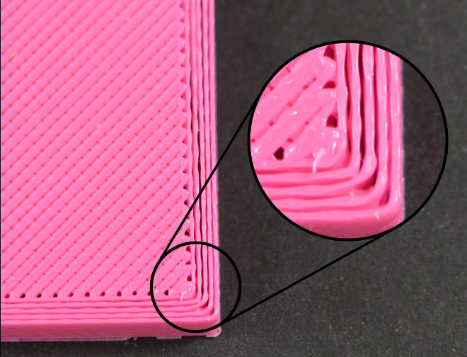

Rough edges and corners
This problem is mainly caused by the heat dissipation is not fast enough. After the high temperature supplies are extruded from the nozzle, they will change their shape in the process of slow cooling. If this problem occurs in the very beginning of the printing, you can refer to the "first layer off-platform problem" mentioned earlier

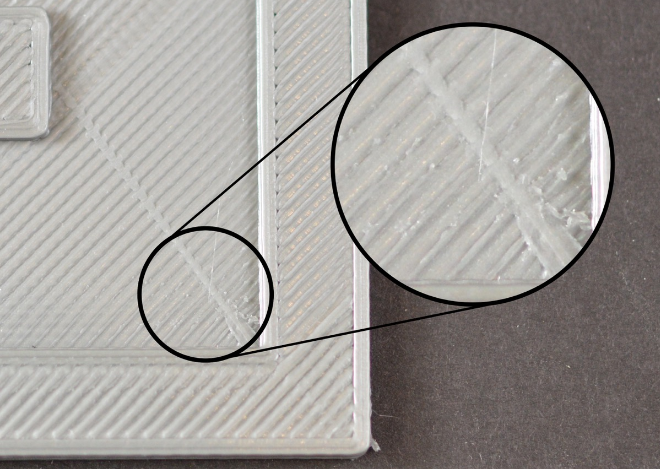

Top layer surface scratch problem
1. Too much plastic extrusion Encounter the problem of scratches, the first thing to check is, is too much consumables extrusion. If the supplies are squeezed out, each layer is thicker than the set size, which means the scratches form when the nozzle moves through. The solution to this problem can refer to the aforementioned "more consumables"
2. Vertical lifting If you are sure your consumables quantity is correct, but still scratch problems, so you can open in slice software "vertical lift" option, this option will make the machine in back, print head up a certain distance, and then move to the next coordinates, then move down back to the original height, continue to print. It's important to note that the print head will be raised vertically only in places where there is a tap. If you want to make sure that each pass has a vertical lift, make sure that the "draw only when crossing open space" and "minimum distance" options are closed.

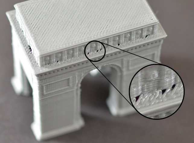

Holare holes in the bottom of the corner linet
This problem often occurs in the situation where the upper level is smaller than the lower level. The following provides several possible causes and solutions to this problem: 1. Insufficient number of edges You can try increasing the number of edges by two; 2. The number of top layers is insufficient You can try to add the top layers by two layers; 3. The filling ratio is too low You can try to increase the fill ratio by 20%.

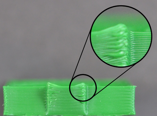

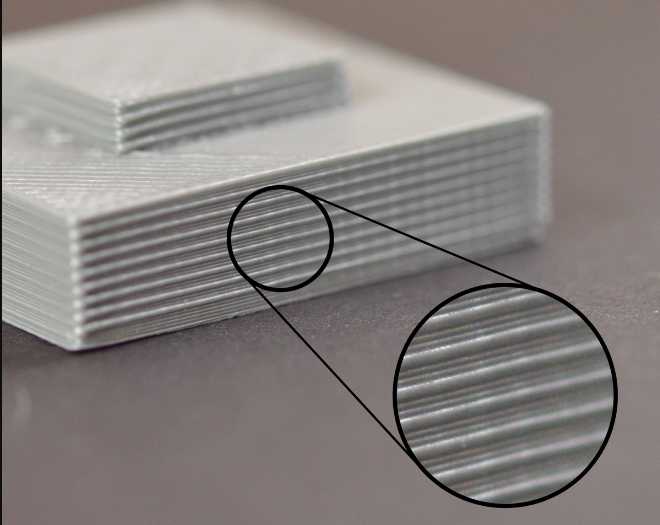

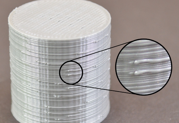

The side edges are uneven
The side of a printed piece is like a thousand-layer cake. In all normal cases, the side of the printed object should look like a smooth surface. Instead of showing the obvious edges, the following are several possible causes and suggested solutions:
1. The extrusion volume is inconsistent Usually this reason is because the tolerance control of the mass line diameter of consumables is not strict. If the line diameter change of your consumables is about 5%, then the extrusion volume change of consumables is as much as 0.05mm. Of course, there are some other possibilities for the inconsistent extrusion quantity, which will be explained in detail in the following "inconsistent extrusion quantity"
2. Temperature change Most 3D printers use PID to control the printing temperature. If the PID setting is not good, the printing temperature will fluctuate up and down (when the temperature rises, the liquidity of consumables is better than when the temperature is low), and the printing temperature fluctuation will affect the extrusion volume. Then, the problem of uneven side edge is generated. A fixed PID control can maintain the printing temperature within 2℃ up and down. If this range is exceeded, the PID needs to be rearranged.
3. Mechanical reasons If you can be sure it's not either, it's probably mechanical. For example, when printing, the printing platform shaking and vibration may lead to the position change of the nozzle, which will lead to inconsistent layer thickness, and thus produce the problem of uneven side edges. Another example: mechanical position or motor differential control problem. Even the small offset of the printing platform can affect each layer of the printed object.
