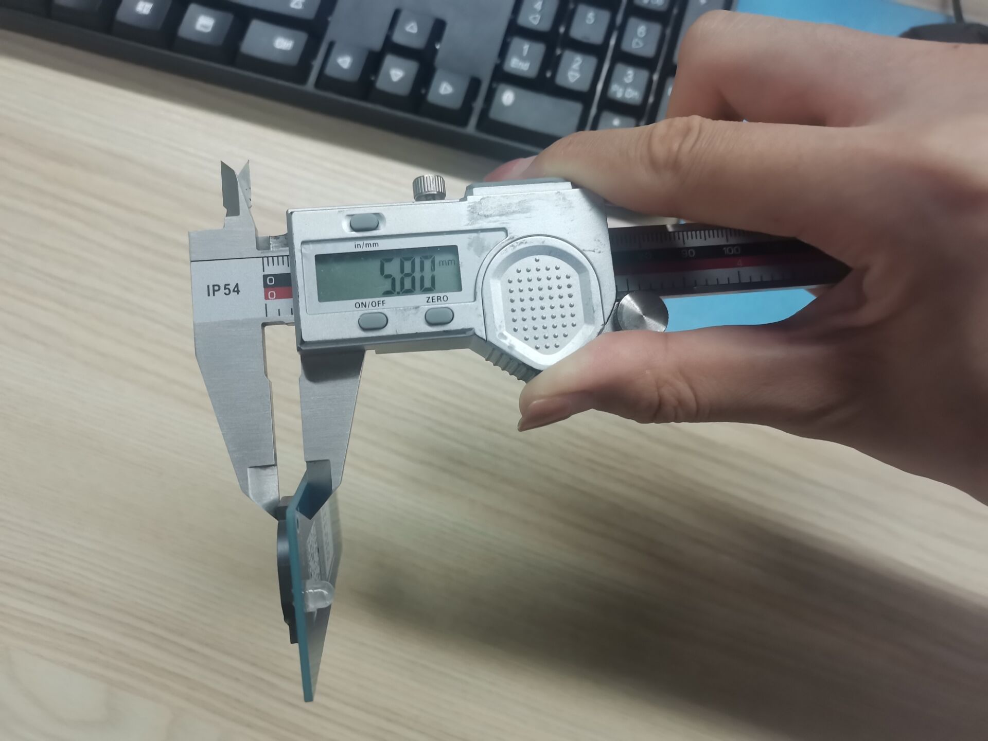

2.If you feel that the nozzle scratches the plate, you can measure the data below and then change the data in the red box to increase the value of offset.
