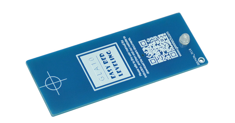

GEEETECH GLA10 3D Printer Leveling Auxiliary Tool

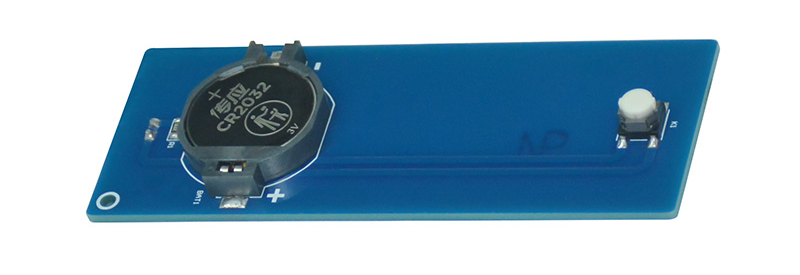

1. Insert the attached CR2032 battery in the battery holder on the GLA10. Please be careful not to install the wrong positive and negative poles when installing the battery.

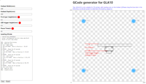

2. GCode generator for GLA10
  Please click the link  https://www.geeetech.com/specialpage/GCode_generator_for_GLA10.html
We provide the corresponding G-codes for different hotbed sizes.Please edit the relevant information in the leveling Gcode generator.
3. Please copy or export the leveling Gcode to the Micro SD card.

2. After the leveling starts, the nozzle of the printer will automatically lift a certain distance. At this time, please place the end of the GLA10 with a cross pattern under the nozzle, and ensure that the nozzle is directly above the cross pattern of the GLA10.
3. At this time, please press and fix the other end of the GLA10 with one hand, and then quickly adjust the bot bed leveling nut corresponding to the current position of the nozzle with the other hand. When you see the green LED on the GLA10 just lights up, it means the current height of the hot bed is just right. Now, please take out the GLA10 and wait for the hot end moving to the next point. Pay attention that the GLA10 just lights up at all four corners of the hot bed.

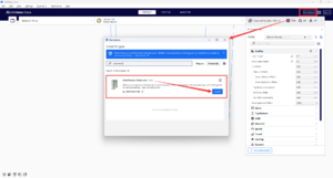

1.Please install the Cura slicing software (https://ultimaker.com/software/ultimaker-cura/#downloads)
install Cura
2.Please open the Cura slicing software and install the "Auto towers" plug-in in the Cura "Marketplace" plug-in market, and then restart Cura.
install plug-in

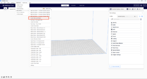

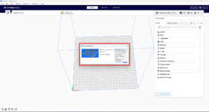

3.Please find the submenu "Auto Towers" in the Cura main menu "Extensions" ,then click "Custom Bed Level Pattern" and select "Bed Level Pattern Type"according to your preference.

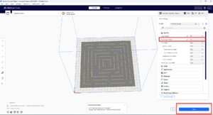

4.Please set the initial layer height and click "slice" to generate a leveling test Gcode.
slice
