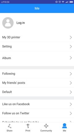

Here are the login steps.
Step1. Open EasyPrint 3D App. Click the [Click to log in] button in the [Me] interface to finish your registration.
Step 2. For beginners, click [Account] to register. Enter your own account information.
(Note: There is no space in the user name. For foreign users, please choose “English” for your server address.)
Step 3. Click [Register Now] and a pop-up interface will appear for your to check your email.
Step 4. Click OK and check your email. Log in with your account information.
