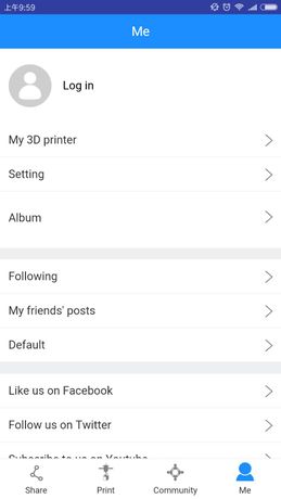

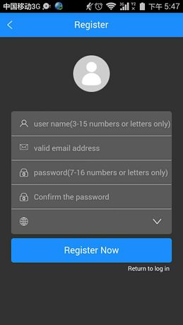

Step1. Open EasyPrint 3D App. Click the [Log in] button in the [Me] interface to finish your registration.
Step 2. For beginners, click [Account] to register. Enter your own account information.
(Note: There is no space in the user name. For foreign users, please choose “English” for your server address.)
Step 3. Click [Register Now] and a pop-up interface will appear for your to check your email.
Step 4. Click OK and check your email. Log in with your account information.

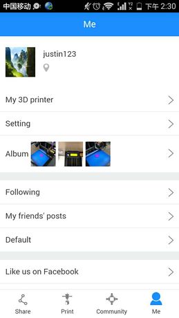

Log in and bind the printer. In [Me]—[My 3D Printer], finish the binding process following the instructions on App.

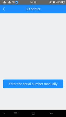

Step 3. Click the button in the picture below to enter the serial number manually.

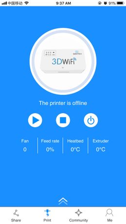

Step 5. Then you will see the following interface, showing that the printer is off-line.
That’s the whole binding process. In the next part, we will finish the Wi-Fi configurations step by step. Be patient~

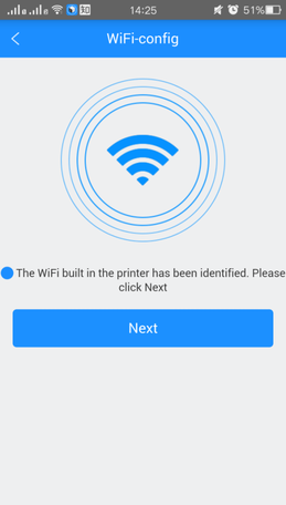

Step 5. Click [Next] to start to detect Wi-Fi built in the printer. If the Wi-Fi is detected, you could see the following picture.
If not detected, it will pop up a prompt “Printer Wi-Fi is not detected”. Click [OK] and again click [Next] to redetect.

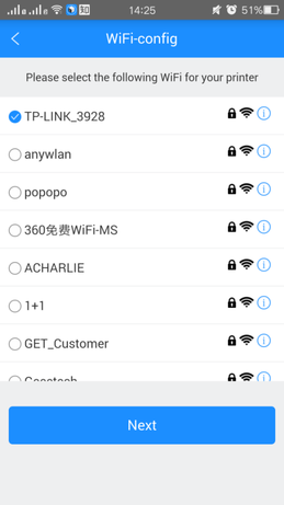

Step 6. After detecting the Wi-Fi built in the printer, click [Next] and choose a Wi-Fi hotspot, as shown in the picture below.

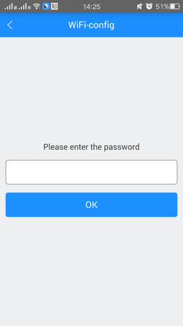

Step 7. Click [Next]. If the Wi-Fi hotspot needs password, the interface will show the Wi-Fi password input box. Just input the correct password, and then click [OK], as shown in the picture below.
If there is no need to input the password, please continue with the next step.

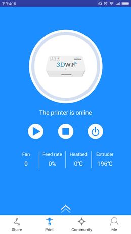

Step 8. When you succeed in connecting the Wi-Fi, the interface will show that the configuration is finished. Click [OK] and the interface will show that the printer is on-line.
Till here, the configuration between App and your printer is finished. Now you can print and control the printing via EasyPrint 3D App.

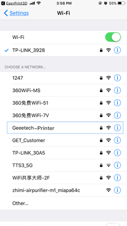

Step 6. Click the Wi-Fi button to connect “Geeetech-Printer” hotspot, as shown in the picture.

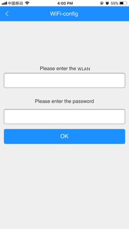

Step 8. Enter the WLAN name and password of your router. Click [OK] to connect your Wi-Fi.
Step 9. When you succeed in connecting the Wi-Fi, the interface will show that the configuration is finished, as shown in the picture below.
