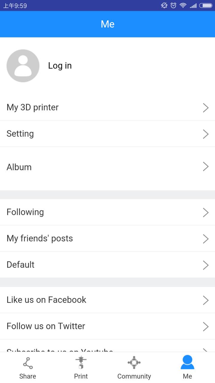

Here are the login steps.
Step1. Open EasyPrint 3D App. Click the [Click to log in] button in the [Me] interface to finish your registration.

Step 6. After detecting the Wi-Fi built in the printer, click [Next] and choose a Wi-Fi hotspot, as shown in the picture below.
Step 7. Click [Next]. If the Wi-Fi hotspot needs password, the interface will show the Wi-Fi password input box. Just input the correct password, and then click [OK], as shown in the picture below.
If there is no need to input the password, please continue with the next step.
Step 8. When you succeed in connecting the Wi-Fi, the interface will show that the configuration is finished. Click [OK] and the interface will show that the printer is on-line.
Till here, the configuration between App and your printer is finished. Now you can print and control the printing via EasyPrint 3D App.
  • Note:
For iOS users: The configuration steps are a little different from the Android version from Step 5.
Step 5. Click [Next] to start to detect Wi-Fi built in the printer. If the Wi-Fi is detected, you could see the “Settings”interface on your phone.
Step 6. Click the Wi-Fi button to connect “Geeetech-Printer” hotspot, as shown in the picture.
Step 7. Click the [Next] button in the picture below.
Step 8. Enter the WLAN name and password of your router. Click [OK] to connect your Wi-Fi.
Step 9. When you succeed in connecting the Wi-Fi, the interface will show that the configuration is finished, as shown in the picture below.
Step 10. Click [OK] and the interface will show that the printer is on-line.
