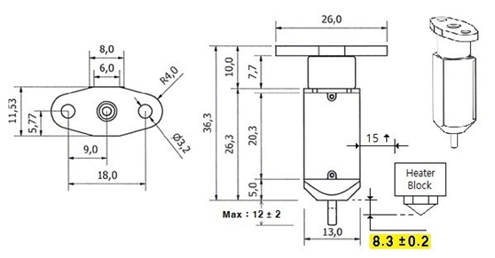

=Dimension=
[[File:3DTouch dimension.png]]

Mechanical
You will need a suitable mount to attach the 3DTouch sensor to your printer.
Thingiverse also has mounts for many other printer types.here are some examples
Example 1
Example 2
The mount needs to be adjustable so that the distance between the bottom of the sensor (not the pin) needs to be 8.3mm above the tip of the nozzle. The sensor should also be at least 15mm away from the hot bits.
