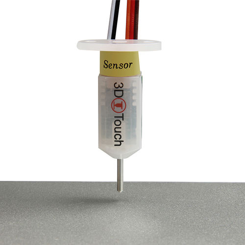

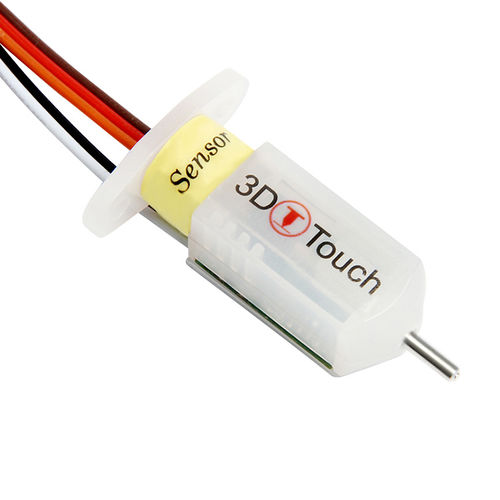

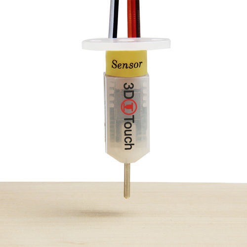

3DTouch is an auto leveling sensor for 3D Printers that can precisely measure the tilt of your print surface. 3DTouch can greatly improve the printing precision of your 3D Printer.
3DTouch features simple, smart and precise. It could work with nearly any kind of bed materials, such as glasses, woods, metals and so on.The main functions and controls of 3DTouch are the same as most auto bed leveling sensors, which consists of a RC servo and a micro switch.Thus,3DTouch can be used on almost every 3D printer control board.
By using progressively designed solenoid and hall sensor, 3DTouch can integrate high precision in such a simple structure. To make it more user-friendly and to bring you more enjoyable printing experience we add many smart functions such as self-test, false alarm, alarm release and test mode for M119.

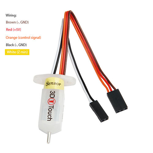

Wiring
3-pin: Brown (-, GND) Red (+5V) Orange (control signal)
2-pin: Black (-, GND) White (Z min)

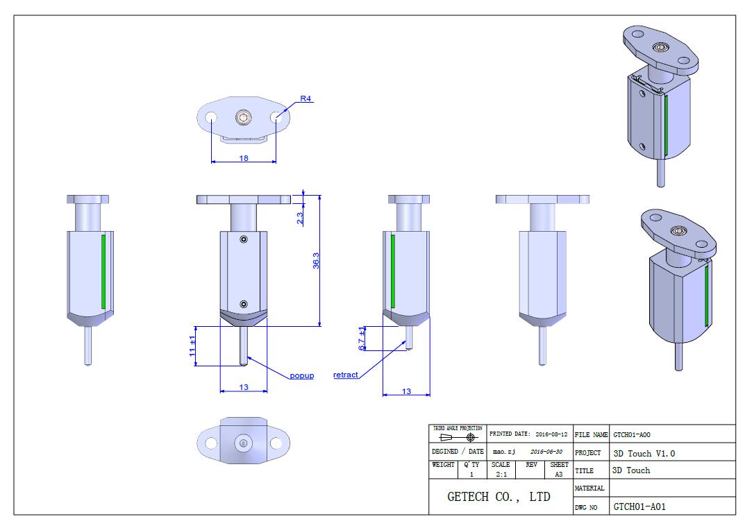

Dimension

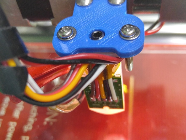

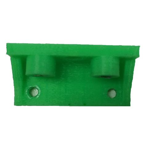

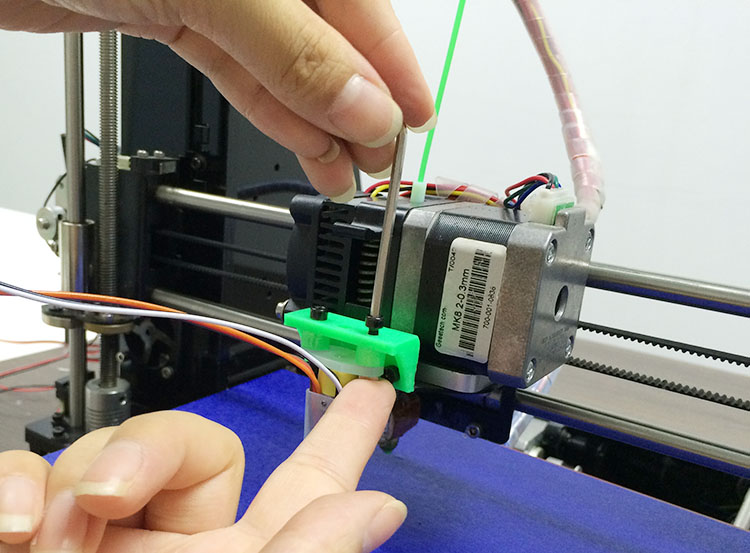

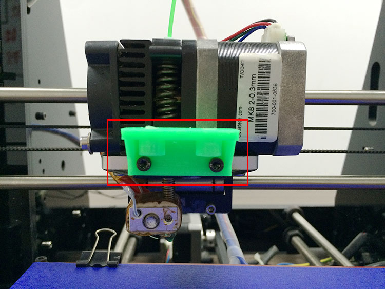

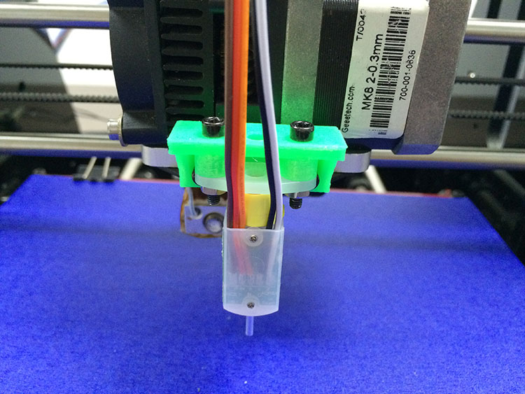

You will need a suitable mount to attach the 3DTouch sensor to your printer.
Here is a 3DTouch sensor mount for Geeetech Prusa I3 pro B, pro C and A pro.
1. Download the stl file here and print one.

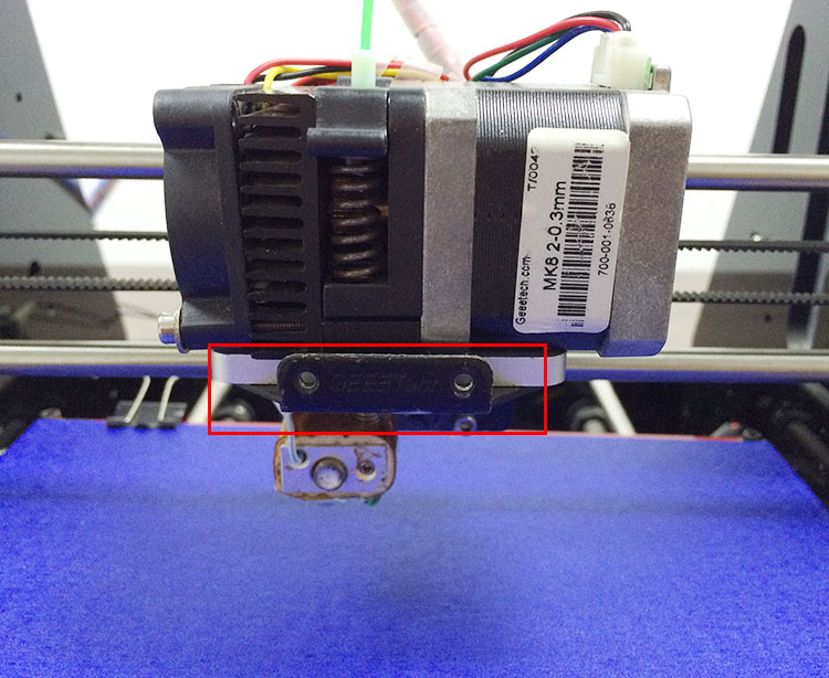

2.Fix the mount on the Extruder holder with 2 M3*6mm screw.
3.Fix the 3DTouch sensor on the sensor mount with 2 M3*16mm screws and 2 M3 nuts.

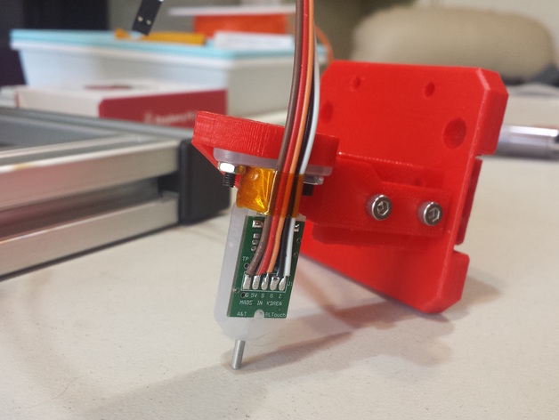

Thingiverse also has mounts for many other printer types.here are some examples
Example 1
Example 2
The mount needs to be adjustable so that the distance between the bottom of the sensor (not the pin) needs to be 8.3mm above the tip of the nozzle. The sensor should also be at least 15mm away from the hot bits.

The 3DTouch Auto Leveling sensor has 5 wires, 3 for the first servo connection and 5v and 2 for the Z min end stop, negative and signal pins.
3DTouch can be operated in the following condition.
One I/O for control (PWM or Software PWM)
One I/O for Z min (Z Probe)
GND and +5V power

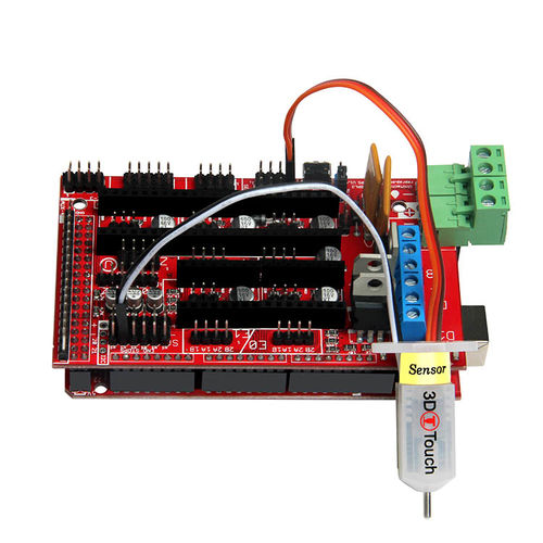

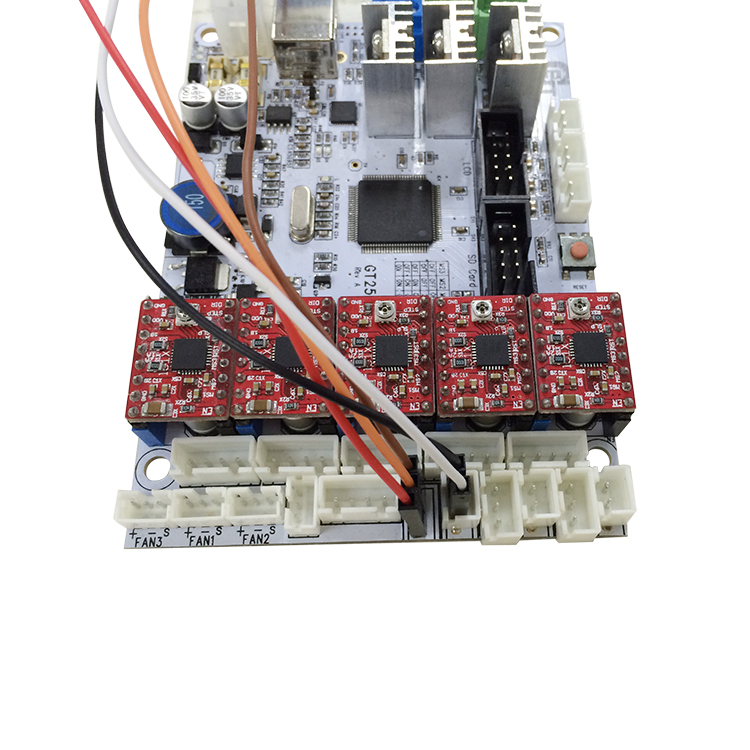

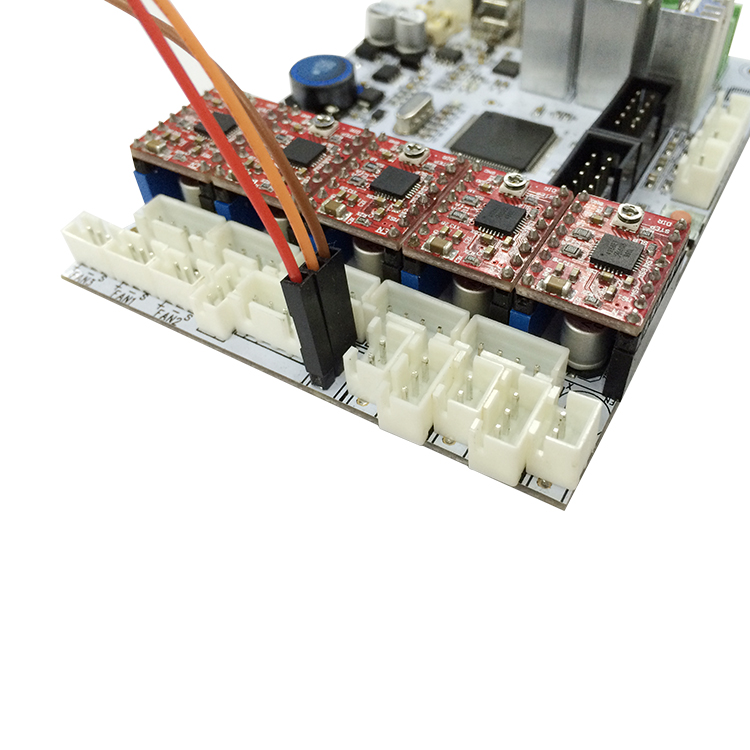

let's take our geeetech GT2560 3D Printer control board as an example.

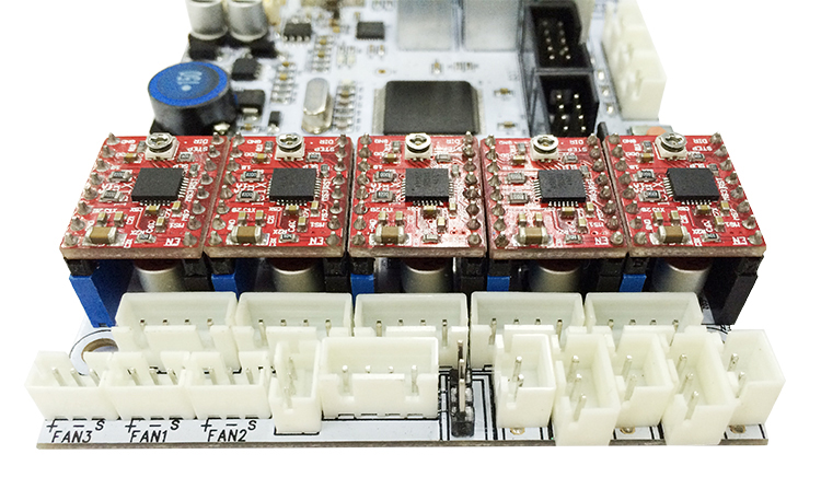

There are several ways to connect the 3DTouch Auto Leveling sensor to GT2560, here is the easiest way.

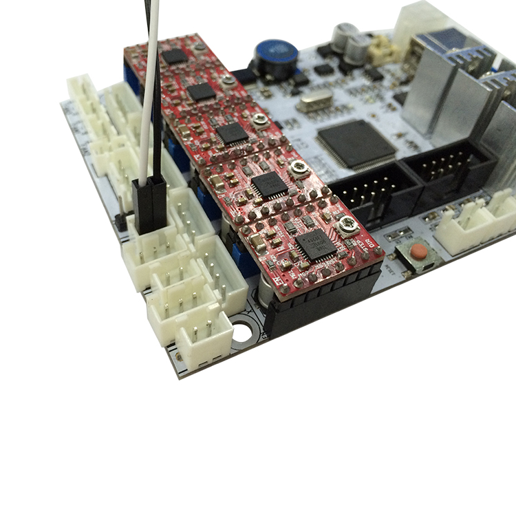

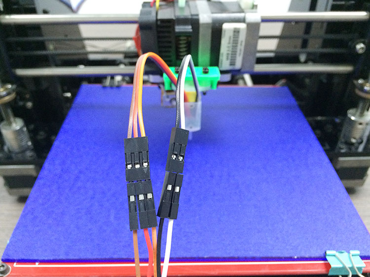

step 1. Remove the Z max connector from the board and replace it with a 3Pin Straight Pin.You need to use soldering iron here.
step 2. Use Dupont wire to extend the wires of 3DTouch. It doesn't matter if you cannot find the wires with the same color,but do not mix the wires up.
step 3. Connect the extended wire to the GT2560 control board.
Connect the 3 pin wire to the Z max pin.
Connect the 2 pin wire to the Z min pin.
Note the wire order.
  • When using 3DTouch Auto Leveling sensor, you do not need to connect the orignial Z min endstop wires.
That's all for the wiring of the 3DTouch Auto Leveling sensor and GT2560.

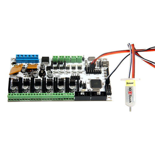

3DTouch Auto Leveling sensor can aslo be used to other 3D printer control board. For example:
  • Ramps1.4
  • Rumba

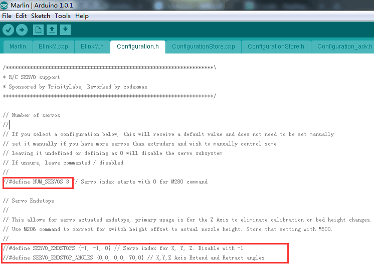

Changes need to be made for the configuration.h file in the Marlin source code for 3DTouch. The required changes are similar to how you would setup a mechanical servo sensor.
Step1. Open your firmware in Arduino IDE. Find the following code in Configuration.h: Modify the code in the red box into:
// Number of servos
// If you select a configuration below, this will receive a default value and does not need to be set manually
// set it manually if you have more servos than extruders and wish to manually control some
// leaving it undefined or defining as 0 will disable the servo subsystem
// If unsure, leave commented / disabled
#define NUM_SERVOS 1 // Servo index starts with 0 for M280 command
// Servo Endstops
// This allows for servo actuated endstops, primary usage is for the Z Axis to eliminate calibration or bed height changes.
// Use M206 command to correct for switch height offset to actual nozzle height. Store that setting with M500.
#define SERVO_ENDSTOPS {-1, -1, 0} // Servo index for X, Y, Z. Disable with -1
#define SERVO_ENDSTOP_ANGLES {0,0, 0,0, 10,90} // X,Y,Z Axis Extend and Retract angles

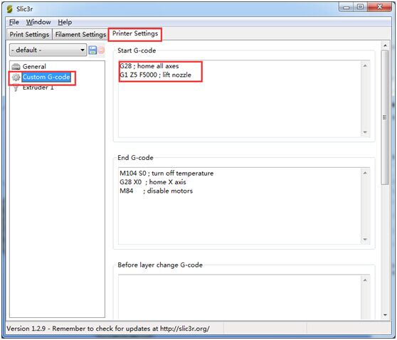

Printer setting

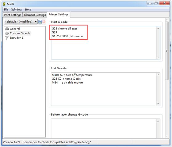

Providing the firmware is correctly configured, the sensor responds to the same codes as any other sensor eg inductive, capacitive or IR. The Start Code in you slicer should contain the sequence G28 followed by G29 to do the auto bed levelling.
  • Don’t put another G28 after the G29 as it will just remove the G29 results.
Open Slicer>printer setting
Add G29 command right after G28
The G29 command should be added every time.
