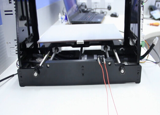

Mount the building platform.
Required parts Part ID Required number
Thermometry & Heating wire

2) Connect wires for Y-axis motor.
3)Connect wires for the 2 Z-axis motors.
4) Connect Extruder motors
Connect extruder 0.
Connect extruder 1,if you are assembling the dual extruder model.
Step2. Connect heating wires.
1) Connect heating wires for heatbed.
There are 4 heating wires for the heatbed, 2 black and 2 red, you need to connect the 2 red wires in one screw and the 2 black wires in another.
First loos the screws in the green terminal and put the red and black wires into the slot separately, and screw it up.
  • There is no “+” and “-“ polarity for heating wires
2) Connect heating wires for hotend 1.
Step3. Connect wires for thermistor.
