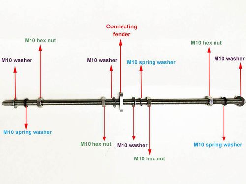

Assemble the threaded rods of Y axis
Required parts Part ID Required number
450mm threaded rod
No.5
2
M10 washer
No.9
8
M10 hex nut
No.13
8
M10 spring washer
No.10
6
Connecting fender
No.A14
2
Thread the nuts and washers into the two M10 threaded rods separately. The order should be:
Watch the Video here.

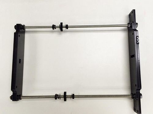

Assemble the front and back support of Y axis
M10 washer
No.9
4
M10 hex nut
No.13
4
Y axis front support
No.A9
1
No.A10
1
Y axis rear support
No.A11
1
Y axis rear support
No.A12
1

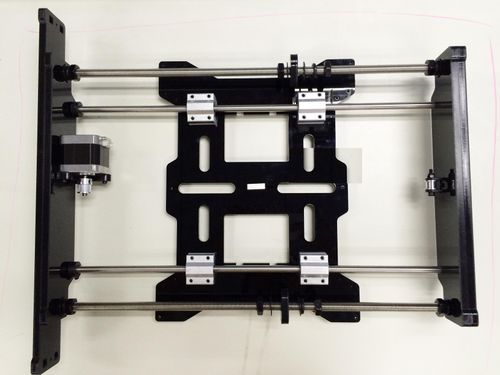

Thread the plate to both end of the threaded rod in the following order:2
Front outside support plate: No.A9
Front inside support plate: No.A10
Rear outside support plate: No.A12
Rear inside support plate: No.A11
Screw up the threaded rods and support plates with M10 nut and M10 washer at both end. Hand tighten the M10 Nuts against the M10 Washers. Try to keep the rods parallel and the four acrylic pieces parallel.
  • Tips:
the Y-axis must be a rectangle, that is the rods on both side should be parallel, so is the front and back plate. Otherwise it will cause obstruction for the belt later.
You can watch the video here.

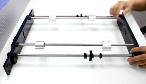

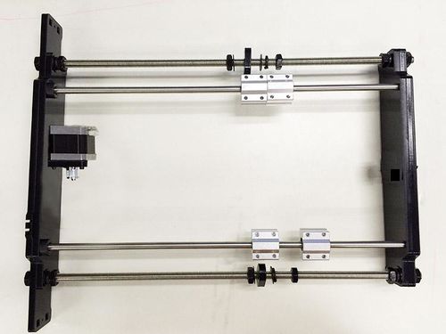

Thread the smooth rods and linear bearings.
SCS8UU Linear Bearing
No.39
4
420mm Smooth rod
No.3
2
locking ring
No.37
2
Thread the smooth rod into the Y axis support plate from rear to front, and thread the locking ring and 2 SCS8UU Linear Bearing on the smooth rod in turn.
Screw up the locking ring
watch video here

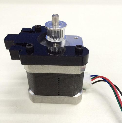

Mount the Y motor
stepper motor
No.65
1
Y motor holder
No.A13
1
M3 x12mm screw
No.25
3
M3 x 20mm screw
No.27
2
M3 washer
No.7
5
M3 square nut
No.17
2
Pulley
No.45
1

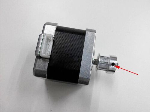

Step1. Mount the pulley on the motor shaft, one of the screws should be screwed on the cross section of the shaft. Screw it tightly.
Step2. Then screw the motor on the Y motor holder with 3 M3 x 12 screws and M3 washers.
Step 3. Push the Y Motor holder tab into the square hole in Rear -Outside Plate and Rear - Inside Plate. You may need to use a little force, but be careful not to break or crack any of the Acrylic pieces. Secure the Y Motor holder with 2 M3x20 mm Screws , 2 M3 Washers and 2 M3 Square Nuts.

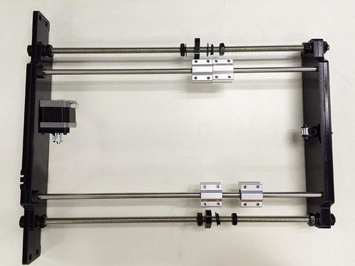

Y belt driving wheel
Driven wheel holder
No.42
1
Driven wheel
No.43
1
R84zz Ball Bearing
No.44
2
M3 x20mm screw
No.27
1
M4 x 25mm screw
No.35
1
M3 washer
No.7
1
M4 washer
No.8
1
M4 lock nut
No.14
1
wing nut
No.15
1
Step1. Thread the M3 x 20 screw and M3 washer through the Driven wheel holder .
Step2. Insert the two MR84zz ball bearings into both ends of the driven wheel.
Step3.Put the M4 x25 screw and M4 washer through the driving wheel. Lock the other end with a M4 lock nut. You may need a wrench to tighten locking nut.
*Do not screw it too tight, you should leave enough room for the wheel to turn freely.
Step4. Mount the assembled bearing holder onto the front support plates. And screw it with a wing nut.
Look at this picture, the driving wheel and the pulley should be in a straight line. You can refer to the video here.

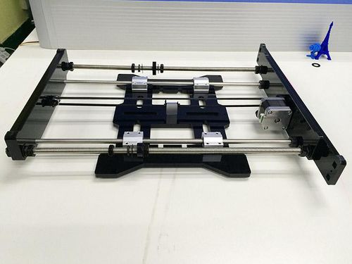

Build the print platform
Building platform support
No.A15
1
Belt mount
No.38
1
M3 x12mm screw
No.25
2
M4 x 16mm screw
No.34
16
M3 washer
No.7
2
M4 washer
No.8
16

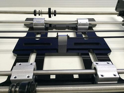

Step1. Mount the belt mount at the middle of the building platform support with 2 M3 x12mm screws and M3 washers.
Step2. Mount the the building platform support on the 4 SCS8UU linear bearings on the rod with M4x16mm screws and M4 washers
  • Note the direction of the building platform support, you can judge from the direction of the belt mount, whose direction is corresponding to the Y axis.

Step1. Punch a M2.5 hole on one end of the belt (the hole can be as the diameter of the M2.5 screw , leave enough margin)
Step2. Fix the belt on one side of the belt -mount with a M3 x 8 screw and washer(.
Step3. Thread the belt around the pulley on the motor and the driving wheel.
Step4. Taut the belt to determine the length of the belt, punch another hole and and fix the other end of the belt mount with a M3 x 8 screw and washer.
Step5. Cut off the rest of the belt
  • Tips:
1. Before you drill your second hole, make sure to pull belt tightly to find the  proper placement of hole for a tight belt, if it is too loose, it will hinder the move of the print platform.
2. Loosen the Y idler wing nut when tightening belt onto the Y belt mount  in order to make securing the belt to the block easier. Be sure to tighten wing nut fully  once done.
3.The belt should be vertical with the Y axis support plate.
Watch the video here.

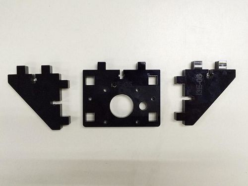

Motor holder
No.A5
1
Motor Holder support
No.A6
2
Step1. Assemble the 2 A6 and A5 together, screw up with 3 M3 x 16mm screw ,M3 washer and M3 Square nut .
*Note the direction of the A5,the small round hole is on the right.
Step2. Fix the assembled motor mount on the right-bottom of A1 with M3 x 16mm screw, M3 washer and M3 Square nut.
  • Be very careful here, if you can not insert it into the hole you can loose the screw on the motor mount and try again.

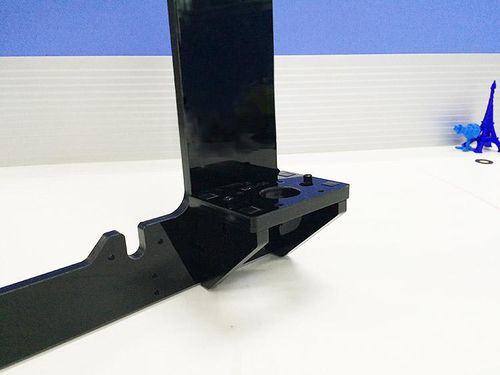

Left Z motor mount
M3 x 16mm screw
No.26
5
M3 Square nut
No.17
5
M3 washer
No.7
5
Motor holder (left)
No.A4
1
No.A6
1
No.A7
1
Main frame
No.A1
1
Step 1. Insert the A6 and A7 into A5, note the detail:A7 is on the left and A6 is on the right.
*Note the direction of the A4,the small round hole is on the left.
Step 2. Fix the assembled motor mount on the left-bottom of A1 with M3 x 16mm screw, M3 and square nut.
  • Be very careful here, if you can not insert them into the hole you can loose the screw on the motor mount and try again.

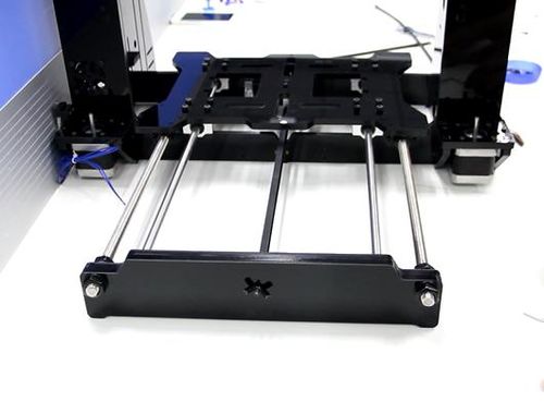

Step 1. Put the assembled Y axis into the main frame, put the main frame between the connecting fender and the M10 nut. The Connecting fender is at the front part of the Y axis.
Step 2. Connect the side panel to the rear support plate, screw it up with M3 x 16mm screw,M3 washer and M3 square nut.
Step 3. Fix the connecting fender to A1 with M3 x 20mm screw, M3 washer and M3 hex nut.

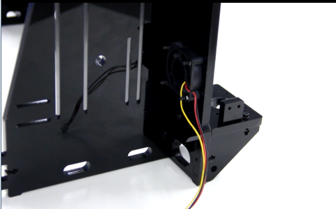

Fan mount
M3 x 25mm screw
No. 28
4
M3 hex nut
No. 12
4
M3 washer
No.7
6
Fan
No.51
1
Mount the fan on the BACK of the left side of the A1. Fix it with 4 M3 x25 mm screw, M3 washer and 4 M3 hex nut.
*Note the direction of the fan, the side with wires is at outside. The fan is for the heat dissipation of the control board.

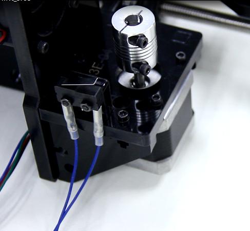

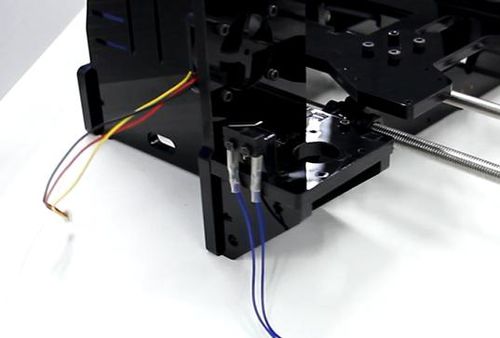

Mount the Z endstop
M2.5 x 16mm screw
No. 21
2
M2.5 hex nut
No. 11
2
End stop
No.54
1
Mount the endstop on the outside of A7 with M2.5 x 16mm screw and M2.5 hex nut

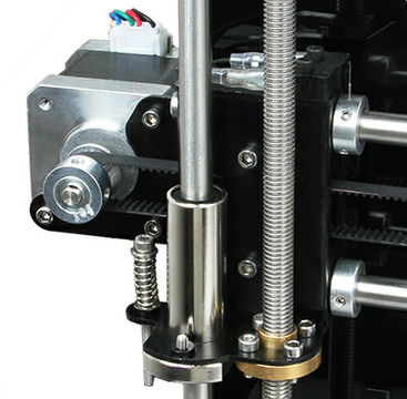

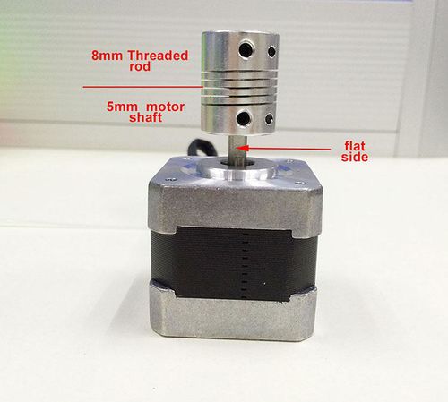

Mount the couplings
Coupling
No.48
2
Step 1. Fix the two couplings on the Z motor shaft separately. Please note:
1.The opening of both end, one is 5mm, another is 8mm, connect the 5mm hole to the motor shaft.Half and half. Screw it tightly.
2.The screw should be fixed on the cross section (the flat side) of the motor shaft.
Repeat the steps for another couplings.
*The bottom of the coupling is better to be leveled with No. A4.
watch video here.

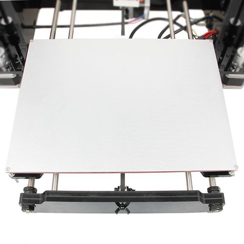

Mount the building platform.
Thermometry & Heating wire
No.58
1
Heatbed set
No.59
1
Building platform
No.60
1
wing nut
No.15
4
Hex Counter-sunk-head screw
No.19
4
Spring
No.36
4
Step 1.Stack the heatbed and the aluminum plate together with he aluminum plate above, the heat bed below.
Step 2.Connect the heatbed and the aluminum plate to the acrylic plate with 4 Hex Counter-sunk-head screw with the spring in between.
Step 3. Lock the screw with a wing nut .
watch video here.

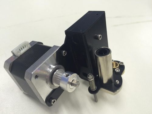

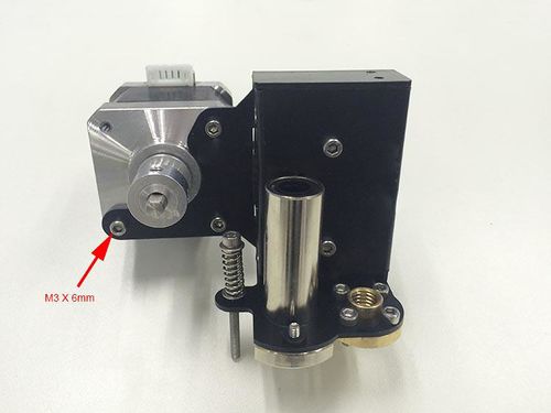

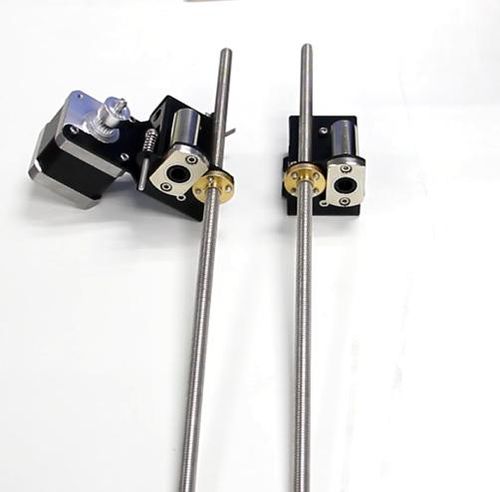

Assemble the left end of the X axis(motor end)

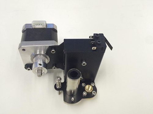

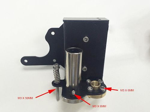

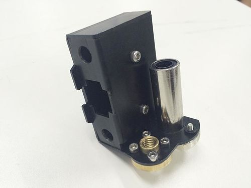

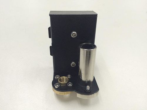

mount the Linear Bearing & Z-axis nut
Z-axis nut
No.16
1
X-axis motor end
No.M1
1
Linear Bearing LMH8LUU
No. 41
1
M3 x 50 screw
No.31
1
M3 x 6mm screw
No. 22
8
M3 washer
No. 7
2
Spring
No. 36
1
Step1. Mount the Z nut on the X-axis left end from bottom to up, fix with M3 x 6mm screws.

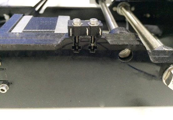

Step2. Mount the linear bearing on X-axis motor end from bottom to up. Fix it up with M3 x 6mm screws .

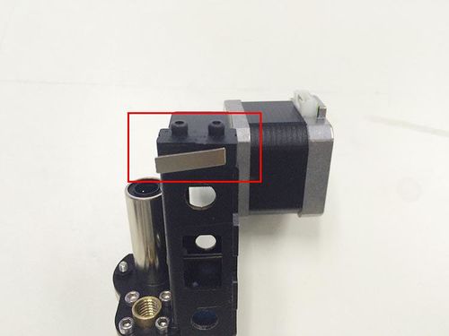

Step3. Mount the endstop trigger.
1.Thread a M3 washer> spring> M3 washer in order to the M3x 50mm screw.
2.Thread half of the M3x50mm screw into the screw hole.
mount the X motor
M3 x 6 mm screw
No.22
3
Stepper motor
No.65
1
Pulley
No.45
1
Step 1. Mount the pulley on the motor shaft. Screw it on the flat side.
Step 2.Mount the stepper motor on the motor end with 3 M3 x 6 mm screw.
Mount the endstop
M2.5 x 8 mm screw
No. 20
2
End stop
No.54
1
Mount the endstop on the top of X-axis motor end with two M2.5 x 8mm screw.

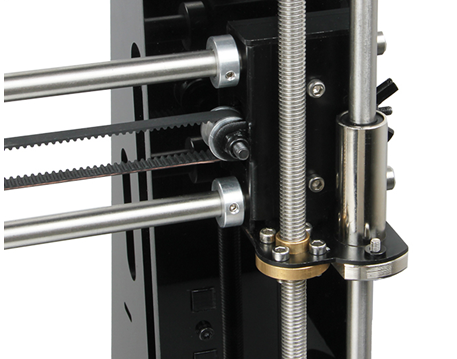

Assemble the right end of the X axis (X idler end)
For the whole process of assembly of this part, please refer to the video here.
Z-axis nut
No.16
1
X-axis idle end
No.M2
1
No. 41
1
M3 x 6mm screw
No. 22
8
Step1.Mount the Z axis nut on the bottom of X-axis right end with 4 M3 x 6mm screws.

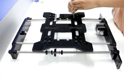

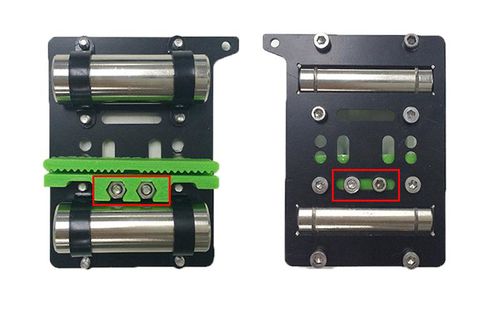

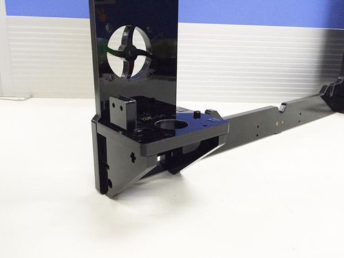

Assembly of the extruder carriage
X Carriage
No.M3
1
Bearing Bracket
No.M4
4
Extruder holder
No.M5
1
Linear BearingLM8LUU
No.40
2
Belt bracket
No.47
1
M3x6mm screw
No. 22
8
M3x12mm screw
No. 25
2
M4x6mm screw
No. 32
2
M3 nut
No.12
2

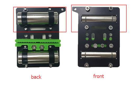

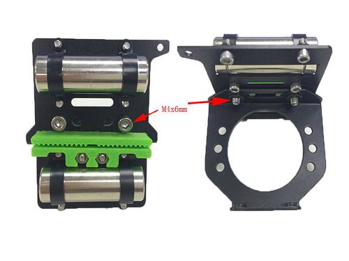

Step1.fix the 4 Bearing Brackets on the back of the X Carriage loosly with M3x6mm screws. Insert the linear bearing into the slot and screw the bracket tightly.
Please notice the front and back of the plate.
Step2.fix the belt mount on the back of the carriage with 2 M3x 12mm screws and M3 hex nuts.
Step2. Fix the extruder holder on the front side of the X carriage using M4x6mm screws.

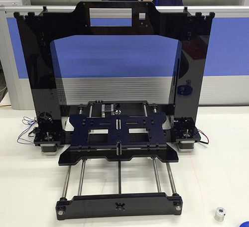

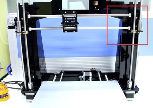

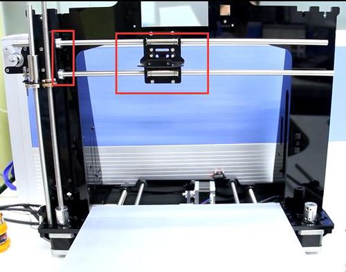

Assemble the the X&Z axis
L320mm threaded rod
No.4
2
L340mm smooth rod
No.1
2
L470mm smooth rod
No.2
2
locking ring
No.37
4

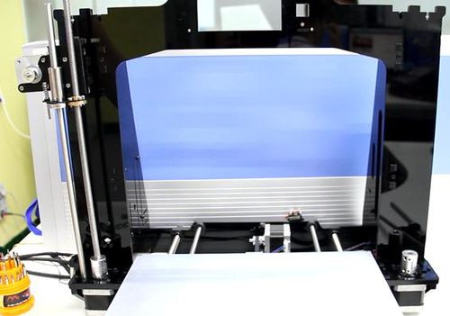

Step1. Thread the threaded rod to the nut of both end of X axis.
  • Keep both end of X axis at the same place of the rod, you are advised to measure the distance of the both side so that they are at the same level when you put them up.
Step2. Plug the threaded rod on the X motor end to the left coupling on the left bottom of the Z axis. Then thread the 340mm smooth rod into the linear bearing.
Step3. Thread the 470mm smooth rod into the X motor end > thread 2 locking rings (No.38) on the 2 rods separately > thread the extruder carriage on the two rods.
Step 4. Add another two locking rings on the smooth rod and thread the two X axis smooth rods into the hole of X idler end.
Plug the vertical threaded rod into the coupling on the right bottom of the Z axis. Then thread the 340mm smooth rod into the linear bearing. Screw up the 4 locking rings.
  • Note: The smooth rods and the threaded rod of Z axis is vertical, and the X axis is horizontal ,which is very important, or it will hinder the move of the Z axis.

X belt driving wheel
Driven wheel holder
No.42
1
Driven wheel
No.43
1
R84zz Ball Bearing
No.44
2
M3 x40mm screw
No.30
1
M4 x 25mm screw
No.35
1
M3 washer
No.7
1
M4 washer
No.8
1
M4 lock nut
No.14
1
wing nut
No.15
1
  • Do not screw it too tight, you should leave enough room for the wheel to turn freely.
Watch video here.

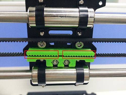

Add the belt
Timing belt
No.46
1
Belt bracket
No.47
1
Step1. Insert one end of the belt in the groove. Pay attention to the tooth mesh of the belt and the groove.
Step2. Thread another end of the belt through the X motor end around the pulley.
Step3. Threaded the belt through the belt driving wheel and put the driving wheel into the X idler end, lock it with a wing nut.
Step4. Insert another end of the belt into the groove. Cut the spare part. Be sure of the length of the belt.
Step5. Taut the belt and tighten the wing nut.
*Note the direction of the driving wheel, the side with bolt head should be towards the A1, or it will scratch the acrylic plate.
watch video here.

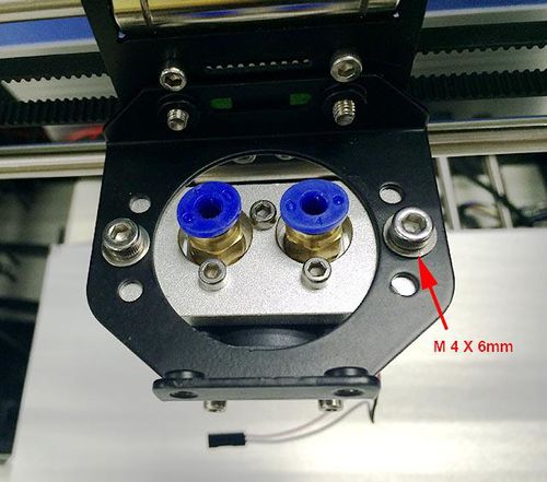

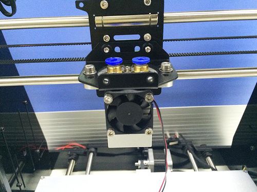

Mount the hotend
Hotend
No.66
1
M4x6mm screw
No.32
2
M4 washer
No.8
1
Mount the hot end on the extruder holder plate from bottom to up with 2 M4x6mm screws and M4 washers.
watch video here.

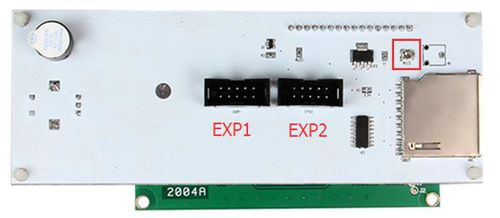

Mount the LCD panel
LCD 2004
No.67
1
Knob
No.50
1
Spacer
No.49
4
M3 x 12mm screw
No.25
4
M3 washer
No.7
1
Step 1. Insert the spacer into the 4 holes on the LCD panel from front to back.
Step 2.Insert the LCD in the LCD frame on A1, fix it with 4 M3 x 12mm screws and M3 washers .
Step 3. Screw up the knob cap.
  • Pay attention to the two connectors at the back of the LCD.
EXP 1 is for the LCD.
EXP 2 is the SD card reader.
Do not mix them up.
Here you can watch the video.

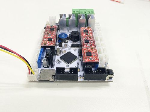

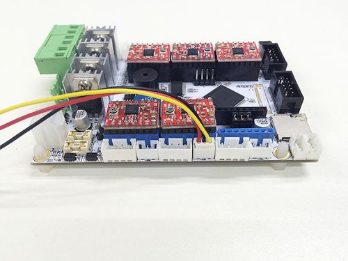

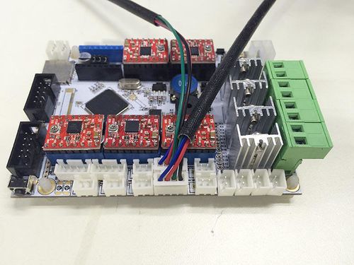

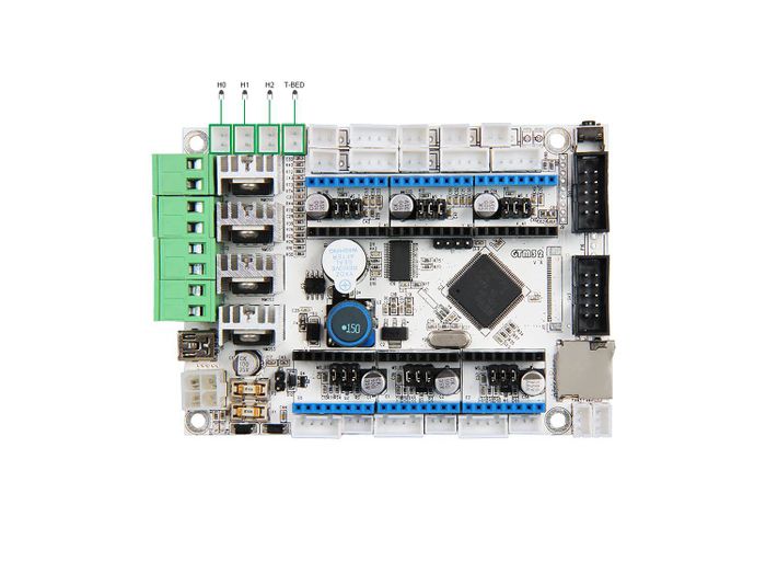

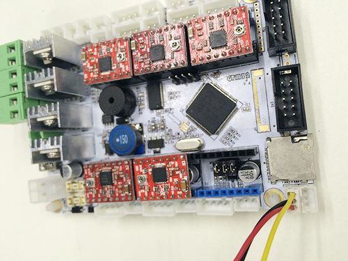

Mount the control board
Control board kit
No.68
1
Sticker
No.56
1
Heat sink
No.55
1
Spacer
No.49
4
M3 x 12mm screw
No.25
4
M3 washer
No.7
1
Step 1. Cut the sticker into small pieces.
Step2. Past the heat sink onto the chip of the A4988 drivers(on the main board) . The sticker is double sided adhesive.
Step 3. Insert the spacer into the 4 holes of the board from back to front.
Step 4. Mount the board kit on the left side panel with 4 M3 x 12mm screws and M3 washers .
Note the direction of the board, the green connectors are downwards to got enough heat dissipation from the fan.
Here is the video.

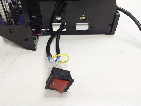

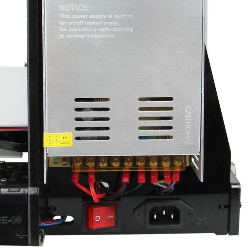

Mount the power supply unit(PSU ) and the socket.
Power supply Unit
No.61
1
3D Power Cable
No.62
1
M4 x 12mm screw
No.33
3
M3 x 16 Hex Counter-sunk-head screw
No.18
2
M3 hex nut
No.12
2
M4 washer
No.8
1
Power Cable
No.63
1

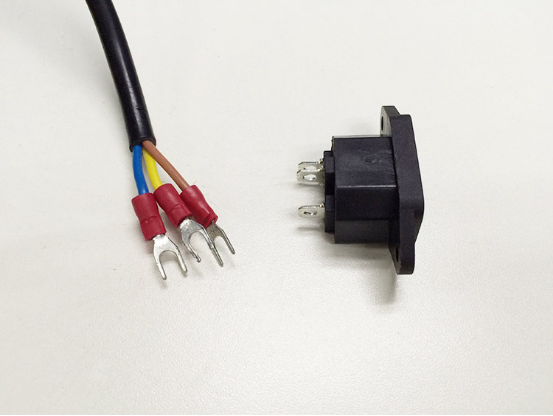

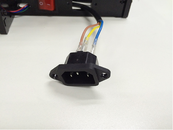

Step1. take off the wires connected to the socket, before you do, please take a photo of the wire connection, in case you connect them wrongly later.
Step2. Thread the wires that is connected to the red switch through another hole on the bottom of the right side panel( A2) from outside to inside and connect the 3 wires (brown, blue, yellow) to the socket, do not mix them up. Refer to the above picture. Then pull the other wires out.
Step3. Mount the socket on the bottom of the right side panel( A2) with 2 M3 x 16 Hex Counter- sunk-head screws and M3 hex nut.
Step4. Thread the power cable from inside to outside.
Step4. Mount the PSU on the right side panel with 3 M4 x 12mm screws . And M4 washer.
Step5. Connect the wires to the PSU.
As you can see, there are 7 wires and 9 screws in total.
  • Note the correspondence between the color of wires and the connector.
Color of wire connectorD
Brown
L
Blue
N
Yellow
GND
Red
+ V
Black
COM
watch video here.
Mount the Y endstop
M2.5 x 16mm screw
No. 21
2
M2.5 hex nut
No. 11
2
End stop
No.54
1
Mount the endstop on the A12 with M2.5 x 16mm screw and M2.5 hex nut

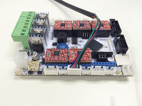

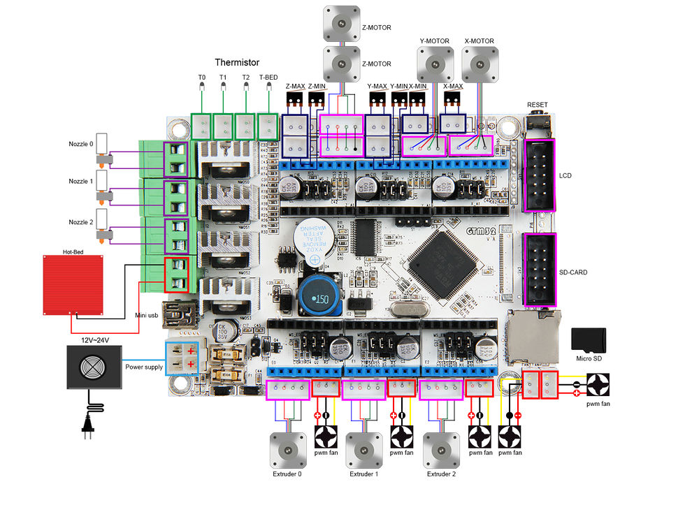

Wiring

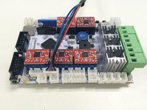

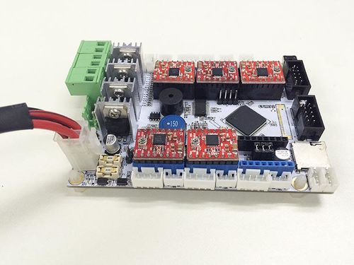

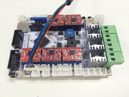

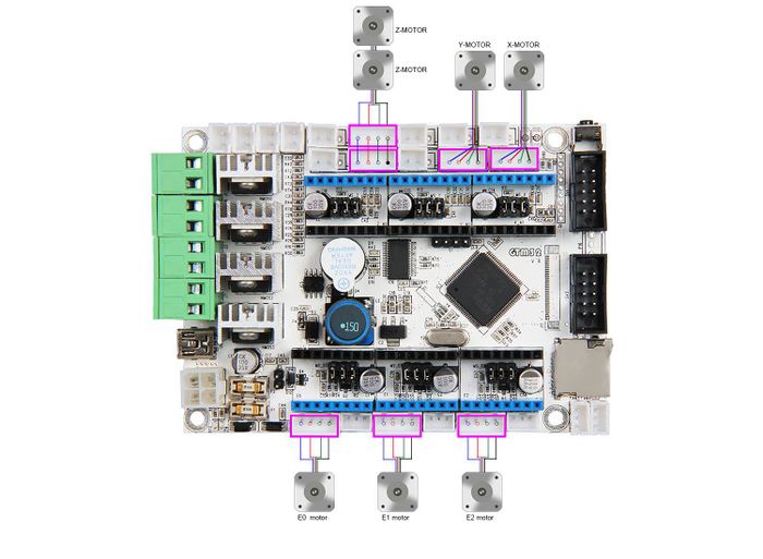

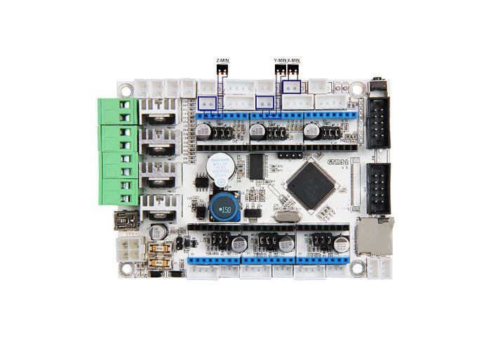

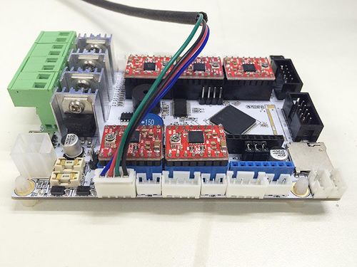

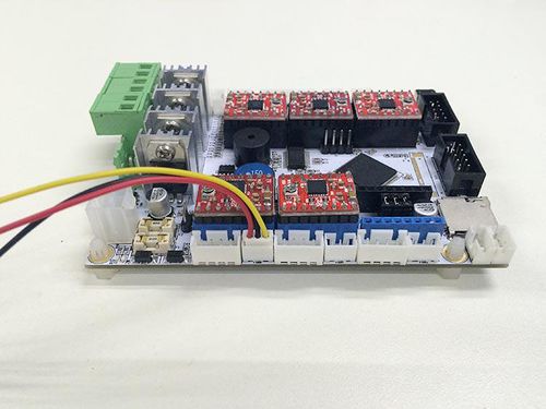

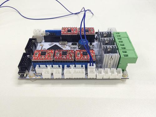

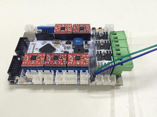

Here is the detailed wiring of GTM32 control board
Step1. Connect wires for motors
1) Connect wires for X-axis motor.
2) Connect wires for Y-axis motor.
3)Connect wires for the 2 Z-axis motors.
4) Connect Extruder motors
Connect extruder 0.
Connect extruder 1,if you are assembling the dual extruder model.

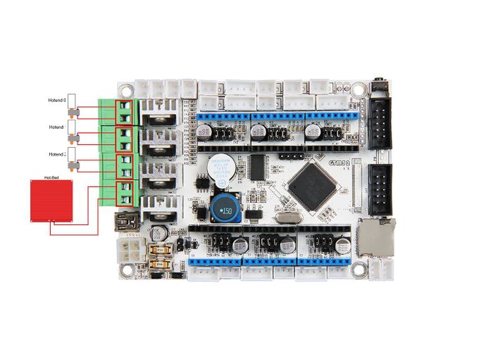

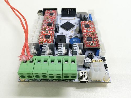

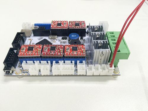

Step2. Connect heating wires
1) Connect heating wires for heatbed.

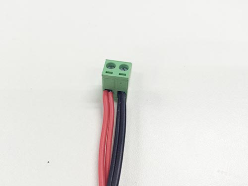

There are 4 heating wires for the heatbed, 2 black and 2 red, you need to connect the 2 red wires in one screw and the 2 black wires in another.
First loos the screws in the green terminal and put the red and black wires into the slot separately, and screw it up.
  • There is no “+” and “-“ polarity for heating wires
2) Connect heating wires for hotend 0.

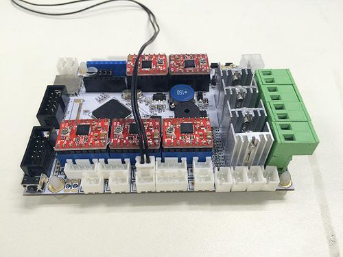

Step3. Connect wires for thermistor
1) Connect wires for thermistor of heatbed.
2)Connect wires for thermistor of hotend 0
Step4. Connect wires for endstop
  • There is no “+” and “-“ polarity for endstop
1) Connect wires for endstop of X-axis at X-Min.
2)Connect wires for endstop of Y-axis at Y-Min.
3) Connect wires for endstop of Z-axis at Z-Min.

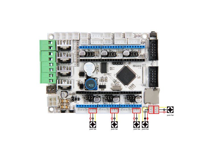

Step5. Connect wires for Fan
Note the “+” and “-“ polarity for fan
Red: +
Black: -
1)Connect fan for control board at FAN3.
2)Connect fan for extruder 0 at FAN0.
3)Connect fan for extruder 1, connect the other to FAN1.
4)Connect fan for hotend at FAN4.
Note: for the fan of hotend, you will need the extension wire. Just connect the red and black connectors.

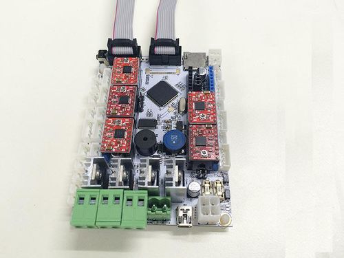

Step6. Connect wires for LCD panel
There are two cables, one is for LCD encoder, the other is for SD card.
EXP1 to LCD
EXP2 to SD card
BTW, do you see the small screw above the SD card reader, if the text in of the LCD phases in an out or there is only blocks on the screen, you can adjust this screw to recovery it.
Step7. Connect wires for power input
Step8. Connect the wires to the PSU
Brown------L
Blue ------N
Yellow------GND
Red ------ --+ V
Black------COM
That is all for the wiring of GTM32.
