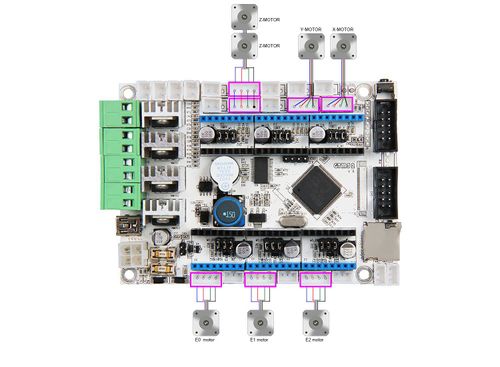

Step1. Connect wires for motors.
1) Connect wires for X-axis motor.
2) Connect wires for Y-axis motor.
3)Connect wires for the 2 Z-axis motors.
4) Connect Extruder motors
Connect extruder 0.
Connect extruder 1,if you are assembling the dual extruder model.

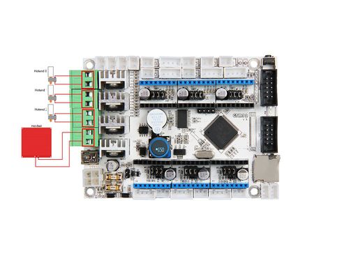

Step4. Connect heating wires.
1) Connect heating wires for heatbed.
There are 4 heating wires for the heatbed, 2 black and 2 red, you need to connect the 2 red wires in one screw and the 2 black wires in another.
First loos the screws in the green terminal and put the red and black wires into the slot separately, and screw it up.
  • There is no “+” and “-“ polarity for heating wires
2) Connect heating wires for hotend 1.

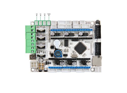

Step5. Connect wires for thermistor.
1) Connect wires for thermistor of heatbed.
2)Connect wires for thermistor of hotend 1

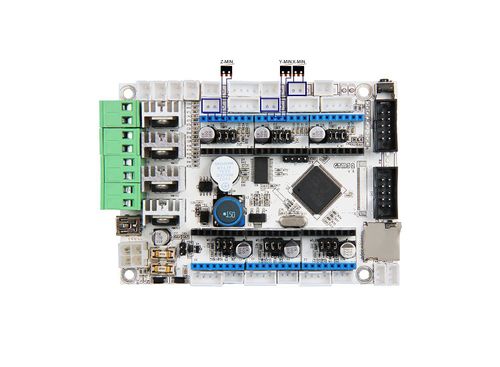

Step6. Connect wires for endstop.
  • There is no “+” and “-“ polarity for endstop
1) Connect wires for endstop of X-axis at X-Min.
2)Connect wires for endstop of Y-axis at Y-Min.
3) Connect wires for endstop of Z-axis at Z-Min.

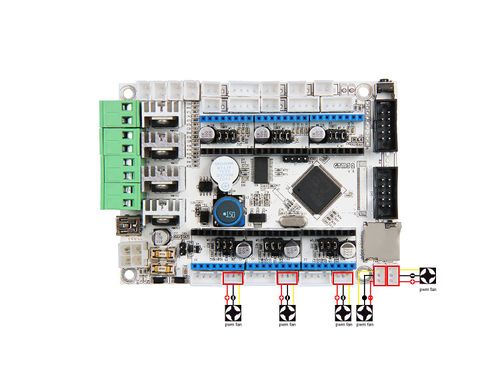

Step7. Connect wires for Fan.
Note the “+” and “-“ polarity for fan
Red: +
Black: -
1)Connect fan for control board at FAN4.
2)Connect fan for extruder 0 at FAN1.
3)Connect fan for extruder 1, connect the other to FAN1.
4)Connect fan for hotend at FAN5.
Note: for the fan of hotend, you will need the extension wire. Just connect the red and black connectors.
