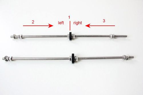

1. Assemble the threaded rods of Y axis
Required parts Part ID Required number
450mm threaded rod
53
2
M10 washer
33
8
M10 hex nut
A3
8
M10 spring washer
A4
6
Connecting fender
14
2
Thread the nuts and washers into the two M10 threaded rods separately. The order should be:
1) Thread the acrylic fender (Y plate connecting plate) in the middle.
2)Thread the M10 washer>M10 nut >M10 nut >
 M10 nut <M10 nut < M8 spring washer<M10 washer in turn on the left
3) Thread theM10 washer < M8 spring washer < M10 nut < M10 nut< M8 spring washer < M10 washer in turn on the right
Watch the Video here.

18. Assemble the the X axis together and add the belt
Watcht the video here first, please pay attention to the dirctions of each part.
L430mm smooth rod
No.2
2
locking ring
No.35
2
X axis Fender
No.A27
2
Step 1. Thread one end of the smooth rod into the hole on the X left end.
Step 2. Continue to thread the rod into the Linear Bearing on the back of the extruder. Note the dirctions, (watch the video)
Step 3. Thread the locking ring on the two rods seprately and screw it up later.
Step 4. Thread the X axis Fender on the two rods seprately.
Step 5. Thread the X right end to another end of the rod.
The orders should be like this.

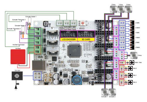

26.Wiring
GT2560 Before you start wiring, please take a look at the wiring schematics.
You can see original picture here.
For your convenience, the first two steps have been finished by us before shipping. you can skip them.
Step1. Check the ubdivision of stepper motor The subdivision of stepper motor can be setup by jumper cap, plug all the jumper caps (For A4988)
If you are using DRV8825 instead of A4988, the jumper caps should be changed as follow:
Step2. Plug stepper motor driver Plug the 5 A4988 into the stepper motor driver slot. Mind the directions of A4988.
If you are using DRV8825 instead of A4988, The correct connections are as follow:
Step3. Connect wires for motors.
1) Connect wires for X-axis motor.
2) Connect wires for Y-axis motor.
File:15 y motor1.jpg
3)Connect wires for the 2 Z-axis motors.
File:15 z motor1.jpg
4) Connect Extruder motors
Connect extruder 1.
Step4. Connect heating wires.
Loosed the screws in the green terminal and put the red wires into the slot and screw it up.
  • There is no “+” and “-“ polarityfor heating wires
1) Connect heating wires for heatbed.
2) Connect heating wires for extruder 1.
Step5. Connect wires for thermistor.
1) Connect wires for thermistor of heatbed.
2) Connect wires for thermistor of extruder 1.
Step6. Connect wires for endstop. * There is no “+” and “-“ polarity for endstop 1) Connect wires for endstop of X-axis at X-Min.
2) Connect wires for endstop of Y-axis at Y-Min.
3) Connect wires for endstop of Z-axis at Z-Min.
Step7. Connect wires for Fan.
Note the “+” and “-“ polarity for fan Red: + Black: -
1) Connect fan for control board at FAN3.
2) Connect fan for extruder at FAN1.
If you use the 2-pin extension wire for the fan,  just plug them on the + and - pin.
Step8. Connect wires for LCD panel.
There are two cables, one is for LCD encoder, the other is for SD card,
EXP1 to SD card
EXP2 to LCD
Step9. Connect wires for power input.
Step 10. Connect the wires to the PSU.
Note the correspondence between the color of wires and the connector. Brown------L Blue ------N Yellow------GND Red ------ --+ V Black------COM That is all for the wiring of GT2560.
