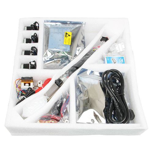

Unfold the box and check the package list

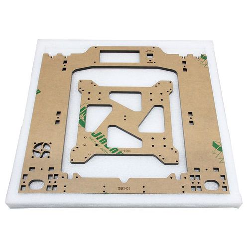

Unfold the package and take all the parts out to check the condition of the items.
  • All the acrylic plates have been etched with part ID and the plate is covered with a sheet of kraft paper, you need to tear them off.
  • The part ID is corresponding to the number labeled on the bag of every part. Some parts may not have label, you can refer to the pictures on the package list.

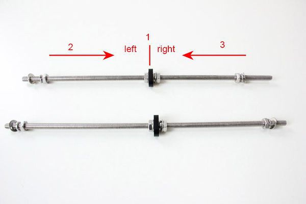

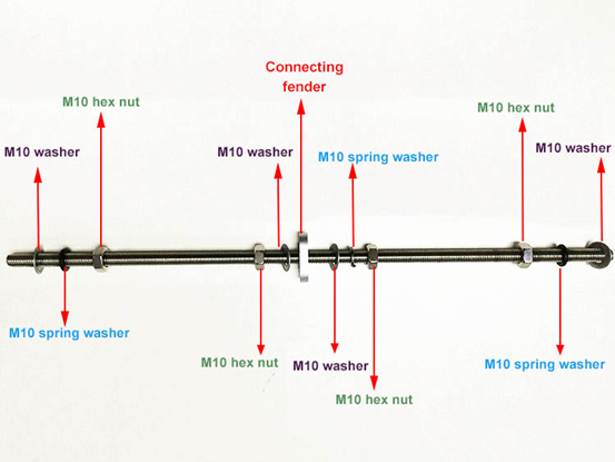

Thread the nuts and washers into the two M10 threaded rods separately. The order should be:
1) Thread the acrylic fender (Y plate connecting plate) in the middle.
2)Thread the M10 washer>M10 nut >M10 nut >
M10 nut <M10 nut < M10 spring washer<M10 washer in turn on the left
3) Thread theM10 washer < M10 spring washer < M10 nut < M10 nut< M10 spring washer < M10 washer in turn on the right
Watch the Video here.

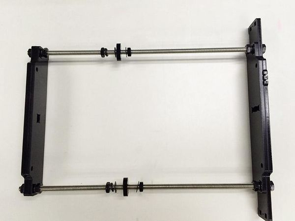

Thread the rod to the plate, screw up the threaded rods and plate with M10 nut and M10 washer at both end. You don’t have to tighten it because you need to adjust the distance between the front and rear plate later when you assemble the side panel.
(this picture is just for reference, the plates are not exactly the same as that for I3 X)
  • Tips:
the Y-axis must be a rectangle, that is the rods on both side should be parallel, so is the front and back plate. Otherwise it will cause obstruction for the belt later. You can use a Digital Caliper to measure.

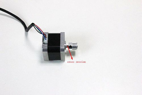

Step1. Mount the pulley on the motor shaft, one of the screws should be screwed on the cross section of the shaft. Screw it tightly.
Step2. Then screw the motor on the block plate with 3 M3 x 12 screws .
Insert the motor holder into the slot; you may need to use a little strength to do this.
Fix the holder plate with 2 M3 x 20mm screws and M3 square nut.
  • be careful in case the Acrylic break down.
You can watch the video here.

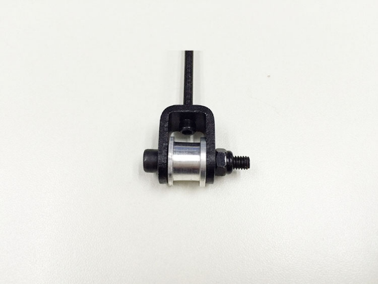

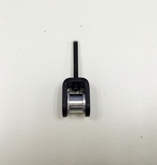

4.Y belt driving wheel
Required parts Part ID Required number
Driven wheel holder
No.40
1
Driving wheel
No.40A
1
Ball Bearing
No.35
2
M3 x20mm screw
No.24
3
M4 x 25mm screw
No.31
2
M4 locking nut
No.14
2
wing nut
No.15
1

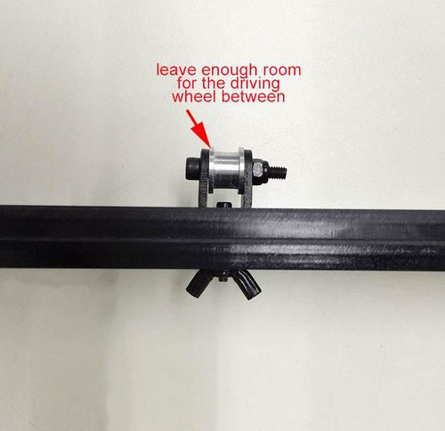

Step 1. Thread the M3 x 20 screw through the top hole on the drive wheel holder.

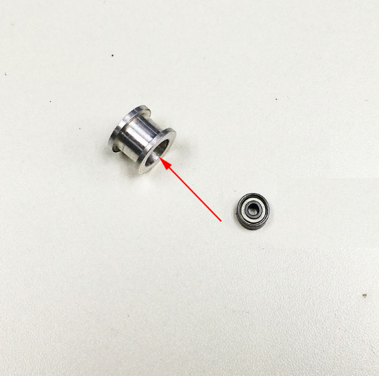

Step 2. Pick up 2 MR84zz ball bearings. Insert 1 MR84zz ball bearings into both ends of the drive wheel .
Step 3.Place the drive wheel in to the drive wheel holder and fix it in place with an M4 x25 screw and M4 washer. Lock the other end with a M4 lock nut . You may need a wrench to tighten M4 locking nut.
  • Note: Do not screw it too tightly as it may restrict the free movement of the drive wheel. It is important that you leave enough room for the wheel to turn freely.
You can refer to the video here.

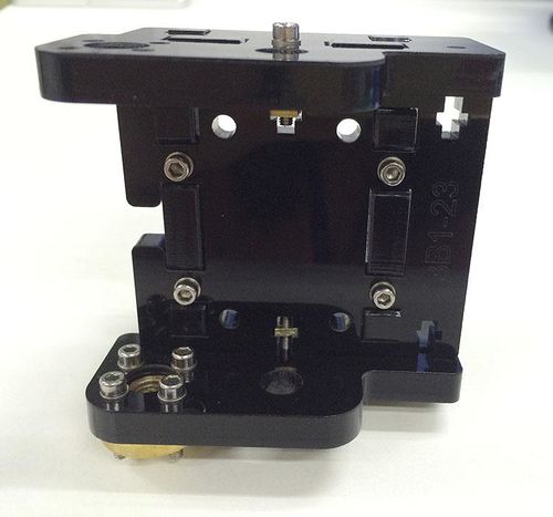

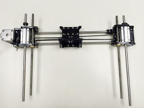

13.Assemble the left end of the X axis(motor end)
For the whole process of assembly of this part, please refer here.

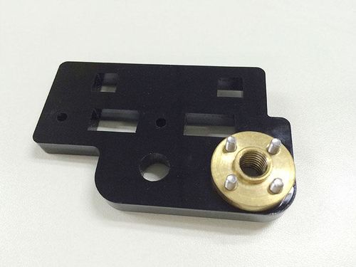

Step 1. Mount the Z-axis nut.
M3 x 16mm screw
No.23
4
M3 washer
No.7
4

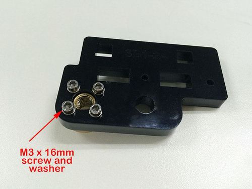

Z-axis nut
No.17
1
Left bearing bottom plate
No.A18
1
Mount the Z nut on the A 18 from underside to up, fix with M3 x 16mm screw and M3 washer.

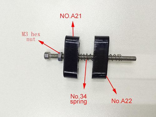

Endstop holder
No.A21
1
Endstop holder
No.A22
1

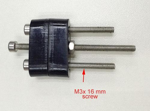

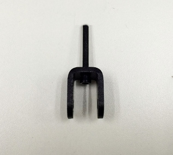

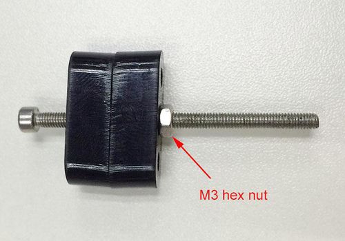

1.Thread a M3 hex nut to the M3 x 50 screw.
2.Thread the A21 to the M3 x 50 screw.
3.Thread the spring to the the M3 x 50 screw through the hole of A21.
4.Thread A22 to the M3 x 50 screw.
5.Thread another M3 hex nut to the M3 x 50 screw, compress the spring into the M3 hex hole on A21 and A22, you need to use some force.
6.Mount them on the Left bearing bottom plate (No.A18 ).
7.Fix it up with 2 M3 x 30mm screws and M3 hex nuts.

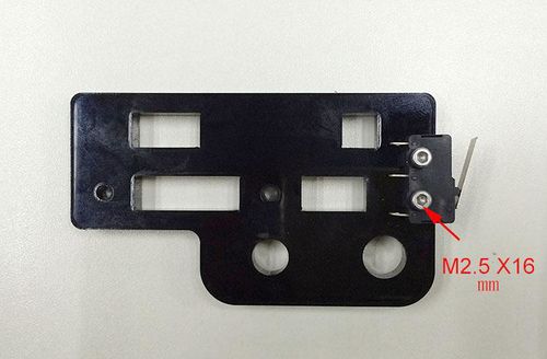

Step 3. Mount the endstop
M2.5 x 16mm screw
No. 20
2
M2.5 hex nut
No. 11
2
End stop
No.52
1
Left bearing top plate
No.A17
1

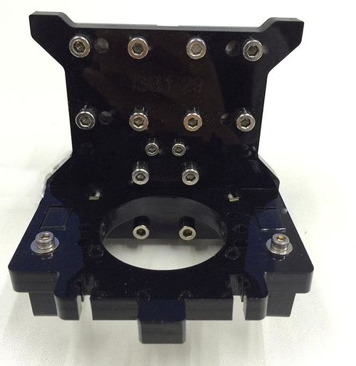

Mount the endstop on the Left bearing top plate with two M2.5 x 16mm screw and M2.5 hex nut
Step 4. Assemble the X left end together
M3 x 16mm screw
No. 23
8
M3 Square nut
No. 16
8

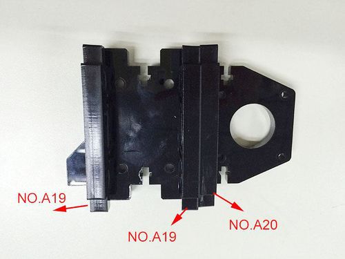

X motor holder
No.A 16
1
X axis rod holder (left)
No.A 19
2
X axis belt holder
No.A 20
1
  • Note the direction

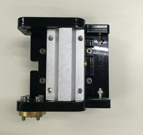

Step 5. Fix the linear bearing SCS8LUU.
No. 37
1
M4x16mm screw
No. 30
4
M3 x 16mm screw
No. 23
4
M3 Square nut
No. 16
4
Mount the SCS8LUU on X motor holder with 4 M4x16mm screws. And fix the top and bottom plate with M3 x 16mm screw and M3 Square nut.
14.Assemble the right end of the X axis. (X idler)

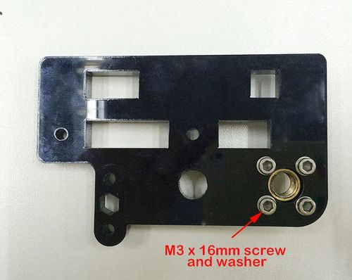

Step 1. Mount the Z axis nut on A24
M3 x 16mm screw
No. 23
4
M3 washer
No. 7
4

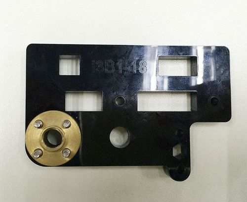

Z-axis nut
No.17
1
Right bearing top/bottom plate
No.A24
1
Mount the Z axis nut on A24 with 4 M3 x 16mm screw and M3 washer.

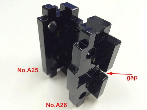

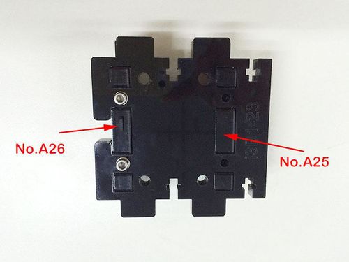

Step 2. Mount A25 and A26 on A23
M3 x 16mm screw
No. 23
4
M3 Square nut
No. 16
4
Right bearing holder
No.A23
1
X axis rod holder(right)
No.A25
1
X axis driving wheel support holder
No.A26
1

Step 4. Fix the linear bearing SCS8LUU.
No. 37
1
M4x16mm screw
No. 30
4
Mount the SCS8LUU on Right bearing holder with 4 M4x16mm screws.
15.Assemble the X and Z motors.
stepper motor
No.63
3
M3 x12mm screw
No.22
12
Pulley
No.42
1
Mount the X motor
Step2. Then screw the motor on A16 plate with 4 M3 x 12 screws .
Mount the Z motors
Step1.Thread the wires of the motors through the holes on the bottom of A1.
Step2.Screw up the motors with 4 M3 x 12 screws. Do the same with the other Z motor.
For detailed assembly process, please watch here.
16. Assembly of the single extruder carriage
M3 x 16mm screw
No.23
6
M3 Square nut
No.16
6
M3 washer
No.7
10
M3x12mm screw
No.22
2
M3 hex nut
No.12
2
belt mount
No.41
1
X axis bearing support plate
No.A 29
1
Extruder Bracket
No.A30
1
extruder bracket support
No.A31
2
SCS8UU Linear Bearing
No.36
3
M4x16mm screw
No. 30
12
Extruder
No. 61
1
M4x12mm Screw
No.29
1
Step 1. Mount the belt mount on the back of the X axis bearing support plate(No.A 29) with 2 M3x12mm screws and lock it up with M3 hex nut.
Step 2.mount the 3 SCS8UU Linear Bearing on the back of the X axis bearing support plate(No.A 29) with M4x16mm screws.
Step 3. Mount the 2 extruder bracket support (No.A31) under the Extruder Bracket(No.A30) with 2 M3 x 16mm screw and M3 Square nut.
Step 4. Connect the Extruder Bracket(No.A30) to X axis bearing support plate(No.A 29) with 2 M3 x 16mm screw and M3 Square nut. Step 5. Thread the extruder into the bracket and fix it up with 2 M4x12mm Screws.

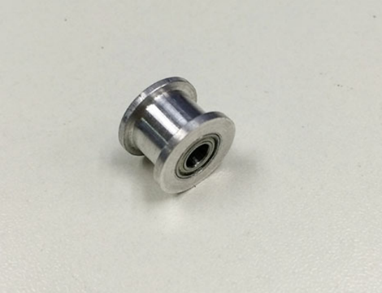

17. X belt driving wheel
Driven wheel holder
No.40
1
Driving wheel
No.40A
1
Ball Bearing
No.35
2
M3 x50mm screw
No.28
3
M4 x 25mm screw
No.31
2
M4 locking nut
No.14
2
wing nut
No.15
1
Step3. Mount the assembled bearing holder onto the RIGHT end of X axis later when assemble the belt. And screw it with a wing nut.
  • Please leave enough room for the belt between the ball bearing and the screw.

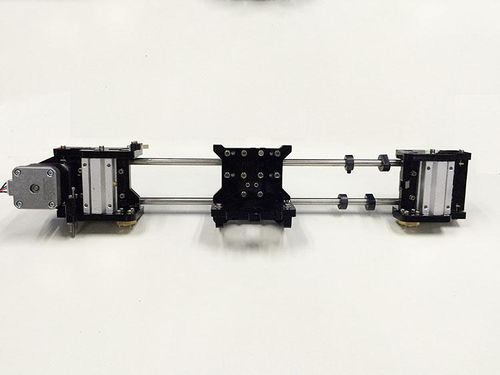

18. Assemble the the X axis together and add the belt
Watcht the video here first, please pay attention to the dirctions of each part.
L430mm smooth rod
No.2
2
locking ring
No.32
2
X axis Fender
No.A27
2
Step 1. Thread one end of the smooth rod into the hole on the X left end.
Step 2. Continue to thread the rod into the Linear Bearing on the back of the extruder. Note the dirctions, (watch the video)
Step 3. Thread the locking ring on the two rods seprately and screw it up later.
Step 4. Thread the X axis Fender on the two rods seprately.
Step 5. Thread the X right end to another end of the rod.
The orders should be like this.
Add the belt
Timing belt
No.39
1
M3 x8mm screw
No.21
1
M3 washer
No.7
1
Step1. Punch a M2.5 hole on one end of the belt(the hole can be as the diameter of the M2.5 screw to drill instead, leave enough margin )
Step2. Fix the belt on one side of the belt -mount with a M3 x 8 screw and washer.
Step3. Thread the belt around the pulley on the motor and the 624zz ball bearing we assembled just now.
  • Tips:
1.DO NOT rush to drill the second hole now, we are not sure about the length of the belt needed until we assemble the X axis on the printer.
2. Loosen the Y idler wing nut when tightening belt onto the Y belt mount [No. 67] in order to make securing the belt to the block easier. Be sure to tighten wing nut fully once done.
19. Assemble the X axis on the printer
L322mm smooth rod
No.1
2
300mm threaded rod
No.4
2
Coupling
No.38
2
Z top mount
No.A8
2
M3 x 16mm screw
No.23
6
M3 Square nut
No.16
6
locking ring
No.32
2
Step 1. Fix the two couplings on the Z motor shaft separately.
Please note the opening of both end, one is 5mm, another is 8mm, connect the 5mm hole to the motor shaft. Screw it tightly.
Step 2. Thread the to L322mm smooth rods into the left and right end separately.
Note: please make sure the holes are alined, if not, you can loose the SCS8UU
Linear Bearing a bit, then you can thread smoothly.
Step 3. Thread the threaded rod into the Z nut, the video did not show this step here, but you need to do it now.
Step 4. Assemble the finished part on the printer. Adjust the two end of the X axis to make sure the smooth rods and the threaded rod of Z axis is vertical, and the two end of the X axis are horizontal , which is very important, or it will hinder the move of the Z axis.
Step 5, upon adjusting, you can screw up the locking ring on the rods of X axis.
Step 6. Thread the two locking rings to the smooth rod of the Z axis.
Step 7. Add the Z top mount to the Z axis. Screw it up with M3 x 16mm screw and M3 Square nut.
Watch the video here.

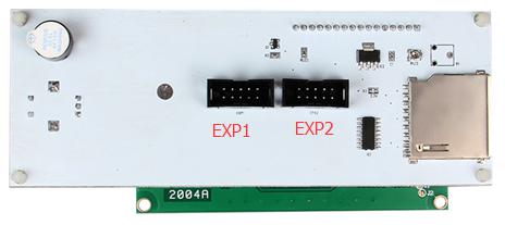

Step 1. Insert the spacer into the 4 holes on the LCD panel from front to back.
Step 2. Mount the LCD on the main frame (A1) with 4 M3 x 12mm screws.
Step 3. Screw up the knob.( The screw is inside)
Pay attention to the two connectors at the back of the LCD.
EXP 2 is for the SD card reader. EXP 1 is for the displaying of the LCD.
Do not mix them up.

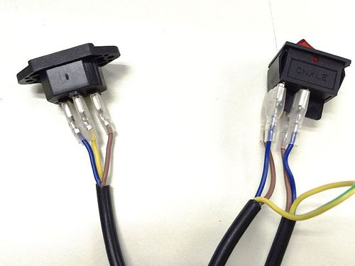

Step 1, take off the wires connected to the socket, before you do, please take a photo of the wire connection, in case you connect them wrongly later.
Step 2. Mount the socket on the bottom of the right side panel( A2) with 2 M3 x 16 Hex Counter- sunk-head screws and M3 hex nut.
Step 3. Thread the wires conencted to the switch through another hole on the bottom of the right side panel( A2) from outside to inside and connect the 3 wires to the socket, do not mix them up.
Step 3. Moun the PSU on the right side panel with 4 M3 x 12mm screws

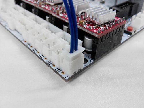

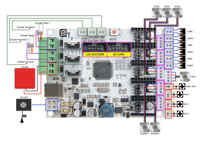

26.Wiring
Before you start wiring, please take a look at the wiring schematics.
You can see original picture here.
For your convenience, the first two steps have been finished by us before shipping. you can skip them.

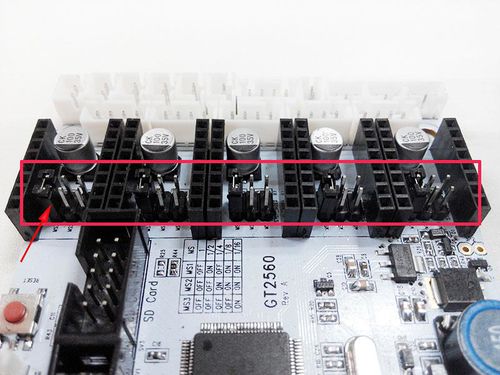

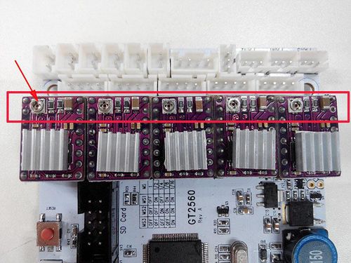

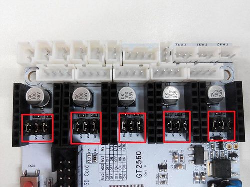

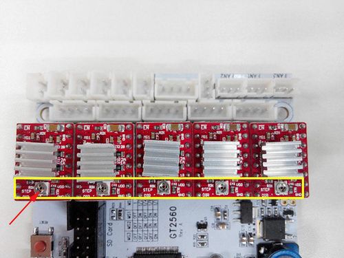

Step1. Check the ubdivision of stepper motor The subdivision of stepper motor can be setup by jumper cap, plug all the jumper caps (For A4988)
If you are using DRV8825 instead of A4988, the jumper caps should be changed as follow:

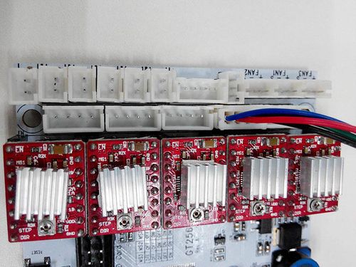

Step2. Plug stepper motor driver Plug the 5 A4988 into the stepper motor driver slot. Mind the directions of A4988.
If you are using DRV8825 instead of A4988, The correct connections are as follow:

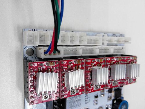

Step3. Connect wires for motors.
1) Connect wires for X-axis motor.
2) Connect wires for Y-axis motor.
File:15 y motor1.jpg
3)Connect wires for the 2 Z-axis motors.
File:15 z motor1.jpg
4) Connect Extruder motors
Connect extruder 1.

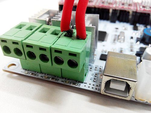

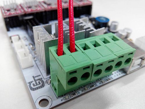

Step4. Connect heating wires.
Loosed the screws in the green terminal and put the red wires into the slot and screw it up.
  • There is no “+” and “-“ polarityfor heating wires
1) Connect heating wires for heatbed.
2) Connect heating wires for extruder 1.
Step5. Connect wires for thermistor.
1) Connect wires for thermistor of heatbed.
2) Connect wires for thermistor of extruder 1.
Step6. Connect wires for endstop. * There is no “+” and “-“ polarity for endstop 1) Connect wires for endstop of X-axis at X-Min.
2) Connect wires for endstop of Y-axis at Y-Min.
3) Connect wires for endstop of Z-axis at Z-Min.

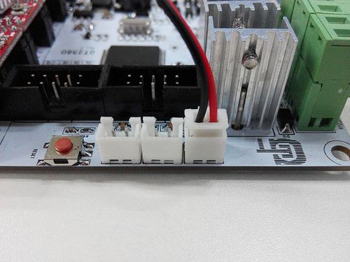

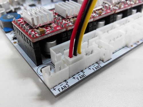

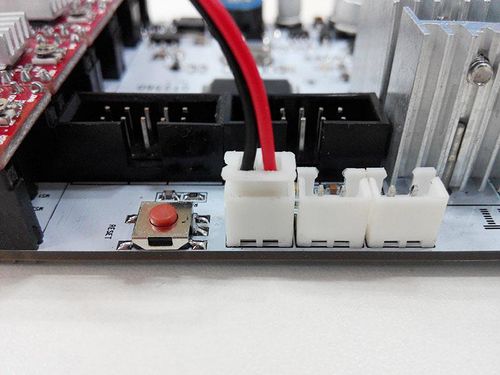

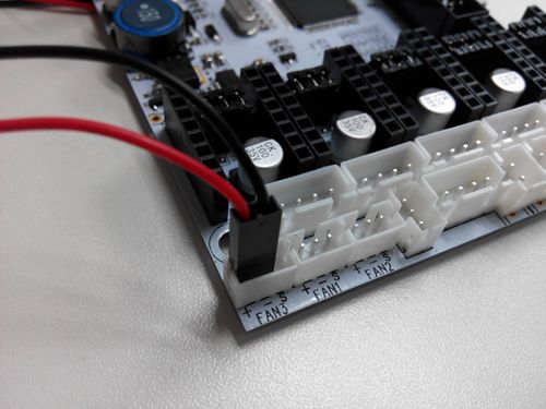

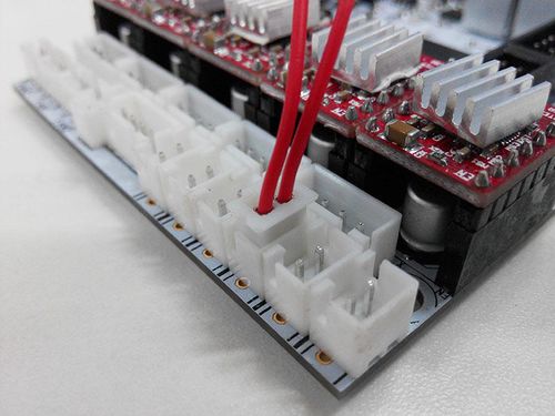

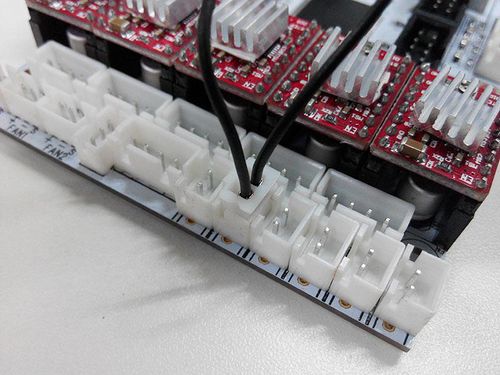

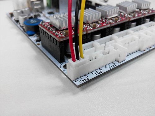

Step7. Connect wires for Fan.
Note the “+” and “-“ polarity for fan Red: + Black: -
1) Connect fan for control board at FAN3.
2) Connect fan for extruder at FAN1.
If you use the 2-pin extension wire for the fan,  just plug them on the + and - pin.

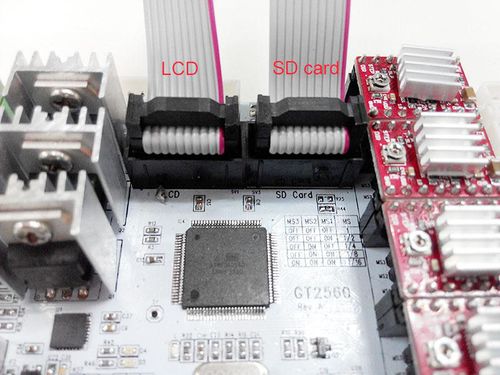

Step8. Connect wires for LCD panel.
There are two cables, one is for LCD encoder, the other is for SD card,
EXP1 to SD card
EXP2 to LCD

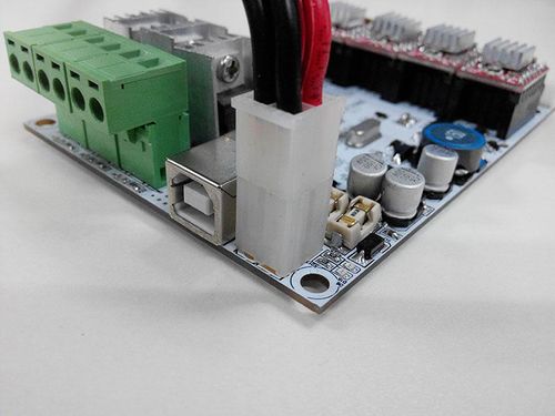

Step9. Connect wires for power input.

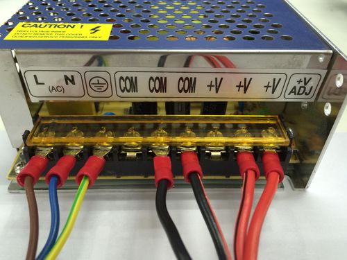

Step 10. Connect the wires to the PSU.
Note the correspondence between the color of wires and the connector.
Brown------L
Blue ------N
Yellow------GND
Red ------ -- + V
Black------COM
That is all for the wiring of GT2560.

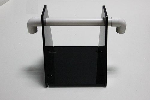

27.Mount the filament spool
M3 x 16mm screw
No.23
6
M3 Square nut
No.16
6
M3 washer
No.7
6
Spool base plate
1
Spool side pane
2
PVC tube
1
PVC tube
2
So far, the whole printer is built up, you can tidy up the wires with the zip ties and the coil wire.
