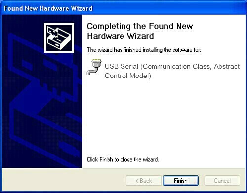

Arduino IDE Installation 1.Windows will prompt that a new USB device, named FT232R USB UART was found when connecting USB with generation to the PC. Then, windows will open the dialog box “found new hardware wizard”, check “no, not this time”, then click “next” to continue.
[[File:Rumba 14.jpg]]
Check “install from a list or specific location (advanced)”, then click “next”.
[[File:Rumba15.jpg]]
Specify “drivers” in Arduino 1.0.installation directory to install driver.
[[File:Rumba 16.jpg]]
If everything goes well, windows will install the corresponding driver. After the installation complete.

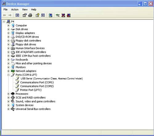

You can find the corresponding Generation 6device in device manager of windows.
[[File:Brw ss2.jpg]]
[[File:Brwss3.jpg]]
Now, you can find the corresponding Generation 6device in device manager of windows.
If everything goes well, windows will install the corresponding driver. After the installation complete. You can find the corresponding Generation 6device in device manager of windows.
