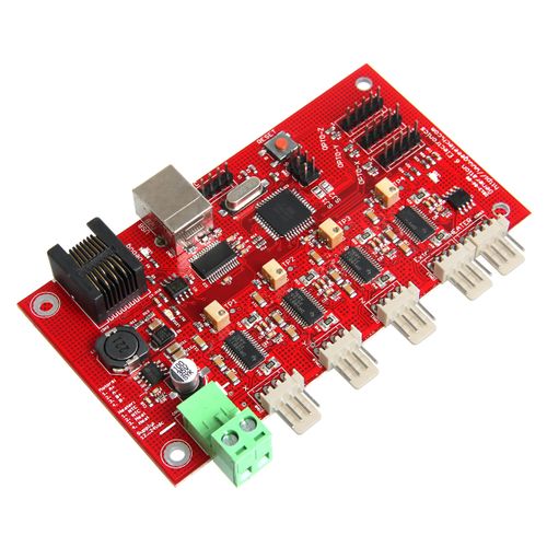

Hardware Features
  • on-board USB-RS232 convertor
  • Integrated hardware for driving one extruder (stepper, heater and thermistor)
  • RS485 bus connector with the possibility to link through the extruder step and dir signals
  • Integrated hardware for driving H21LOB or TCST2103 slotted optosensors
  • High input voltage range: 12-24Vdc
  • Use of standard connectors with easy and clean installation
  • Debug LEDs for power, communication and heater output
  • Reset button
Specifications
  • Dimensions 110x60mm
  • Mounting grid: 100x50mm (4x M3)
  • Input voltage 12-24Vdc
  • On-board controller: ATmega 644p (Atmel Corp.)
  • RS485 connector: RJ45
  • Heat output: MOSFET output, 4A
  • Thermistors input: 100K thermistor

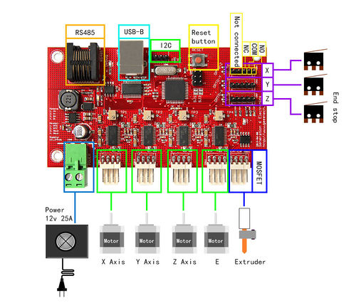

End-Stop Sensors
Opto-endstop
The firmware sees a missing endstop as a tripped endstop. If you want to test your steppers prior to installing the endstops you still need to plug the endstops into the Gen6 board.
Without any endstops installed the stock firmware will refuse to move each axis in the direction that would be toward the endstop.
Inverting Optos Gen6 was originally designed for H21LOB optos. Header pinout for H21LOB optos is as follows:
  1. - Emitter Anode(E+)
  2. - Emitter Cathode (E-)
  3. - Detector Vcc (D+)
  4. - Detector Vo (D-)
  5. - Detector Ground (Gnd)
Non-Inverting Optos H21LOB optos have been discontinued. TCST2103 is a suitable replacement. Header pinout for TCST2103 optos is as follows:

Microswitches
From 17-Dec-2010 Mendel-Parts changed the type of opto-end stops from inverting to non-inverting, so depending on which version opto's your firmware is configured for, you will need to wire the microswitches differently. Microswitch Wiring for Inverting Firmware (prior to 17-Dec-2010)
A typical microswitch connection would be:
  1. - No Connection
  2. - No Connection
  3. - Switch NC
  4. - Switch Common
  5. - Switch NO
Microswitch Wiring for Non-Inverting Firmware (after 17-Dec-2010) A typical microswitch connection would be:
  1. - No Connection
  2. - No Connection
  3. - Switch NO
  4. - Switch Common
  5. - Switch NC

Heater and Thermistor
  • One (1) 4 wire Molex housing, 2.54 mm, friction ramp, polarized (KK series, Molex part# 0022013047)
  • Four (4) Molex crimp terminals (2759 series, Molex part# 0008550101)
Pinouts listed on the PCB:
  1. NTC (Brown)
  2. NTC (Black)
  3. Heat (Yellow)
  4. Heat (Clear or gray)
Pin 1 is furthest from the power connector and closest to the edge of the board, Pin 4 is closest to the power connector.
Heated Bed
Gen6 doesn't support a heated bed as-is. If you want to connect one, you need an external switch like the SevenSwitch (for 12V heated beds) or a solid state relay (for 110V/220V heat mats).
Stepper Motors for X, Y, Z Axes and Extruder
  • Four (4) 4 wire molex housing, 2.54 mm, friction ramp, polarized (KK series, Molex part# 0022013047)
  • Sixteen (16) Molex crimp terminals (2759 series, Molex part# 0008550101)
Wire lengths listed by [User:Camiel|Camiel] are as follows:
  • Two (2) @ 40 cm (X & E)
  • Two (2) @ 75 cm (Y & Z)
  1. A+ = A
  2. A- = B
  3. B+ = C
  4. B- = D

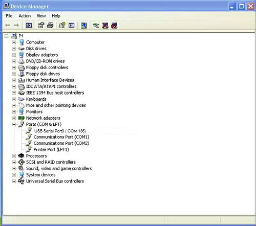

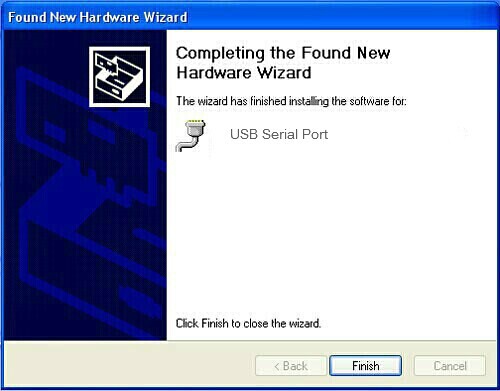

Arduino IDE Installation 1.Windows will prompt that a new USB device, named FT232R USB UART was found when given power and connecting USB with generation to the PC. Then, windows will open the dialog box “found new hardware wizard”, check “no, not this time”, then click “next” to continue.
Check “install from a list or specific location (advanced)”, then click “next”.
Specify “drivers” in Arduino 1.0.installation directory to install driver.
If everything goes well, windows will install the corresponding driver. After the installation complete. You can find the corresponding Generation 6device in device manager of windows.
Now, you can find the corresponding Generation 6device in device manager of windows.
