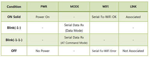

There are four indicator LEDs(PWR, MODE, WIFI, LINK) on the Wifi Shield, users can know about the working phase of the shield based on the four indicator LEDs. Detailed information please refer to the following table:
