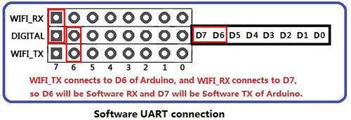

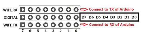

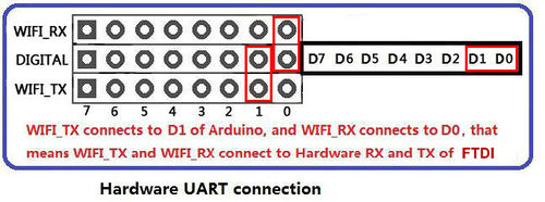

Selectable UART connection
Users can use the jumpers to connect the WIFI_TX and WIFI_RX pins(5V) of Wifi Module to any Arduino.
Users must be aware that which Digital pin of Arduino connects to WIFI_TX needs to act as Arduino RX pin(Hardware/Software), and which connects to WIFI_RX needs to act as Arduino TX pin(Hardware/Software).
The following figure shows users how to use jumpers to configure UART communication between Wifi Shield and Arduino.

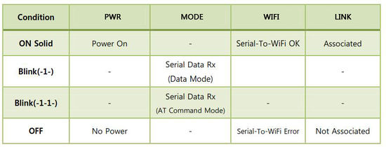

Indicator LEDs
There are four indicator LEDs(PWR, MODE, WIFI, LINK) on the Wifi Shield, users can know about the working phase of the shield based on the four indicator LEDs. Detailed information please refer to the following table:

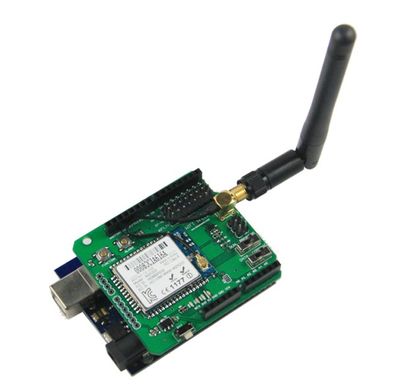

Antenna Interface
The shield comes with a 2.4G antenna; Make sure the antenna is assembled and antenna pad is buckled properly.

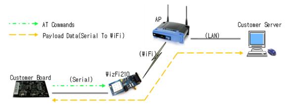

Wireless Communication between Wifi Shield and PC
This photo demonstrate the working process of WIFI communication between PC and the custom board via wifi shield.

  3. Set the jumpers to connect the WIFI_TX and WIFI_RX pins as the photo above to enable PC com port to send AT command to WIFI shield directly as the photo below

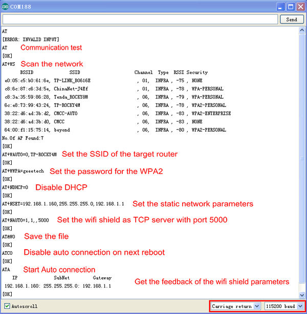

Configure the WIFI shield setting via Serial monitor
  1. Please set the baud rate to 115200 bps and Carriage return
  2. Open the com port of your Arduino UNO. And enter the "AT" to test the communication between WIFI shield and the USB port
  3. Enter "AT+WS" command to scan the network and get the list of found networks
  4. Enter "AT+WAUTO=0,Your SSID" to Set the SSID of the target router
  5. Enter "AT+WWPA=Your password" to set the password for the WPA2
  6. Enter "AT+NDHCP=0" to disable DHCP
  7. Enter "AT+NSET=192.168.1.150,255.255.255.0,192.168.1.1" to set the static network parameters
  8. Enter "AT+NAUTO=1,1,,5000 " to set the wifi shield as TCP server with port 5000
  9. Enter "AT&W0" to save the file
  10. Enter "ATC0" to disable auto connection on next reboot
  11. Enter "ATA" to start Auto connection
After getting the feedback from WiFi shield , we have finished creating a TCP server in the local network.And the indicator LEDs(marked "LINK" and "WIFI")will turn on to indicate the connection with the router.

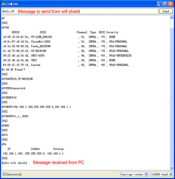

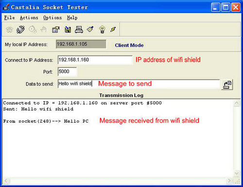

Connect to the WiFi shield
On the other PC in the same network, we use Castalia Socket Tester as the TCP client and you can begin the data transmission to wifi shield.
