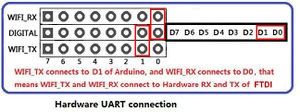

Hardware settings
Selectable UART connection
Users can use the jumpers to connect the WIFI_TX and WIFI_RX pins(5V) of Wifi Module to any Arduino.
Users must be aware that which Digital pin of Arduino connects to WIFI_TX needs to act as Arduino RX pin(Hardware/Software), and which connects to WIFI_RX needs to act as Arduino TX pin(Hardware/Software).
The following figure shows users how to use jumpers to configure UART communication between Wifi Shield and Arduino.

Preparation
  1. Stack the WIFI shield to the Arduino Uno and connect the antenna to the WIFI shield
  2. Program a simple code as blink without delay for your Arduino UNO first to avoid the serial communication conflict.
  3. Set the jumpers to connect the WIFI_TX and WIFI_RX pins as the photo above to enable PC com port to send AT command to WIFI shield directly as the photo below
  4. Set the "Run/Program" Switch to RUN side
