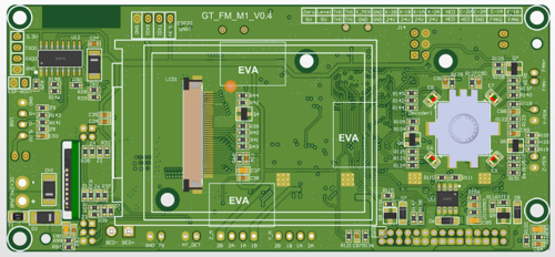

[[File:M1_Motherboard.png]]
[[File:M1_Motherboard_back.png|100px|left]]
[[File:M1_Motherboard_back.png|500px|left]]
=== '''Print head adapter board wiring diagram'''===

Mainboard wiring diagram
