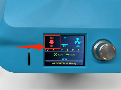

=== '''How to replace the nozzle'''===
1. In the menu preheating function, set the nozzle temperature to 200 degrees
