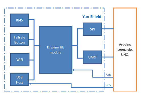

POWER
The Dragino HE is the core module of Yun Shield. The HE module requires around 200ma current when in full load, so it is powered by the Arduino VIN pins to avoid overheated in the Arduino onboard 5v LDO. So when Yun shield is in used, the Arduino board should be powered by DC port instead of USB port. The DC input can be 7v -15v.
The USB Host of Yun Shield gets power from the Arduino +5vpin, since the +5v from Arduino comes from the +5V LDO, to avoid overheated on the Arduino Board, when the USB host is in used, it is recommended to use +7v DC.
Interface
The RJ45, WiFi, USB Host and Failsafe are connected to the Dragino HE module directly. And the Dragino HE module use SPI and UART to communicate with Arduino Board. Yun Shield is compatible with 3.3v and 5v Arduino board. The on board jumper SV1is used to set the SPI and UART to 3.3v or 5v level.
The SPI interface is used to upload the sketches comes from the Arduino IDE. SPI interface only connects to Dragino HE during uploading so the ArduinoSPI can still be used to connect to other SPI slave devices.
The UART interface is used for the Bridge class in Arduino, there are lots of examples explain how to use the bridge class in the Arduino IDE. It is the core of Yun solution. We must make sure the serial Interface of Arduino is not used by other hardware.

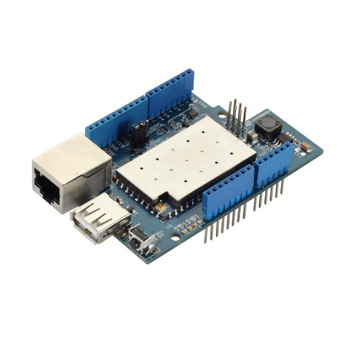

A Full View of YUN Shield

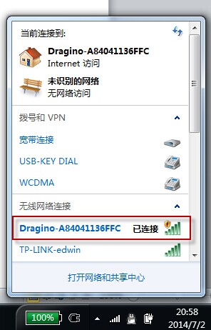

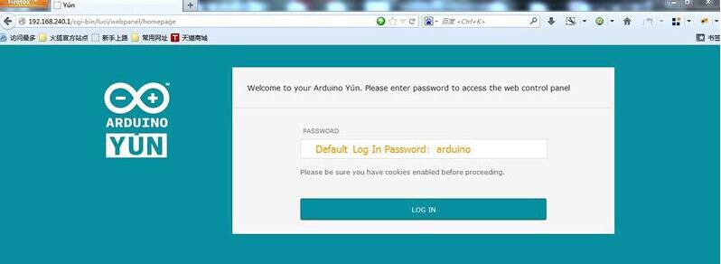

Connect to Yun Shield
At the first boot of Yun Shield, it will automatically generate an unsecure WiFi network call Dragino2-xxxxxx User can use their laptop to connect to this WiFi network. The laptop will get an IP 192.168.240.xxx and the Yun Shield has the default IP 192.168.240.1
Once user joins the network, they can use web browser (recommend Firefoxand Chrome) and enter 192.168.240.1 to enter the Yun Shield setting page.
Default Password for Yun Shield is dragino.

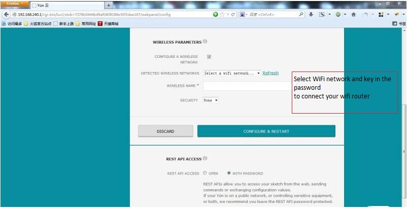

Set Up Yun Shield to access internet
After login,the GUI will show the WIFI / ETH interface status. Click the Configure button and now user can configure Yun Shield to access internet via your WiFi router.

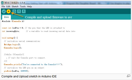

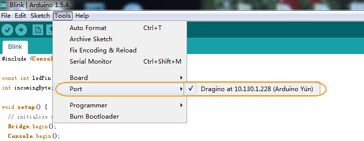

Upload Sketch
1) In the Arduino IDE, choose the Arduino Yun board type for Leonardo.
2) In Arduino IDE port, choose the correct port. (should be Arduino Yun port with an IP address)
3) In the Yun Shield GUI Sensor page, choose the Board Type: Leonardo.
4) Compile the sketch and upload it to the Arduino Board. During upload, The Yun Shield will ask you to key in the password, by default, the password is dragino.

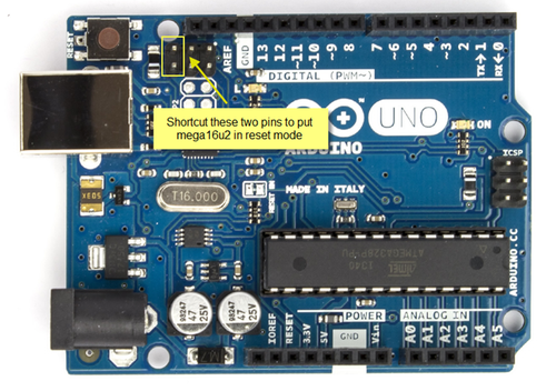

Connect to Arduino Uno
1)In UNO, the uart connection between mega328P and mega16u2 will influence the bridge feature with Yun Shield. So we have to disconnect it by set the mega16u2 into reset mode. As below:
Note: USB upgrade/debug won’t work after this change, User will have to upgrade sketch and debug via Arduino IDE via WiFi (see examples)

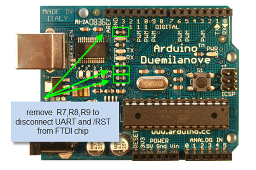

Connect to Arduino Duemilanove/Diecimila
1)In Duemilanove/Diecimila, the mega avr uart interface is connected to the FTDI chip, we have to disconnect them as shown in below picture:
2)Add a “Duemilanove Yun” board type in the file: Arduino\hardware\arduino\avr\board.txt. user can use the UnoYun board type if they has mega328p. for mega328/mega168/mega168p, they can modify the upload.maximum_data_size/ upload.maximum_size and build.mcu accordingly. 3)Put the Yun Shield on top of Duemilanove and power it via DC jack.

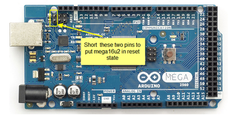

Connect to Arduino Mega2560
1)In Mega2560, the uart connection between mega2560 and mega16u2 will influence the bridge feature with Yun Shield. So we have to disconnect it by setting the mega16u2 into reset mode. As below:
2)Add a “Mega2560 Yun” board type in the file: Arduino\hardware\arduino\avr\board.txt. as below and reopen the Arduino IDE:

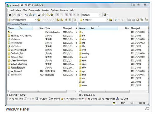

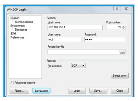

How to Upload, Download or Edit files in Yun Shield
Yun Shield has a built-in Linux system and support SCP protocol. User can upload, download or edit the Linux files using SCP tools. In windows OS, the scp tool is winscp. Install it and log into Yun Shield as below:
Host Name: Yun Shield IP address
User Name: root
Password: arduino (default)
Protocol: SCP
The login process will alter two warning, just ignore it. After login, a management panel will appear. The left part of this panel is your PC’s directories and the right part shows the directories of Yun Shield, you can upload/download files by dragging, or double click the files to modify its content.

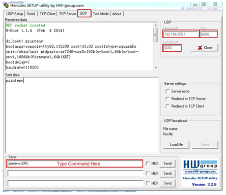

Download Hercules utility
Download Hercules, this is the tool we use to transfer commands to Yun Shield in Failsafe mode. Run Hercules and input correct parameters as below:
Protocol: UDP
Module IP: 192.168.255.1
Port: 6666
Local port: 6666

Press the Failsafe button and power up Yun Shield; user will see all the LEDs blink together, release the button after 10 seconds and there are some messages will pop up in the Hercules panel, which means the Yun Shield has been in Failsafe Netconsole mode and ready to access commands.
User can type the commands in Hercules to transfer and upgrade Yun Shield to the latest firmware with factory settings.
The update commands are as below, replace the xxx with the actually version.
Note when typing command in Hercules: user must add <CR>at the end of each command; $ is a special char in Hercules, user should double it (key two $$) when typing.

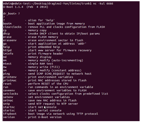

Recover in Linux is similar with Windows, the mail different is that the tool use in Linux is nc and runs with nc -kul 6666. Below shows that the Yun Shield has been in Failsafe Netconsole mode and detected by nc.

Arduino Bridge doesn't work
The Bridge use UART interface from AVR, in Arduino Board these trace are always connect to USB to UART chip for sketch upload. It will prevent the bridge to work as expected in most of time. We have the modification example for official or branded Arduino Board in this link: [Yun_Shield#Connects_to_Arduino_Boards|Connects_to_Arduino_Boards]. There are still lots of Arduino Variant boards using different hardware. The basic concept is to make the UART as clean as possible. we also provide some working around from our customers for reference as below:
Upload Sketch Fail
