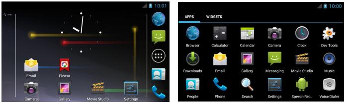

Experience the newest version Android 4.0.3:
Not only fully functional Android is provided to our customers, we also transplant Android 4.0.3 on Tiny210/mini210, Android 4.0.3’s image is located in “images /Android”, The steps of installing it is below.

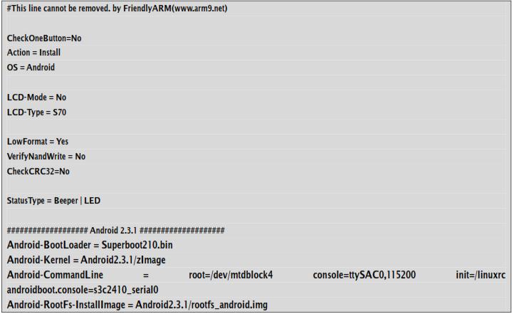

Step1
Plug your SD card in to your computer, open “images/FriendlyARM.ini”, Modify the content of the FriendlyARM.ini as below(default is that)
Note: If the LCD is connected to development board when installing system ,LCD parameters needn’t to be specified in FriendlyARM.ini because the Superboot will identify the LCD type automatically. If installing the system without LCD connected, LCD-Type parameters need to be specified, the supported LCD type includes H43,W50, A56, S70,A70, L80, G10.

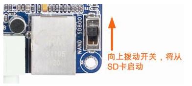

Plug the SD card into SD card slot, after that toggle the switch to SD boot and power on the board. Then the installing will start.
Step4

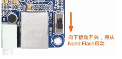

After the installing is completed ,the buzzer beeps and LCD displays that the installing is completed. Then toggle the switch S2 to “Nand Flash” boot. Then power on the board to boot the system.

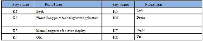

The 8 user keys is below and their definition in Android is below.

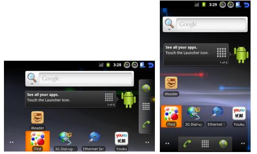

Display Inverting
Android2.3 is in landscape mode after booting, long pressing the Menu button will switch to portrait mode.
Installing Android4.0.3
Android4.0.3 is just for experiencing and test. Some function is not complete. Android 4.0.3’s image is located in images/Android, the steps of installing is same as Android2.3 except for the FriendlyARM.ini.

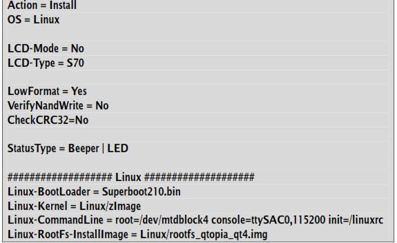

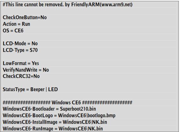

Step1

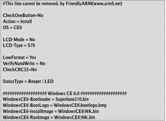

Step1

Step1
