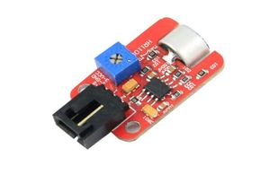

The Sound sensor module is a simple microphone based on a opamp LM358 to amplify the sound strength of the environment like door knocks and etc loud enough to be picked up by a microcontroller's Analog to Digital converter. The value of output can be adjusted by the potentiometer.

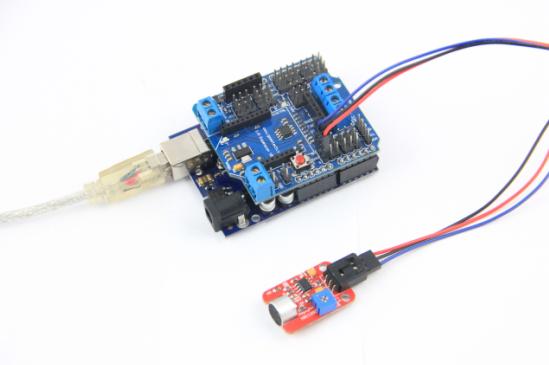

Here is the guide illustrates how to connect an Arduino to the sound sensor. The following is a table describing which pins on the Arduino should be connected to the pins on the sound sensor:
VCC <-------> VCC
GND <-------> GND
 S  <-------> Analog 0
