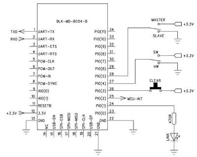

Application Circuit of Bluetooth module on-board
Master/slave mode setting and other configuration:
master/slave mode setting
The bluetooth module on-board supports setting the master/slave mode by soft or hardware. The method is as follows:
PIO(4)——soft/hardware setting: Low level(or impending) for hardware setting master-slave mode. High level(3.3V)for soft setting master-slave mode.
PIO(5)——master-slave mode setting interface by hardware. 3.3V high level for master mode, GND(or impending) for slave mode.

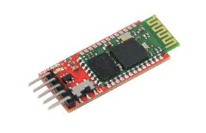

The PIO(4) on the serial bluetooth module has been connected to High level (3.3V) for hardware setting. So toggling the switch on the board to ‘M’ end set the module to the master mode, ‘S’ is for slave mode.

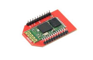

The PIO(4) on the Bluetooth Bee module is impening for software setting. Use the AT command AT+role for setting maste/slave mode.

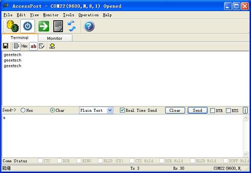

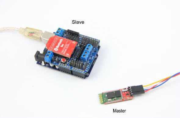

The Bluetooth module as the master is connected to a USB to ttl converter, the Bluetooth bee as the slave module is stacked on the Bee socket on the V5 expansion shield. The computer send a character ‘a’ via usb to ttl module . After the Arduino have received it via wireless serial communication, it will flash the led on-board and send back a string ‘geeetech’.
