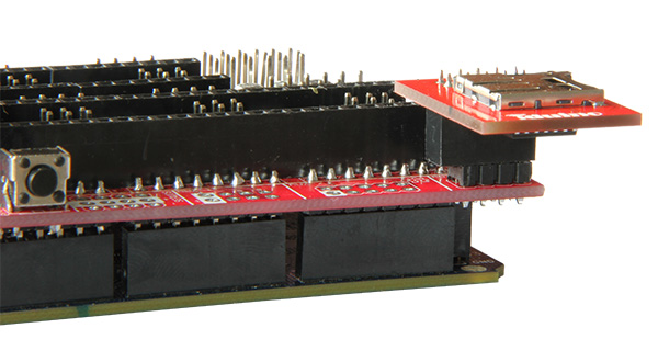

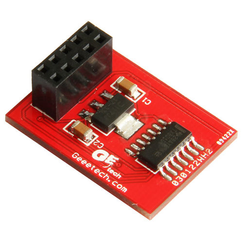

This RAMPS add-on enables you to print from MicroSD.With RAMPS 1.3 and higher it's easily connected to the RAMPS board.You will be able to print
without being connected to your PC.

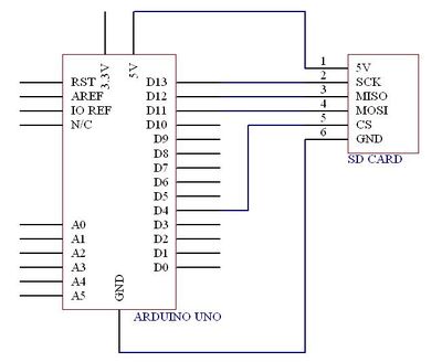

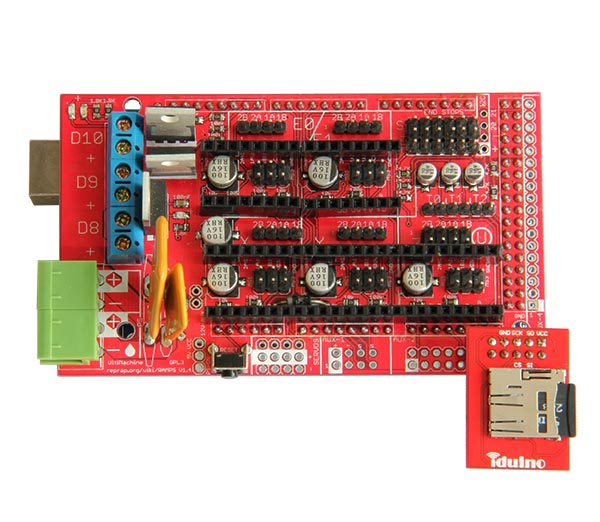

1. Connect your SD RAMPS like this to the RAMPS board:

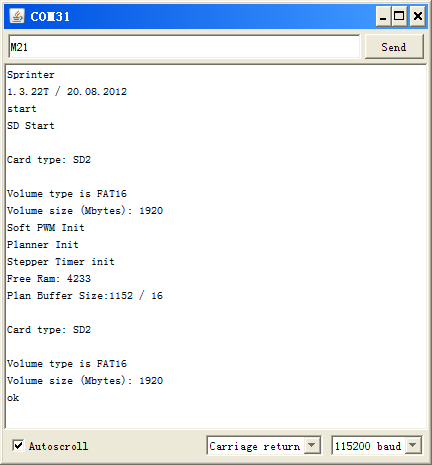

6. Open the Serial Monitor from the Arduino IDE. Make sure the left select list reads newline. Enter the GCode M21 (init SD Card). It should return ok.

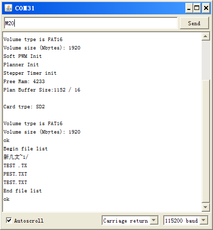

7. Enter the GCode M20 (list files). It should return the contents of the SD card.
