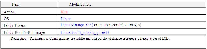

Run Linux in SD card
Step1: open the config file FriendlyARM.ini in images folder of SD card, modify the related definition item of Linux installation.
Step2:Set the switch S2 to “SDBOOT” side and insert the SD card and power on the development board.

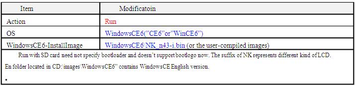

Run WindowsCE in SD card

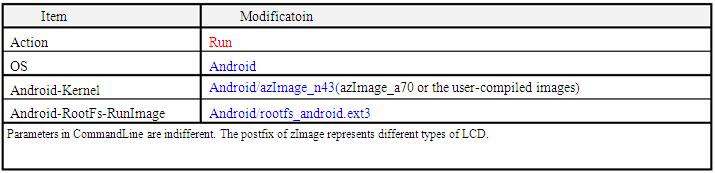

Run Android in SD card

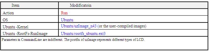

Run Ubuntu in SD card
