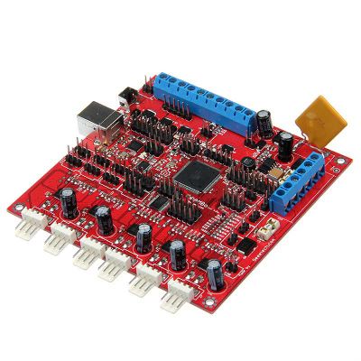

Introduction
Rambo(RepRap Arduino-compatible Mother Board)is a microcontroller board of 3D printer which integrates the stepper motor, hotbed, extruder, fan driver and thermometry in one. Rambo is completely compatible with Arduino in that it adapts the same IC, ATMEGA 2560, with Arduino mega2560. 3 additional resettable fuses are added to Rambo to protect it from over current. What’s more, the motor drive current can be controlled with code. The present popular LCDs that Rambo supports are smart controller 2004 and 12864.
Features:
1. Adopting the IC atmega2560 and atmega16u2 that are completely compatible with Arduino
2. 4 interface for thermometry.
3. All interfaces of 2560 and 16u2 are broken out for external use
4. 2 channel of sdramps that is compatible with SPI
5. 5 a4982 of 1/16 step size, 1 for X/Y axis respectively, 2 for Z axis, 2 for extruder.
6. Every control signal of stepper motor has a test point
7. The step size of stepper driver can be divided by firmware.
8. Reserved interface for LCD
9. 5 channel of PWM for extruder control
10. 3 power inputs source that is protected by resettable fuses: 12v 15a for hotbed; 12v 5a for extruder; 12v 5a for stepper motor.
11. PCB is composed of 4 layer of 35um copper sheet
Overview and Hardware Resources
RAMBo (RepRap Arduino-compatible Mother Board) is an all in one RAMPS class motherboard targeting convenience, reliability, and performance.Our version is 1.2a.
weight:80g

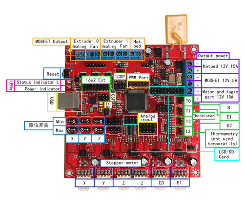

Interfaces
Interface Layout
Interface specifications
4 ADC interfaces (one for hotbed, 2 for extruder and one for thermometry)
5 PWM: 2 for extruder, 2 for fan control and 1 for heatbed
6 interfaces for end stop(X/Y/Z min, X/Y/Z max)which can be connected with mechanical or optical end stop, or hall sensor.

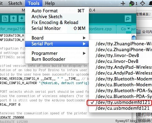

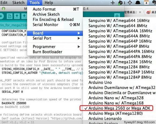

Software Setting Before uploading, driver should be installed for windows. Then choose the type of board: Tools > Board > Arduino Mega 2560 or Mega ADK. (Picture below)
Select the serial port: Tools > Serial Port, the serial port for Rambo is usually the last one.
Click to check if there is any mistake. If not, click
to upload.
During the process of uploading, the 3 LEDs corresponding to TX, RX and L on mega board will blink, if the blink stops, the uploading is done.
After the uploading, you can go on with the next step. If the uploading is unsuccessful, read the error report on IDE, figure out the problem, and then try again. Some frequent errors are: a wrong select of board type and serial port.

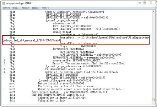

3. What should I do if the driver installation failed?
You may encounter a problem “system cannot find the specific folder” in the process of driver installation when you use starter edition windows, because the starter edition of windows system has deleted some uncommon information for driver. The resolutions are as follows,
A: open C:\windows\inf\setupapi.dev.log
The file not only includes plug and play device, information for driver installation, but also record the reason of the failure of driver installation. Open this file and move to the end of the file you will observe the following information.
It is just the file error that causes the failure of Arduino driver installation.
B: creating a folder” mdmcpq.inf_x86_neutral_******** “in the path of
"C:\Windows\System32\DriverStore\FileRepository\ "
The identifications of all computers are different, so please refer to the prompt box from the “setupapi.dev.log” to know the “******* “. For example, information provided by my computer is
“C:\Windows\System32\DriverStore\FileRepository\mdmcpq.inf_x86_neutral_9f203c20b6f0dabd “
According to this prompt, I created another folder with the same name in the path of “C:\Windows\System32\DriverStore\FileRepository\”, as follows,
C: Download and decompress the following file and add it to the created folder mdmcpq.inf_x86_neutral_********.
32bits windows:
mdmcpq.inf_x86.rar Media:(http://www.arduino.cn/forum.php?mod=attachment&aid=MTIzMHw2ZjJkZDY1OXwxNDA0NzAyMDgxfDY0MDF8MjQ4NQ==)
64bits windows
mdmcpq.inf_amd64.rar [[Media:(http://www.arduino.cn/forum.php?mod=attachment&aid=MTIzMXxkN2QxMzdiMHwxNDA0NzAyMDgxfDY0MDF8MjQ4NQ%3D%3D) ]]
D. Reinstall driver step-by-step.
At this point, driver can be installed.
