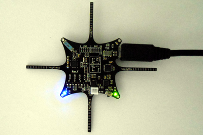

Before you go ahead and assemble the Crazyflie check the Crazyflie control board and the Crazyradio electronics, Attach a powered micro-USB cable to the Crazyflie control board. It should power up and blink 5 times with the green LED. After that the green LED should be fully on and the red LED should blink.
1.Check the PCB The blue led and Green led will light when you connected it to usb port.
