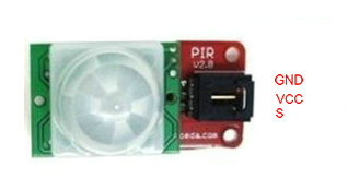

Technical parameters
  • Operating voltage: DC5V
  • Static power consumption: 65 microamps
  • level output: high-5V, low-0V
  • Delay Time: adjustable (0.3 seconds to 18 seconds)
  • embargo time: 0.2 seconds
  • sensing range: less than 120 degrees angle, 7 meters
  • Operating temperature: -15 ~ +70 degrees

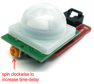

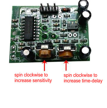

When motion is sensed, pin S output 5V. There is a yelow knob on the back for adjusting the output pulse duration.Spinning clockwise increase the the output pulse duration. Spinning anticlockwise decrease the output pulse duration. To make the following test more explicit ,you need to spin the knob anticlockwise to the end to decrease the ouput duration.
The sensor module can't get to work immediately when it's energized. It starts to work about 15 seconds later after energized.

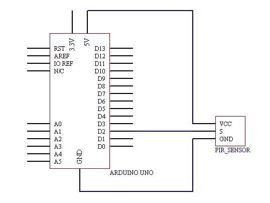

Example code
int pirPin = 2; //digital 2
void setup(){
pinMode(pirPin, INPUT);
pinMode(13, INPUT);
void loop(){
int pirVal = digitalRead(pirPin);
if(pirVal == HIGH)
{ //was motion detected
digitalWrite(13,HIGH);
delay(50);
else {
digitalWrite(13,LOW);
