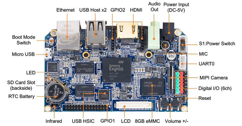

Nano PC Board
The Nano PC standard version integrates 1G DDR3 RAM and 4G eMMC flash memory.
Nano PC Hardware Feature
  • CPU
** Samsung Quad-Core Exynos 4412, based on Cortex-A9, 1.5GHz.
** Integrated ARM Mali-400 Dual-Core GPU.
** Elegent 2D/3D graphic accelaration.
** Up to 1080p@30fps hard decoded video playing, support MPEG4, H.263, H.264 etc.
** Up to 1080p@30fps hard decoded (Mpeg-2/VC1) video input.
  • DDR3 RAM
** 1G.
** 32bit data bus, single channels.
** 400 M Hz.
  • FLASH
** eMMC Flash: 8GB.
  • LCD
** LCD interface : 41Pin, 0.5mm spacing, compatible with Mini2440/Tiny4412/Mini210S LCD, supports one wire precise touching.
** HDMI high definition interface (1.4A).
** LCDs supported from 3.5” to 12.1” , HD.
  • Network
** 10/100M Ethernet interface(RJ45) using DM9621.
  • Standard Configuration
** 1 x microUSB Slave-2.0.
** 1 x 3.5mm stereotype audio output.
** 2 x USB Host 2.0.
** 1 x 5V power input.
  • On Board Hardware Resource
** 1 x backup battery for on board real time clock.
** 2 x LED.
** 2 x User button.
** 1 x Reset button.
** 1 x On-board microphone.
** 1 x Infrared receiver.
  • External Resource
** 1 x TTL.
** 2 x GPIO.
** 1 x MIPI camera interface.
** 1 x Digital sensor.
  • Power
** 5V.
  • PCB Dimension
** Eight layered board.
** Dimension: 100 x 60 (mm).
  • OS
** Android 4.0/4.2.
** Ubuntu-1204.
** Linux + Qt/Embedded-4.8.5.

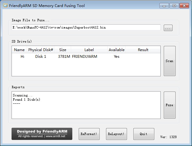

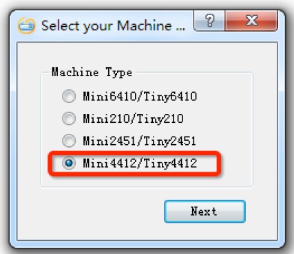

Step1: launch the SD-Flasher.exe in your shipped CD (under “\tools\”). Note: this program should be run as “administrator”.
When the utility is launched a message box will pop up “Select your Machine”, please select “Mini4412/Tiny4412”:
Below is the dialog you will see after it is started. Note: the “ReLayout” is enabled and we will format the SD card with this function.
Step2: click onto select your bootloader file

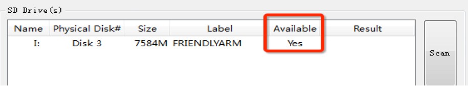

Step3: insert a FAT32 SD card into your host’s SD card socket (you can also use a USB card reader to connect to a PC), backup your data in the card and click on “Scan”, all recognized SD cards will be listed.

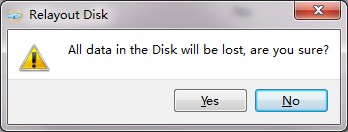

Step4: click on “ReLayout”, the following dialog will pop up prompting you that the data in your card will be lost. Just click on “Yes”
After formatting is done you will be directed back to the main menu. Click on “Scan”, you will see that a “FriendlyARM” section available.
Step5: click on “Fuse”, Superboot will be safely burned into the SD card. You can burn this card in WindowsXP without worrying about its FAT32 data being lost or damaged.

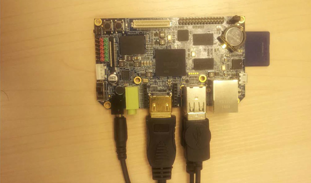

After you make an SD card by following the above steps you can run it on the NanoPC
Step 1: connect the Nano to a TV via an HDMI cable
Step 2: connect a USB mouse and keyboard

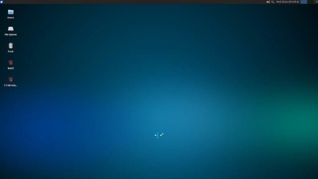

Step 3: switch S2 to “SD” and power on. If everything is set correctly you will see the following screenshot

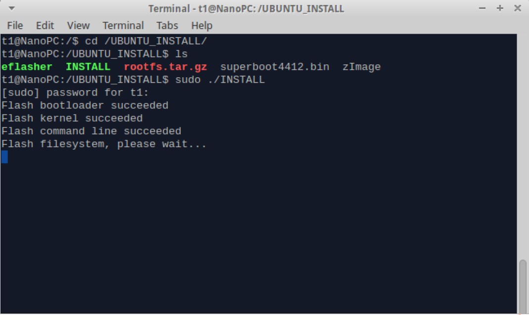

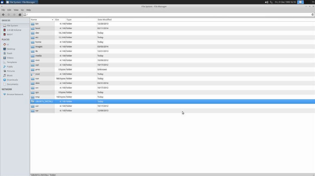

Step 2: enter the root directory of the ubuntu system and you will find a “UBUNTU_INSTALL” directory. Enter this directory
Step 3: you will find these files “superboot4412.bin”, “zImage”, “rootfs.tar.gz”, “INSTALL” and “eflasher”
Step 4: please run “sudo ./INSTALL”. The password is “123456”.
The installation takes about 10 minutes. After it is done restart the Nano from “NAND” you will see ubuntu loading.
