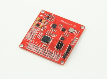

The Multiwii flight control board is multicopter flight controller board that use Multiwii. MultiWii is a open source software based on Arduino to control a multirotor RC model. After years of joint efforts of many enthusiasts, and now the MultiWii program has become increasingly mature, has become very popular abroad, cost-effective flight control one.
MultiWii SE/Lite above the mainstream hardware platform with a combination of commonly used, which is equivalent to Arduino Pro Mini and 10DOF IMU sensor combined, integrated design makes working more stable flight control. You can use FTDI Basic for easy programming.
Hardware Specification
MultiWii SE Hardware configuration:
  • ATMEGA328P microcontroller
  • ITG3205 3-axis gyroscope
  • BMA180 3-axis accelerometer
  • BMP085 pressure sensor
  • HMC5883L 3-axis Magnetometer

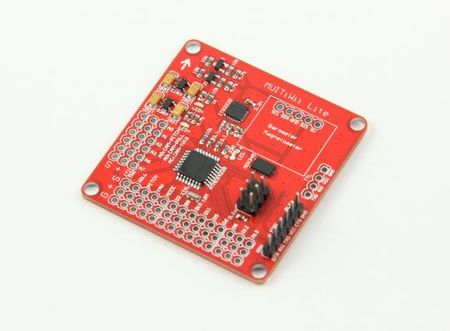

MultiWii Lite Hardware configuration:
  • ADXL345 3-axis accelerometer

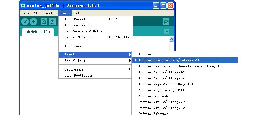

4. Set Board type to

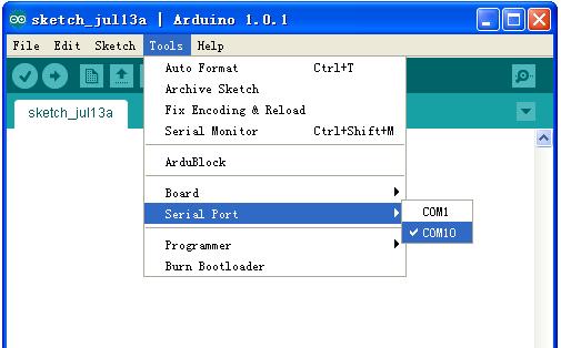

5. Set Com port to the one the FTDI is on

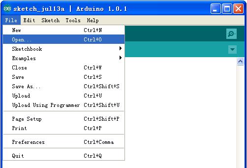

6. Open the MultiWii source code

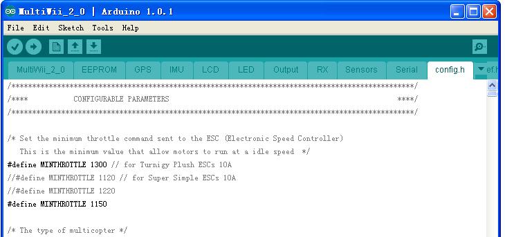

7 Select the config.h tab and uncomment (remove “//”) the parameters as below, be sure to comment (“//”) the unused ones in each group
a. Select the Min throttle for your ESCs..this is the lowest value the controller sends to any motor during flight…you want them still spinning at this value or you run out of control.

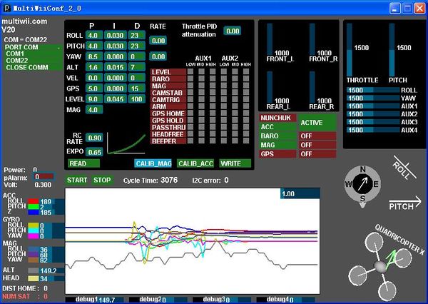

GUI configuration
The GUI is a java program that can run on any PC windows/linux/mac computer.The Multiwii board must be connected via an USB cable to the computer to use it.Alternatively, it is possible to use a wireless transmission via bluetooth as data are transported over a simple serial port.
GUI launch procedure
  1. You must connect the Multiwii board to your PC via the USB connection and upload the multiwii source code to your board(the same used to inject the software via Arduino IDE)
  2. Once it’s done, you can launch the GUI, and then select the good PORT COM (the same used by arduino IDE).
  3. Once it’s done, you have to wait some seconds to let the arduino boot and run the soft. (wait for the LED blink)
  4. once the status led is OK (it should blink ans stays off), you can press the START button to see the evolution of values.
  5. you must READ the current parameters in the Arduino before configuring it. Default values are set at the beginning.The default values can be reset by uploading an old version and then the last version.

Sensor detection/usage
On this screen, the left column resumes the detection of sensors.
The right column precises if the sensor is currently use or not (depending on the checked options)

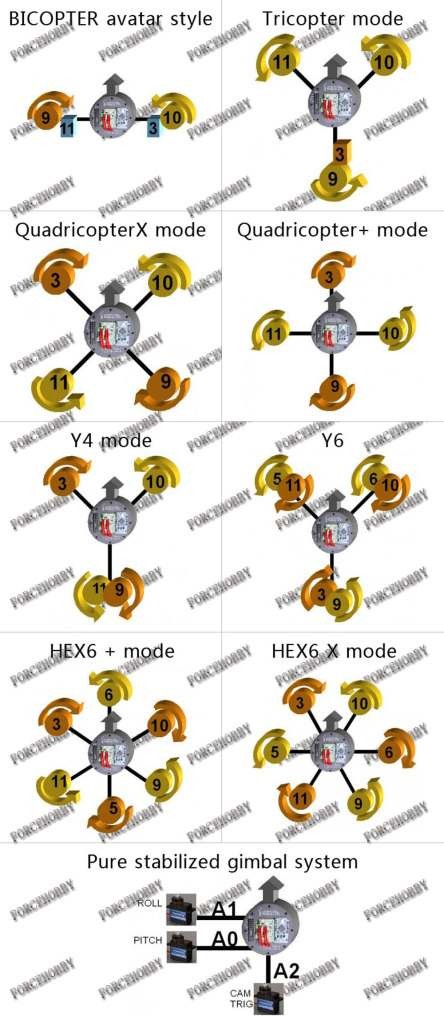

Motor connections and rotations are shown below
Numbers refer to pins D3,9,10,11,5,and D6 above…the Motor1-6 ESC outputs.
