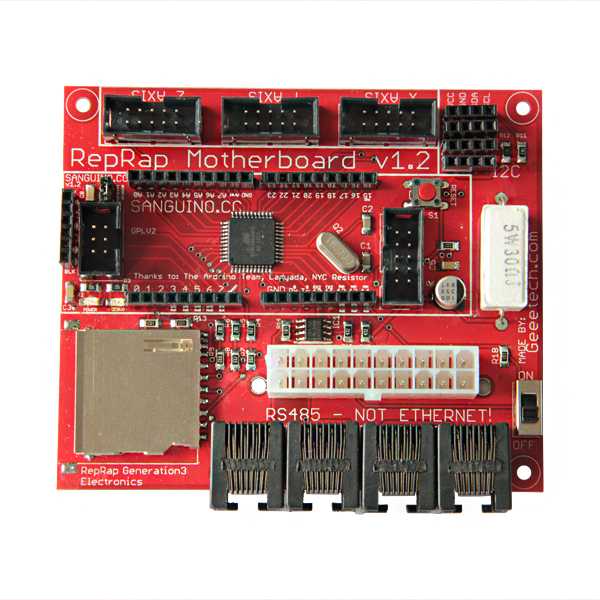

The top picture shows the board configured forfor use in a Cupcake[1]. The few differences are described in the appropriate sections below.
This board is the brains behind the Generation 3 Electronics. The heart is a Sanguino which is an Arduino-compatible board that is powered by an ATMEGA1284P chip. It has connectors to hook up all the various peripherals that you'll need to drive a RepRap machine. It has headers for three stepper drivers, as well as 4 RJ45 connectors for Extruder Controller Boards. Not only that, but it has an SD card and a connector to hook it up to an ATX power supply
Some highlights:
  • Onboard ATMEGA1284P - 64K flash space, 4k ram, 32 I/O pins, Arduino compatible.
  • 3 x Stepper driver connectors with min/max inputs.
  • Built-in SD card socket for printing from file and buffering large print jobs.
  • RS485 connection for noise-free communications with extruder / toolhead controllers.
  • ATX power connector for power. It can also turn the power supply on and off.
  • Headers to allow existing Sanguinos to plug straight in.
  • I2C headers for simple hookup of external peripherals.
  • On/Off switch for instant-kill and simple control of the entire system.
