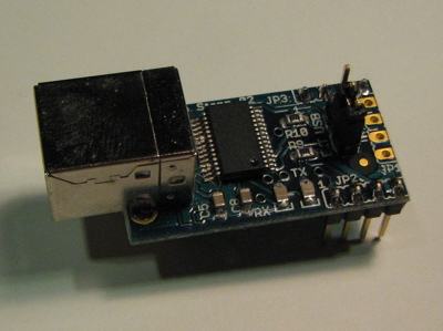

Mini USB/Serial Adapter
This board converts a USB connection into 5 volt TX and RX that you can connect straight to the Arduino Mini or other microcontrollers, allowing them to talk to the computer. It is based on the FT232RL chip from FTDI (drivers are included with the Arduino software).

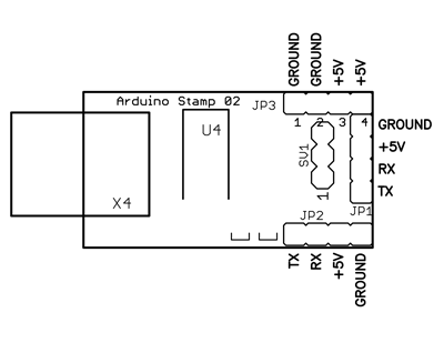

Pinout of the original Mini USB Adapter

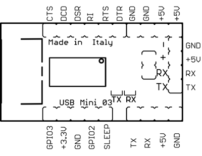

Pinout of the revised Mini USB Adapter
