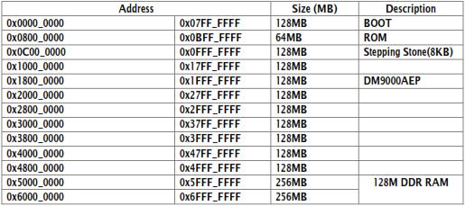

Address Space
The following data is from the S3C6410 data sheet

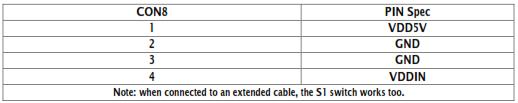

The Mini6410 is powered by an external 5V power supply. It has two power inlets: CN1 is for 5V power adapter and the white CON8 is a 4 pin socket used to connect an external power supply when the board is embedded in a closed box. The voltage is 5V and current is 800mA.

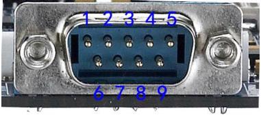

Serial Port
S3C6410 has 4 serial ports: UART0, 1, 2 and 3. UART0 and 1 are 5 wire serial ports and the other two are 3 wire serial ports. On this board, UART0 is converted via RS232 to COM0 and can communicate with a PC via a serial port cable. The rest 4 ports are connected to CPU via CON1-4. They are presented as below:

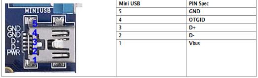

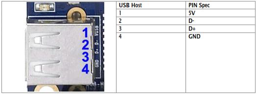

USB Interface
The Mini6410 board has two USB interfaces. One is a USB host 1.1 which is the same as a USB interface on a PC and can connect to a USB camera, keyboard, mouse, flash drive and other USB devices. The other is an OTG mini USB 2.0 which is usually used to download programs to a target board. When the board runs WinCE it can synchronize with a Windows via ActiveSync. For Linux there are no programs for synchronization for now.
Mini USB interface:
USB Host:

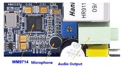

Audio Interface
The S3C6410 supports I2S/PCM/AC97. The Mini6410 has an AC97 interface which uses WM9714 as the CODEC chip.
The audio output is a 3.5 mm spaced green plug and the input is an on-board microphone. To get better audio quality please move the microphone as close as possible to the audio source when recording.

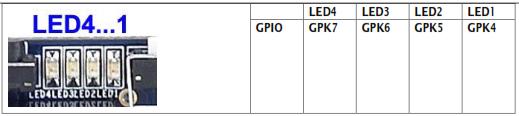

LED
A LED is commonly used as a status indicator. The Mini6410 has 4 user programmable LEDs which are directly connected to GPIO. The LEDs will be on at a low level voltage. Detailed information is as follows

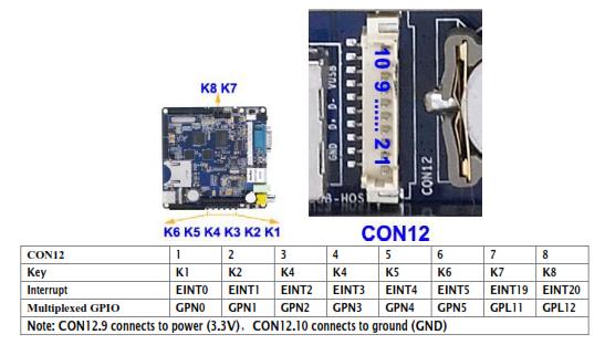

User Key
The Mini6410 has 8 test keys. They all are CPU interrupt input signals and will be triggered at a low level voltage. They can also be multiplexed to GPIO and other function interfaces. To multiplex them users can extend them through CON12. These 8 keys and CON12 are defined as follows

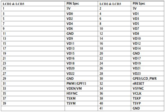

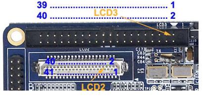

Double LCD Interface
For users’ convenience we incorporate two LCD interfaces on the board: LCD2 and LCD3. LCD2 is a 0.5mm spaced 41 pin connector and compatible with Mini2440 LCD; LCD3 is a 2.0mm spaced 40 pin connector. Since LCD2.41 is grounded LCD3 can still work although it lacks one pin.
The LCD connector has most of the commonly used control signals (line sweeping, clock, enable/disable) and complete RGB data signals (RGB output is 8:8:8 and can support LCDs up to 1.6M pixels). It has a PWM output and a reset signal (nRESET). LCD_PWR is the backlight switch signal.
37, 38, 39 and 40 are a 4 wire touch screen interface which can be directly connected to a 4 wire resistor touch screen.

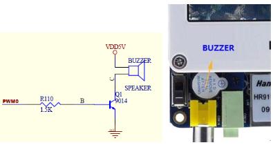

PWM Buzzer
The on-board SPEAKER is controlled by PWM, the diagram is shown below. PWM0 corresponds to GPF14 which can be configured as PWM output via software or used as a GPIO.

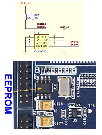

I2C-EEPROM
The Mini6410 has an EEPROM AT24C08 connected to CPU’s I2C. It has 256 bytes memory and is mainly for testing I2C bus.

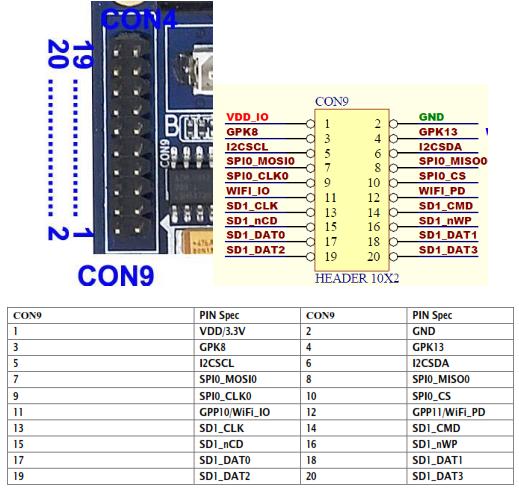

SDIO-II//SD-WiFi
The other SDIO of the S3C6410 is extended via CON9. It is a 2.0 mm spaced 20 pin connector and includes an SPI, an I2C and 4 GPIOs.

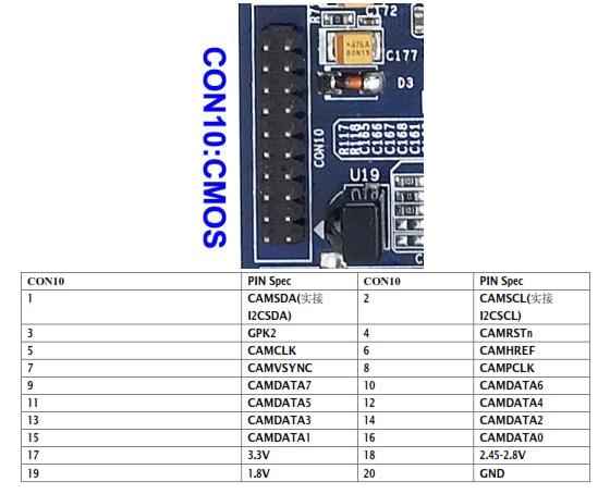

CMOS Camera Interface
The S3C6410 has a CMOS camera interface. It is extended via CON10. It is a 20 pin 2.0mm connector, users can directly use the CAM130 module we provide. The CAM130 module does not have any circuits. It is basically just a converter and directly connects to a ZT130G2 camera module.
Notes: the camera interface is a multiplexed port. It can be used as GPIO by setting corresponding registers. The schematic below presents its pin details.

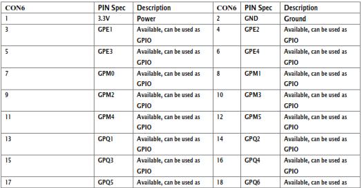

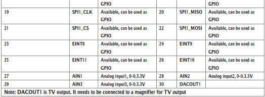

GPIO
GPIO is the abbreviated form of General Purpose Input Output. The Mini6410 has a 30 Pin 2.0mm spaced GPIO interface, i.e. CON6. In fact, CON6 has not only quite a few GPIO pins but also some CPU pins such as AD input, DAC and so on. The SPI interface, I2C interface, interrupts and some others are all GPIOs, but they are marked as special function interfaces. They can be configured for other purposes too by setting related CPU registers.

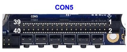

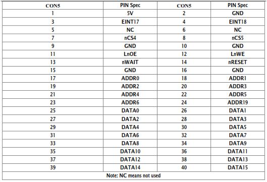

System Bus
The system bus is CON5. It contains 16 data lines (D0-D15), 8 address lines (A0-A6, A24), and some control signal lines (such as chip select, read/write, reset and so on). CON5 can supply 5V output. In fact very few users would extend interfaces through system bus. Below is the detailed information about CON5’s pins
