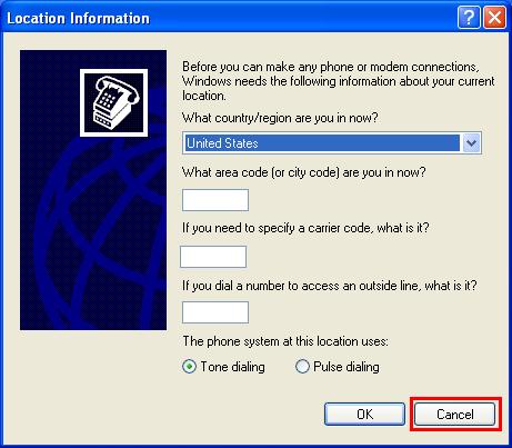

Here we focus on the HyperTerminal included with Windows XP. HyperTerminal is usually located in “Start>Programs>Accessories>Communications”. Run this application, then the following dialog box appears, click “Cancel”.

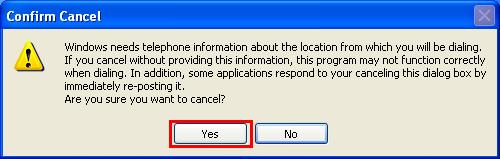

Next click “Yes” in the popup window.

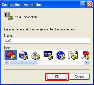

HyperTerminal will ask you to name the new connection and we name it “ttys0”, Windows XP prohibit you from naming it “COM1” or similar due to the name has been occupied by system.

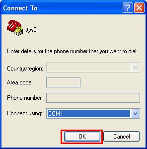

After that another dialog box pop up again, you need to specify the serial port of the development board and we specify “COM1” as shown.

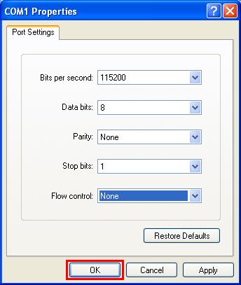

Finally, the most important thing is to set serial port. Note that the Flow control must be specified as none, or you will see the data output and no data input. The serial baud rate must set at 115200.

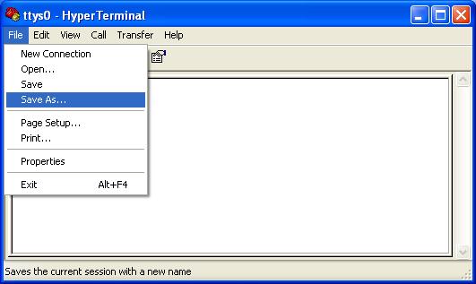

After all setting is complete, switch on the power supply and the HyperTerminal shows the vivi startup, then select ”File>Save as” in HyperTerminal to save the connection settings so as to use it next time.
