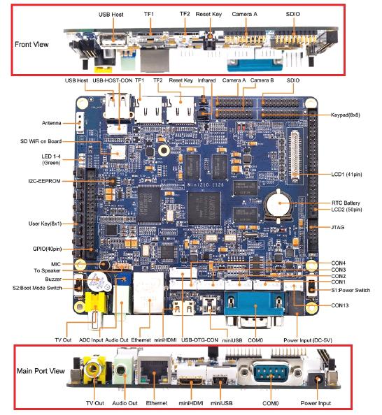

Mini210 Hardware Specification
Hardwarew Specification
This section provides a definition of the pin-outs and cables to be used with all of the connectors and headers on the board.

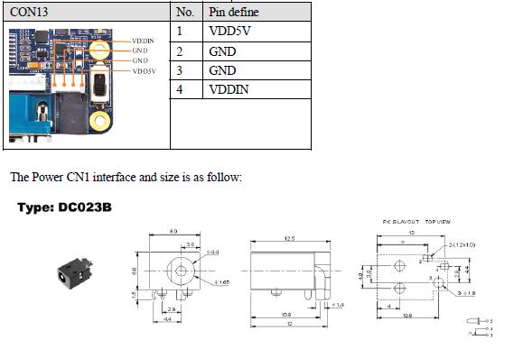

Power
The Mini210 is powered by an external 5V power supply. It has two power inlets: CN1 is for 5V power adapter and the white CON13 is a 4 pin socket used to connect an external power supply when the board is embedded in a closed box.

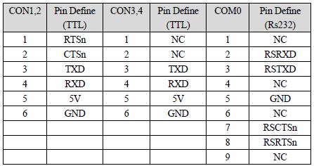

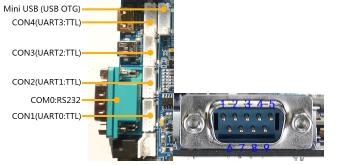

Serial Port
S5PV210 has 4 serial ports: UART0, 1, 2 and 3. UART0 and 1 are 5 wire serial ports and the other two are 3 wire serial ports. On this board, UART0 is converted via RS232 to COM0 and can communicate with a PC via a serial port cable. The rest 4 ports are connected to CPU via CON1-4. They are presented as below:

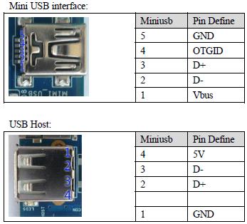

USB interface
The Mini210 board has two USB interfaces. One is a USB host 2.0 which is the same as a USB interface on a PC and can connect to a USB camera, keyboard, mouse, flash drive and other USB devices. The other is an OTG mini USB 2.0 which is usually used to download programs to a target board. When the board runs Android it can use for ADB debug function.

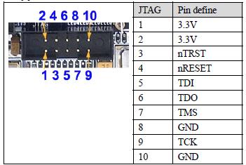

JTAG
When a board just comes off from production lines it is just a bare board without any data and we usually have to burn the first program to it through the JTAG interface. However since the S5PV210 supports booting from SD card the JTAG is not significant to users any more. Now the JTAG is more often used for debugging. In fact, most of the widely used utilities in markets like JLINK, ULINK and other simulators actually work via the JTAG interface. A standard JTAG has 4 signals :TMS, TCK, TDI and TDO which are test mode select input, test clock, test data input and test data output. These 4 signal lines plus a power line and a ground line form 6 lines in total. In order for testing, most simulators even have a reset signal. Therefore, a standard JTAG is meant to have those signal lines, and it does not mean whether it is 20Pin or 10Pin. As long as a JTAG interface has those signal lines, it will be a standard JTAG interface. The Mini6410 has a 10Pin JTAG interface which has complete standard JTAG signals. Notes: for beginners who just want to focus on Linux or WinCE development, the JTAG interface has no significance because most development boards already have a complete BSP which includes commonly needed serial ports, network port and USB port. When a board runs with Linux or WinCE installed, users can fully utilize more convenient functions and utilities provided by the operating system to debug. They do not need a JTAG. Even if you can trace your programs it will be extremely tough to step debug because it will go into the operating system. This is not an easy job.

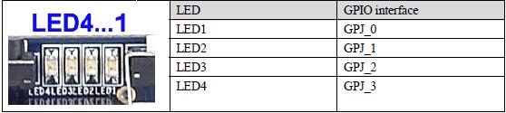

LED
A LED is commonly used as a status indicator. The Mini210 has 4 user programmable LEDs which are directly connected to GPIO. The LEDs will be on at a low level voltage. Detailed information is as follows:

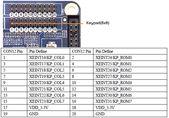

Matrix keyboard
S5PV210 have a 8x8 matrix keyboard, the development board has expended all the keys with CON12 interface, as shown below:
Notice:
  1. CON12 is the IDC 2.0mm interface, total 20Pin
  2. XINT16/KP_COL0 said pin change interrupt signal can be multiplexed with XEINT16,
meaning similar to the other pin.

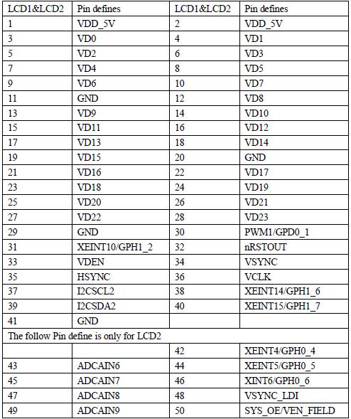

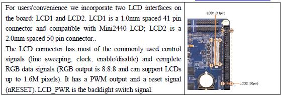

LCD interface
Notice: Because the use of 1-wired touchscreen, LCD1 does not include four-wire resistive touch pin from CPU, but the addition of I2C and interrupt pins (see LCD1-37,, 38,39,40), this is designed to will be able to use capacitive touch screen. LCD2 will include a more extensive CPU pins, or detail table below the schematic.

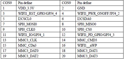

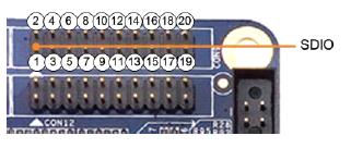

SDIO-II/SD-WiFi interface
The SDIO4 of the S2PV210 is extended via CON9. It is a 2.0 mm spaced 20 pin connector and includes an SPI, an I2C and 4 GPIOs.

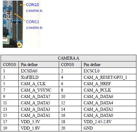

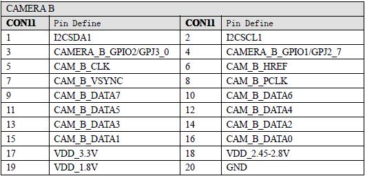

CMOS camera interface
The S3C6410 has two CMOS camera interface. It is extended via CON10(CAMERA A) and CON11(CAMERA B). It is a 20 pin 2.0mm connector, users can directly use the CAM130 module we provide. The CAM130 module does not have any circuits. It is basically just a converter and directly connects to a ZT130G2 camera module.
Notes: the camera interface is a multiplexed port. It can be used as GPIO by setting corresponding registers. The schematic below presents its pin details.

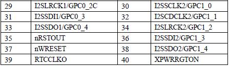

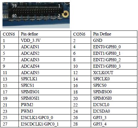

GPIO interface
GPIO is the abbreviated form of General Purpose Input Output. The Mini210 has a 40 Pin 2.0mm spaced GPIO interface, i.e. CON6.
In fact, CON6 has not only quite a few GPIO pins but also some CPU pins such as AD input, DAC and so on. The SPI interface, I2C interface, interrupts and some others are all GPIOs, but they are marked as special function interfaces. They can be configured for other purposes too by setting related CPU registers.
